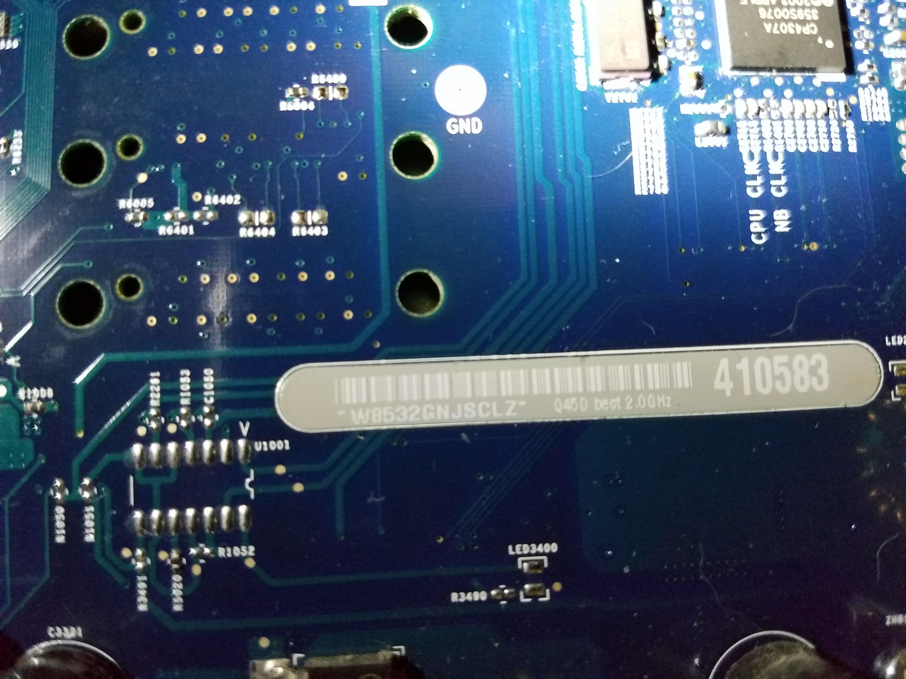

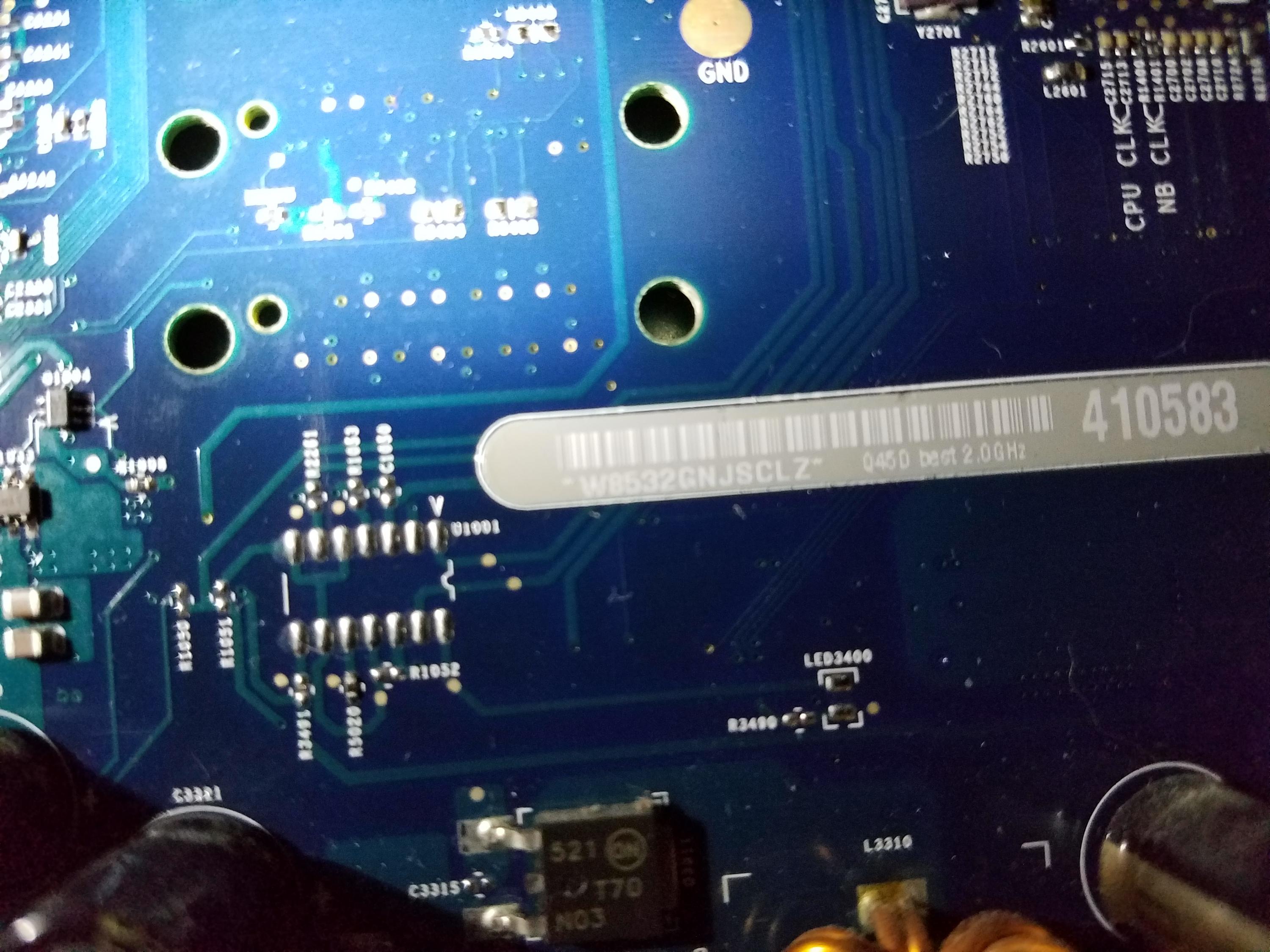

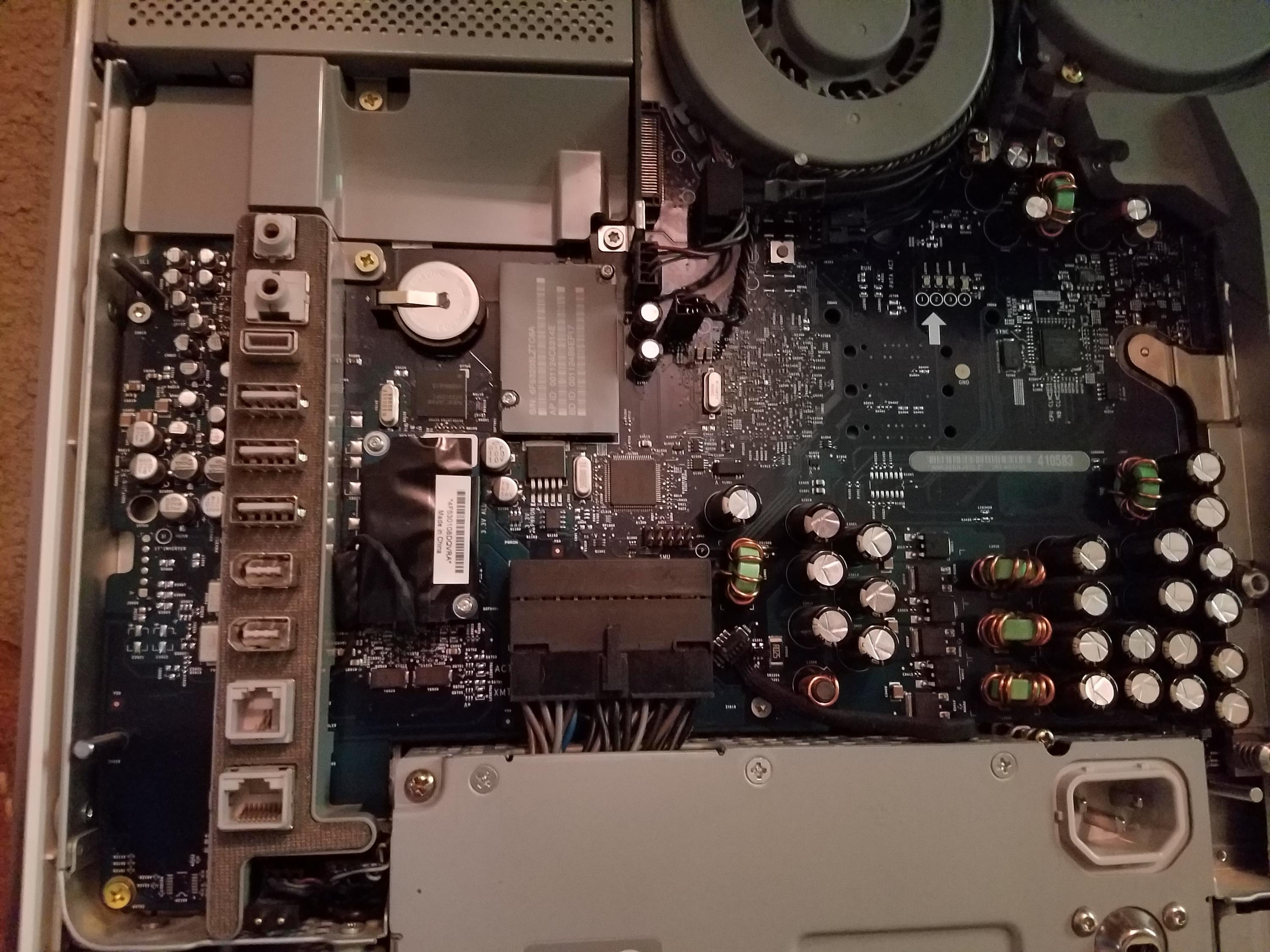

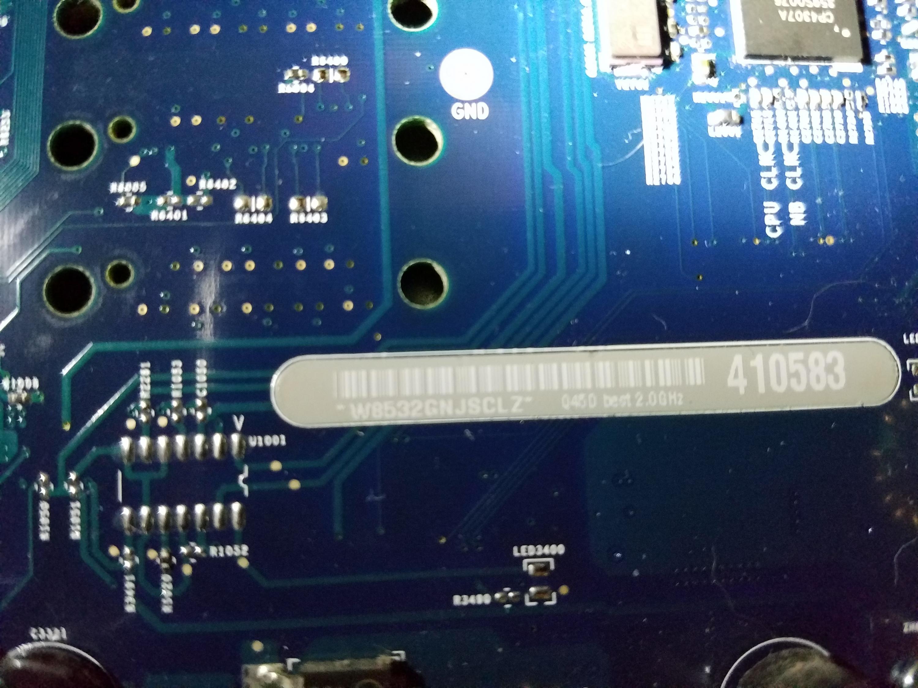

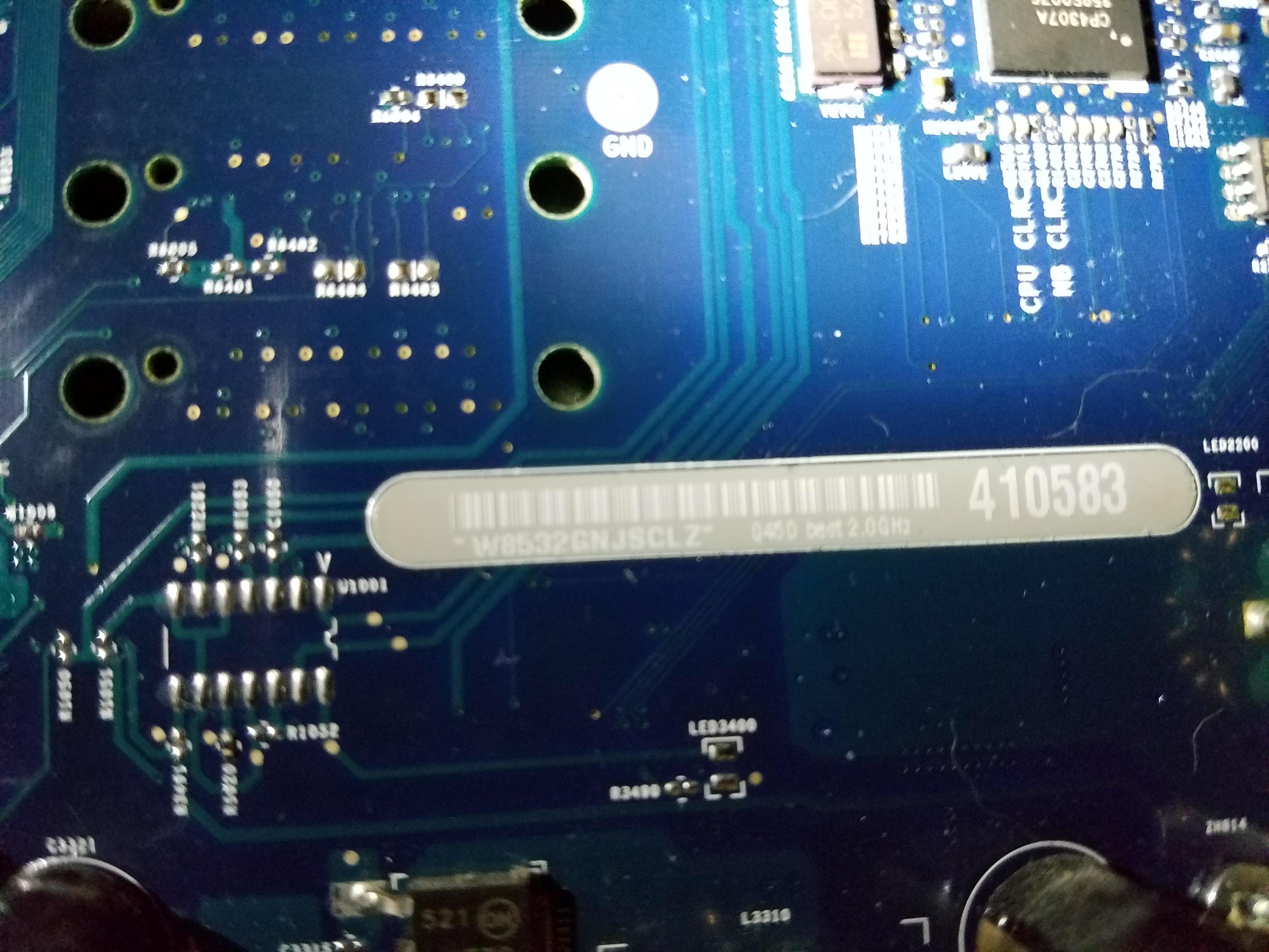

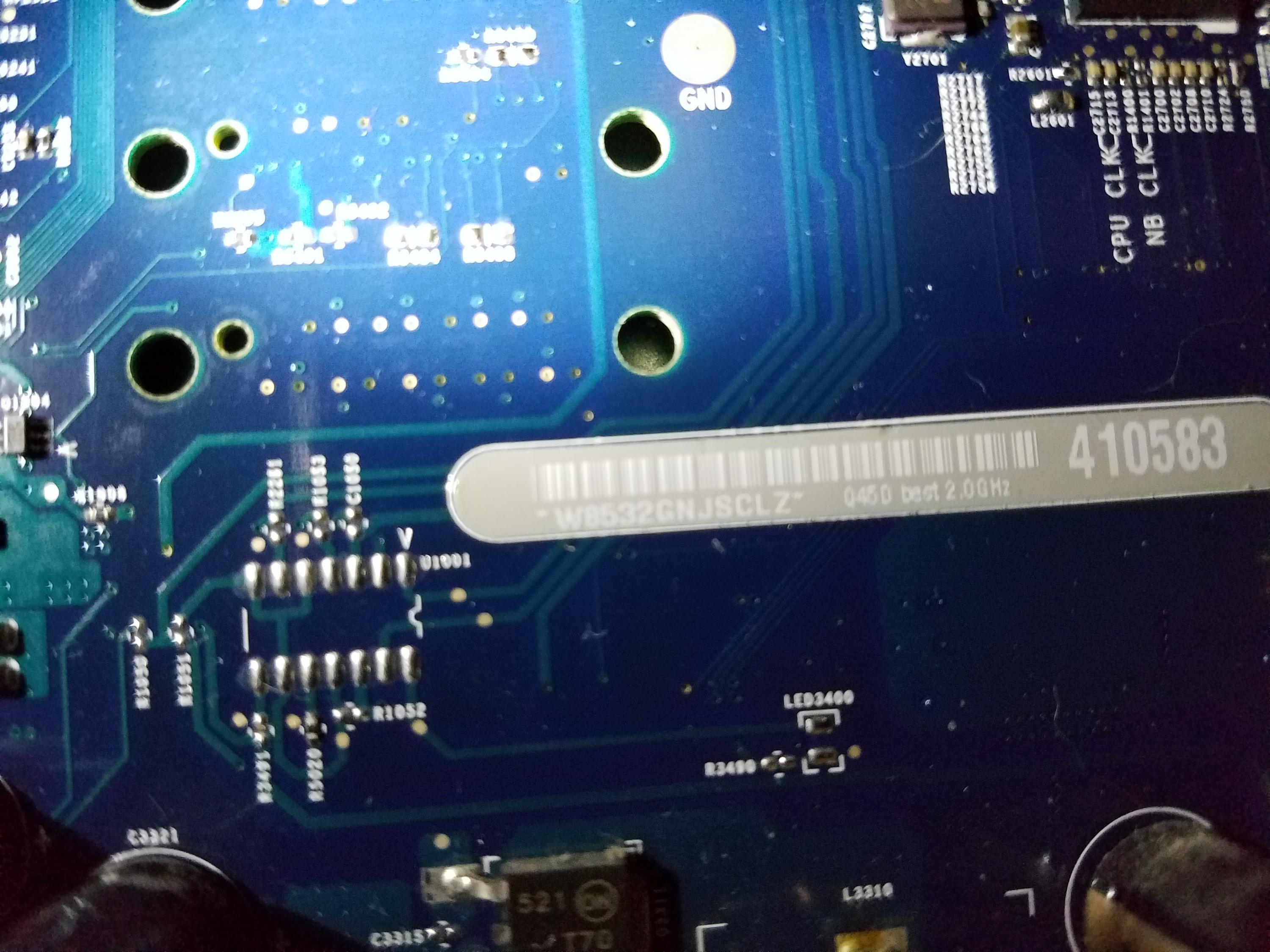

                            I took a bunch of pictures of the motherboard:

                                • 31278
                                #35
                                Re: Reinstalling an upgraded iMac
                                Originally posted by Spork Schivago
                                Okay, so I was cloning the drive and I see this:
                                Code:
                                dd if=/dev/sdd of=./Sandy.sdd.img
                                so your cloning the drive "d" (4th drive??) to the directory behind the one your working in???
                                that looks a bit wrong.

                                          Yup, definitely a PPC G5. 2gb max. Let me know if you're still having trouble getting the media, I have 10.5 I could send snail mail....with my slow DSL, i'm not even about to try uploading it to the BCN server.
