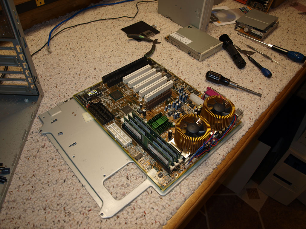

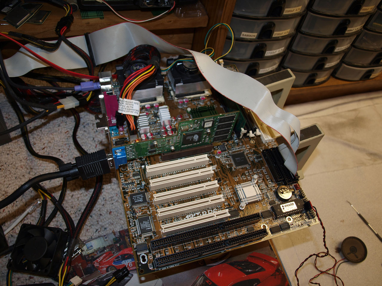

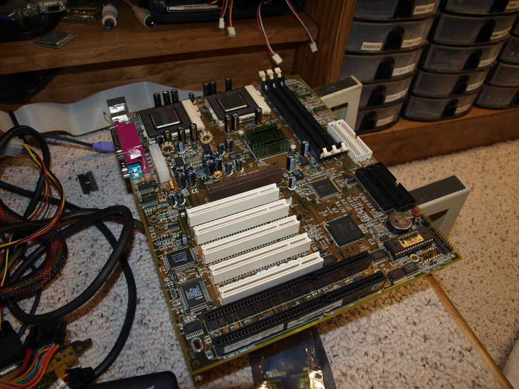

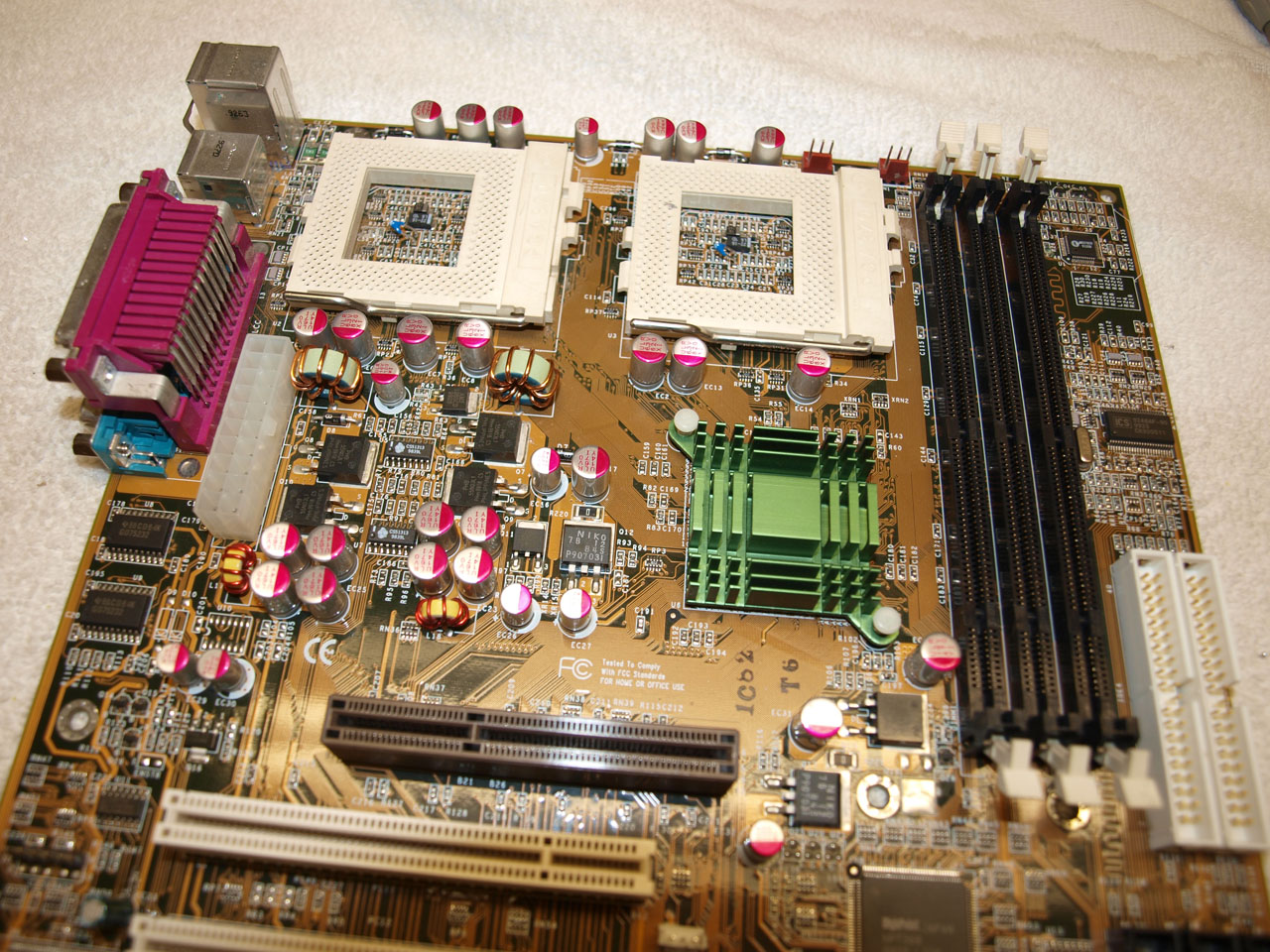

    I've begun the ground work for yet another classic retrobox, the legendary Abit BP6! I bought this off ebay, seller claiming there was a pair of 300A's in it....well, they turned out to be 366's... I didn't discover this until I completely recapped the board, so sending it back for a refund is out... I'll either get a partial refund and leave positive feedback, or get nothing back, and he'll get a ripe one... I do happen to have a pair of 300A's from another deal though, so the project moves forward, but leaves another build in the lurch... I didn't pay much for this, so I'm not going to get too excited....but I really wanted the second set of 300A's, as they're very hard to find in a PPGA370 package, most were slot-1. It came with 768mb RAM (most supported by the board) a pair of Thermaltake 'golden orb' coolers, a NIC, and a SB Live sound card.
    Anyway, fully recapped, including all the small ones!!
    Thats all for today...after taking these pics, I hotwashed & air blasted the board after testing it...so I'll let sit overnight and get it set in a case tomorrow.

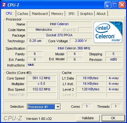

          I tested the 366 processors @ 550 this morning. With some AS5 + golden orbs, it seems solid at 550MHz.....so maybe I got a little bonus!

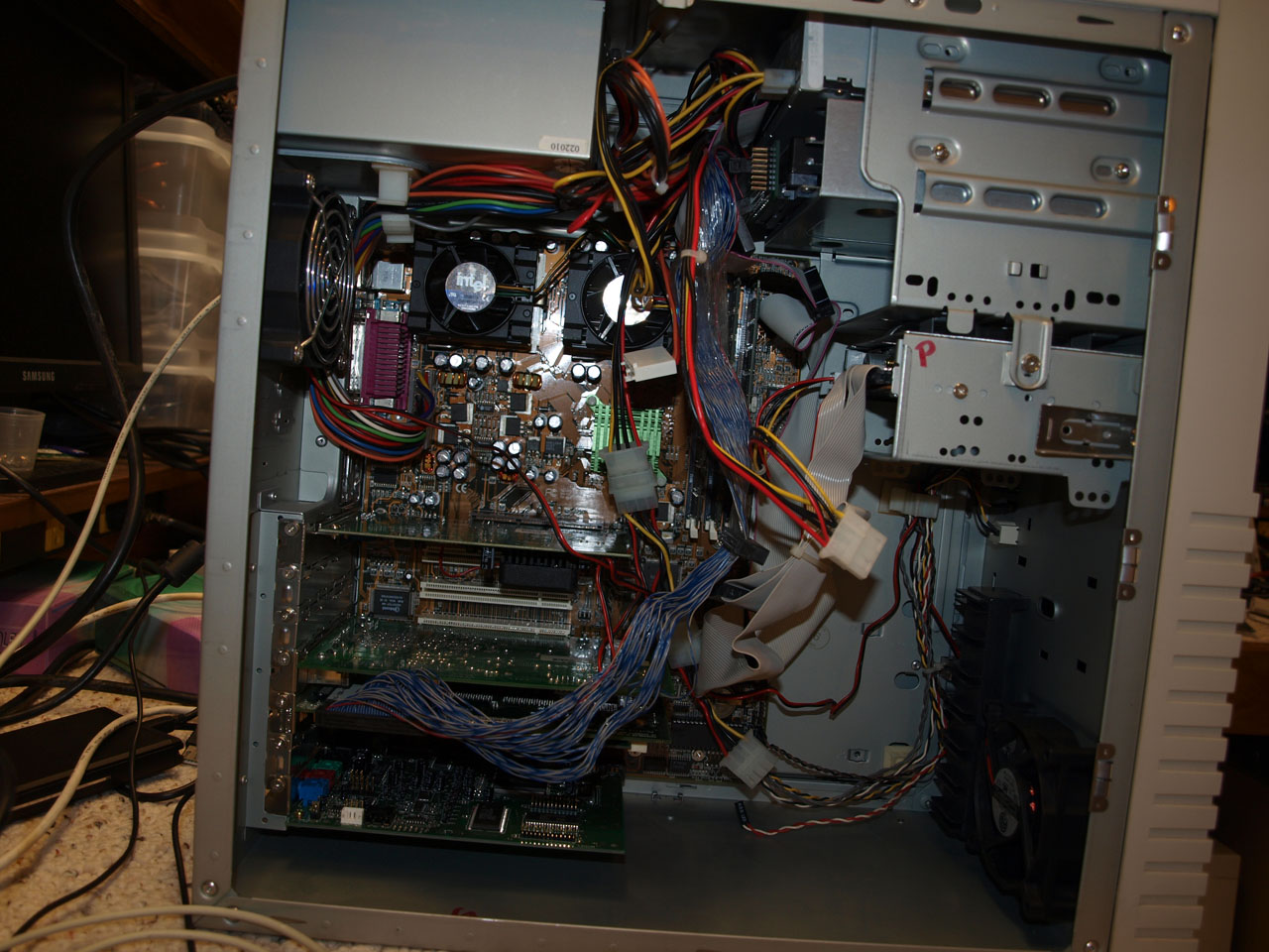

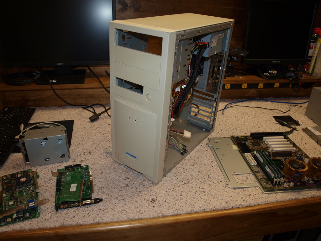

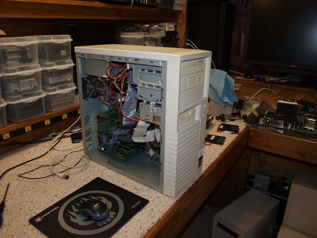

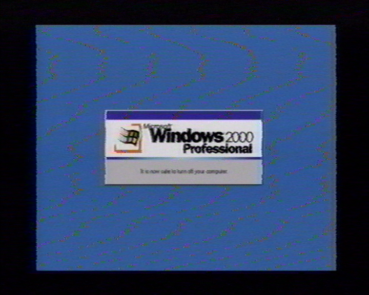

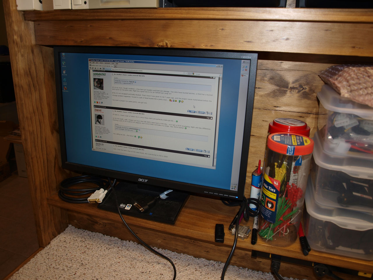

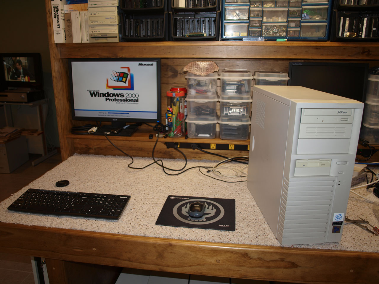

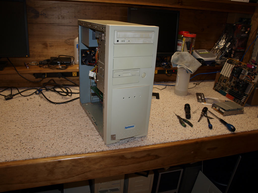

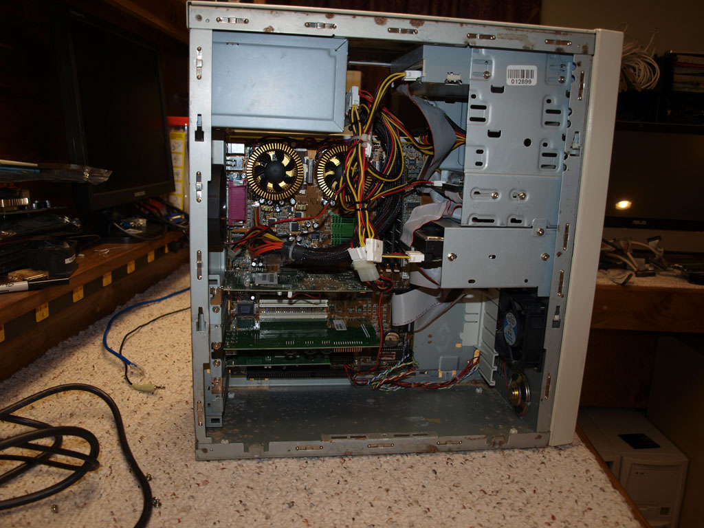

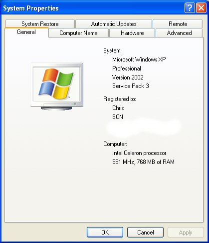

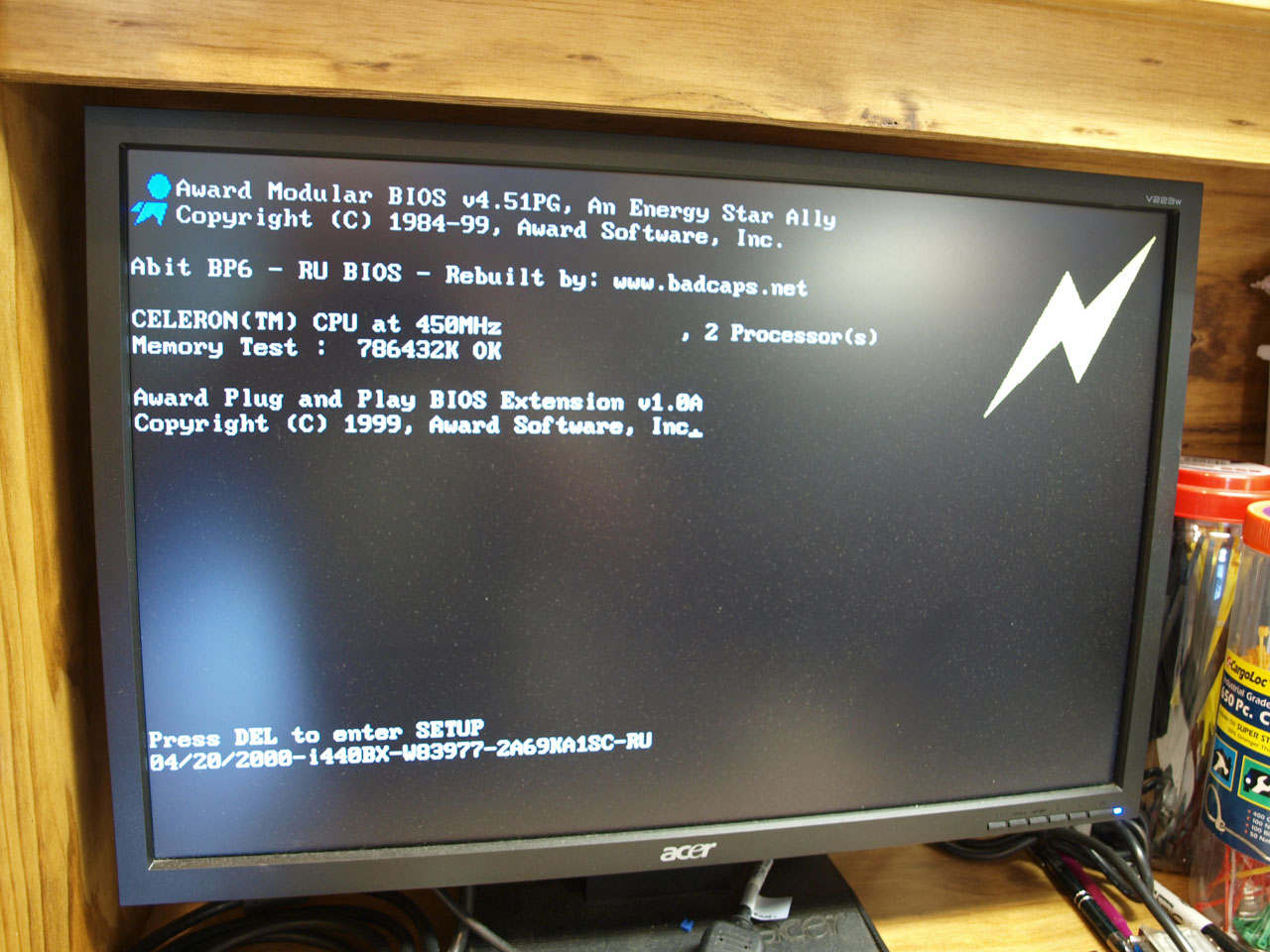

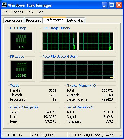

              Runs flawlessly stable @ 550/100, no vcore increase. Looks like the booboo was to my advantage!!
              Going together...
              Purty for a relic....
              Systemax....anyone remember this company back in the P1 & P2 days?
              Almost done...
              Installing OS
              Up & running....
              I didn't novabench this.....not much point on something so slow...
              Specs are:
              Abit BP6 motherboard
              2x Celeron 366 @ 550/100, 2v vcore
              ATI Radeon 7200 32mb GPU
              Diamond Monster Sounds MX300 < -- yea baby!
              Coolermaster 300W PSU
              20gb WD HDD on the HPT366 controller (SLOOOOWWWW)
              YAY for another relic revived!! This post created from it!

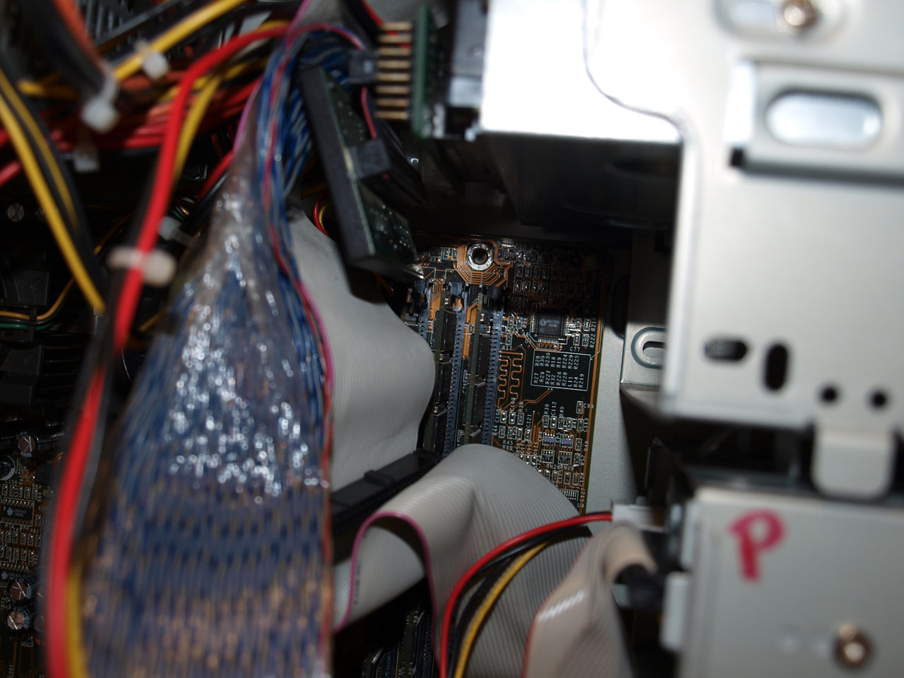

                  It's in my truck. Rough condition. A few bent pin headers and RAM slot damage. Two slots have busted latches, a third has a busted latch pivot on the latch side. Might be a good one to try an SDRAM slot swap on?
                  BTW, it's not recapped and badly bloated. That's how it was given to me 7 years ago, and the project never materialized before the storage problem happened. Tossed in a pile of dead boards like a junky soyo...
                  You want a project (or spare parts), you got one.

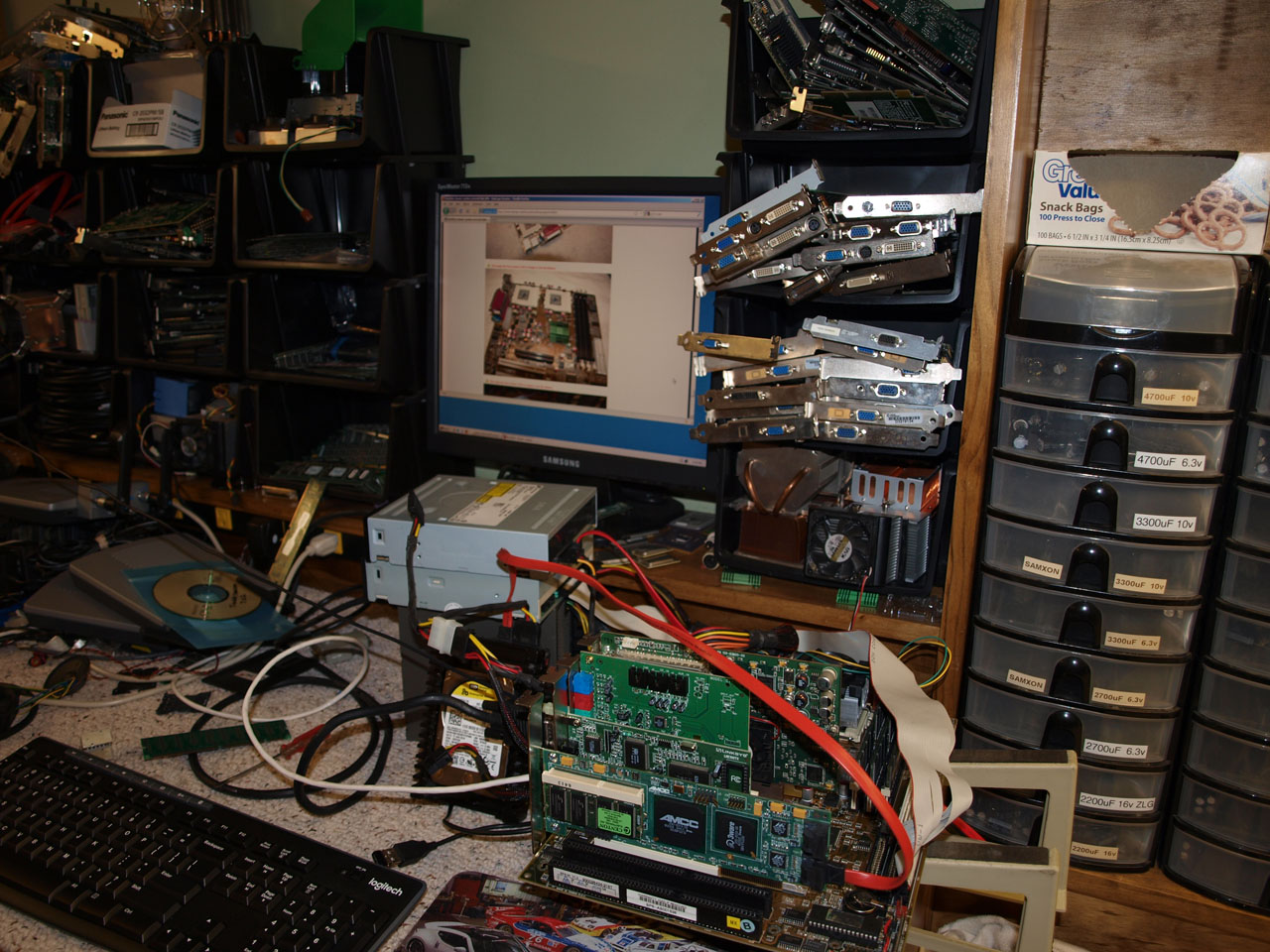

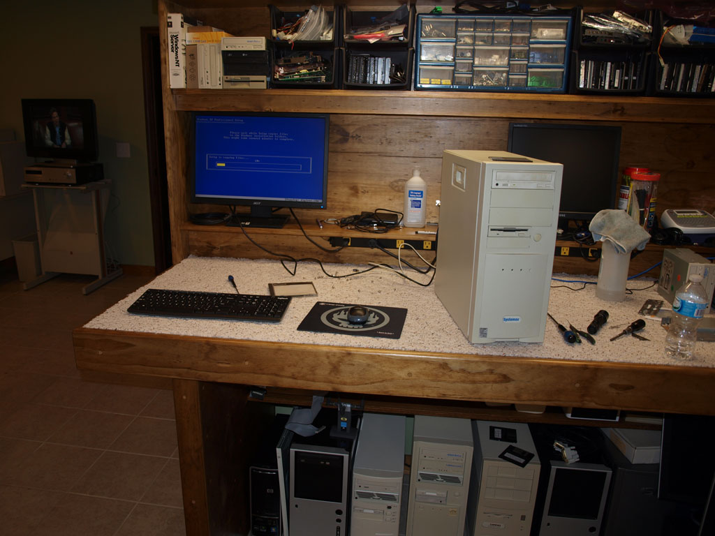

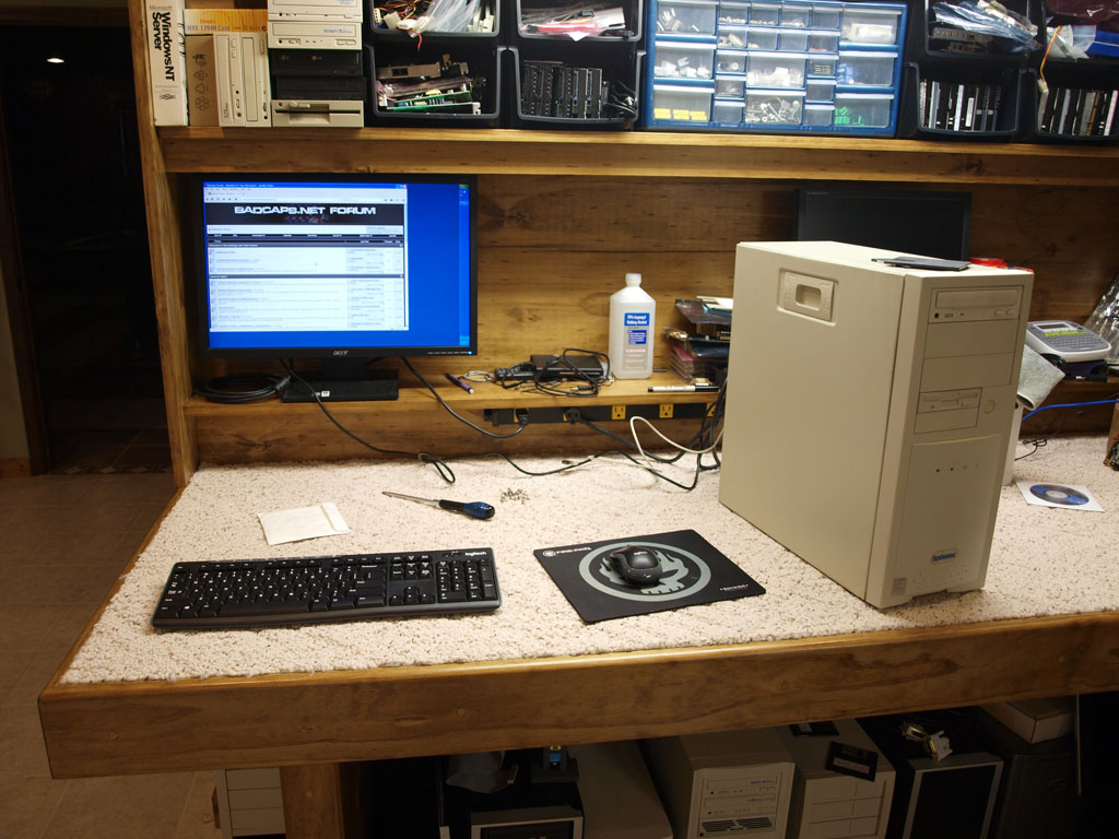

                        Just a little bumping of an old thread about this rough board.... Since it was gifted (and a classic), it was most certainly worthy of some effort....and I had a little spare time to work on it. Recapped and installed in an old beige case I found on ebay that cost basically the shipping....it had some old Zotac P3-era board in it.
                        The Case:
                        Anyway, some classic 300a goodness (these are the 300a's mentioned earlier in this thread)....running flawless @ 450/100.
                        Authentic Ratdude board, busted memory slot latches....it doesn't affect anything, all 3 slots are functional.
                        Pretty Rubies!
                        A classic on a classic!!
                        Firefox 12.
                        Overall specs:
                        Abit BP6 (obviously)
                        2x 300A's @ 450/100
                        768mb RAM
                        TNT2 32mb GPU
                        AWE64 audio
                        Adaptec 2100s u160 scsi controller
                        18.2gb 15k RPM U160 HDD
                        Of course this post created from it. Thanks Ratdude.
                        I have a 3rd BP6 I bought off ebay about a year ago for $25.00 shipped. I recapped it and got it working....but I haven't built a system with it yet. It only took me about 2 years to do this one.

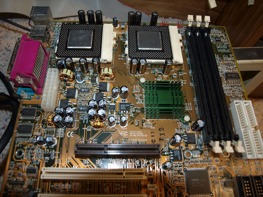

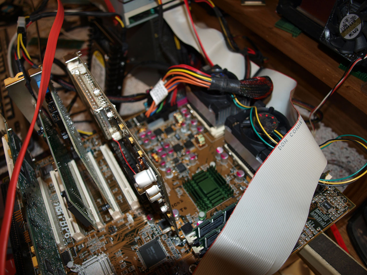

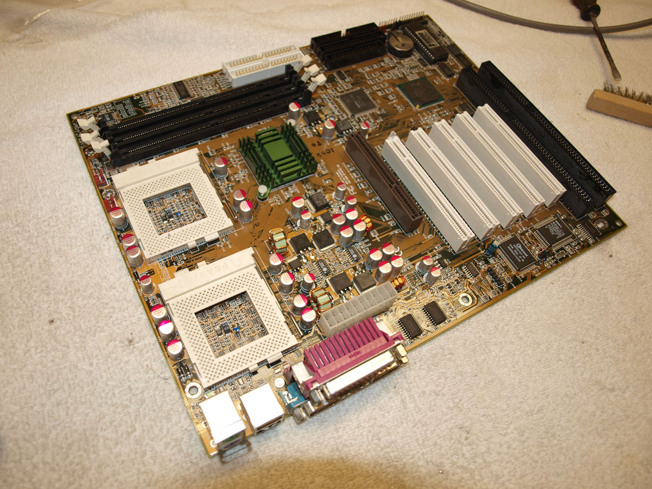

                                Ok...another cheap BP6.....
                                This board would not POST with 2 CPU's before recapping. CPU fan header # 2 was dead. It had the first release BIOS on it (LP)....so yea, it needs a little love.
                                Since this is BP6 # 4, I figured I'd have a little fun with it.... To start with, full polymod...EVERY lytic replaced with polymer, including the small ones. I replaced the 1000uF 10v with 470uF 16v, and the 1500uF 6.3v were replaced with 820uF 6.3v, and the 100uF 16v were replaced with the same value. I also replaced the 2x fan controller transistors for header # 2 (Q4 & Q5), tiny surface mount bastards....they weren't fun....but I got it. Next was flashing the BIOS with my super duper modded version. I then cleaned it in the sink, dried it out, and tested it.....and that's where it's at for now...
                                More to come... repurposing some random heatsinks I scavenged off junk boards for FET's and other things....
