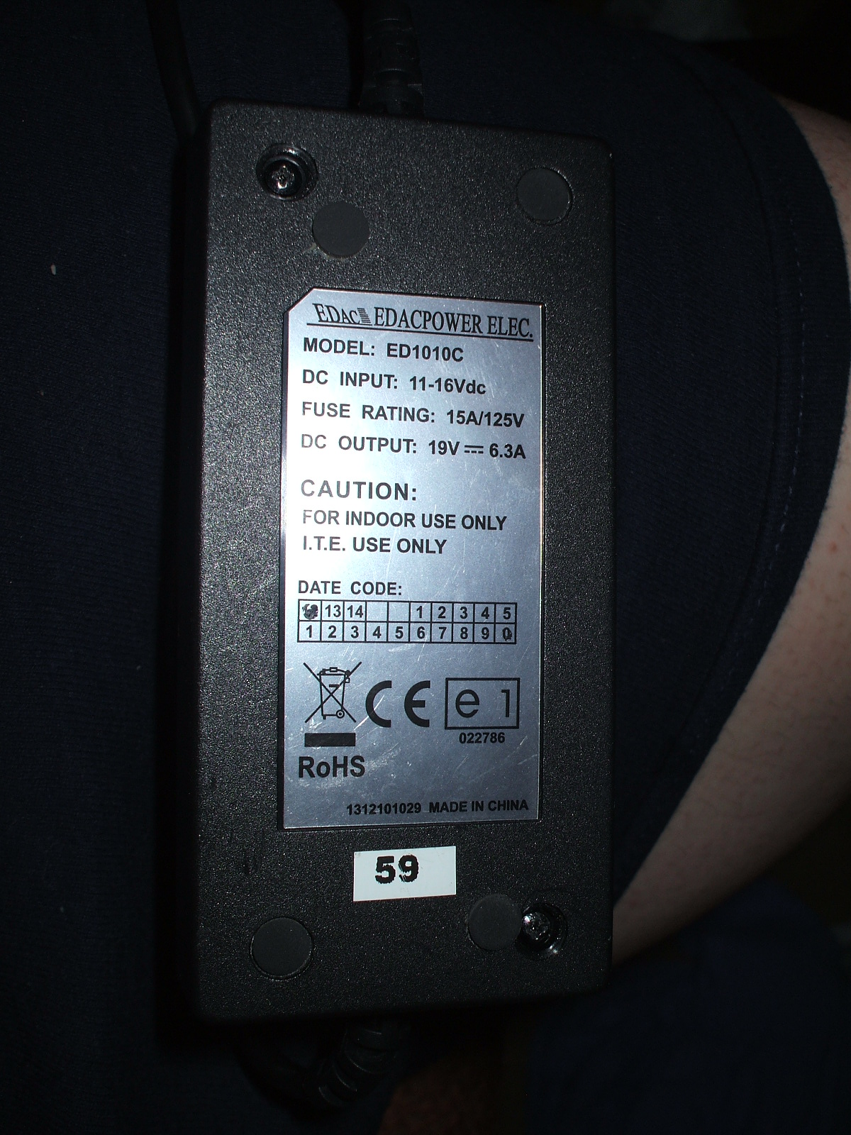

    Yeah, I had some bad luck today. I found a 19V (6.3A output) laptop car adapter at Goodwill for a big fat dollar. The only (working) laptop of mine that it fits is my Asus X83V (there's been a few threads about my shenanigans with it). I test it out, runs great... then smoke in the truck cab! Uh oh!

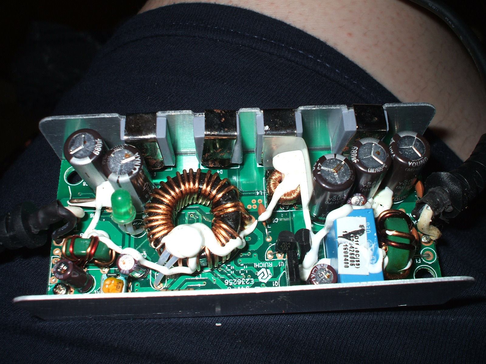

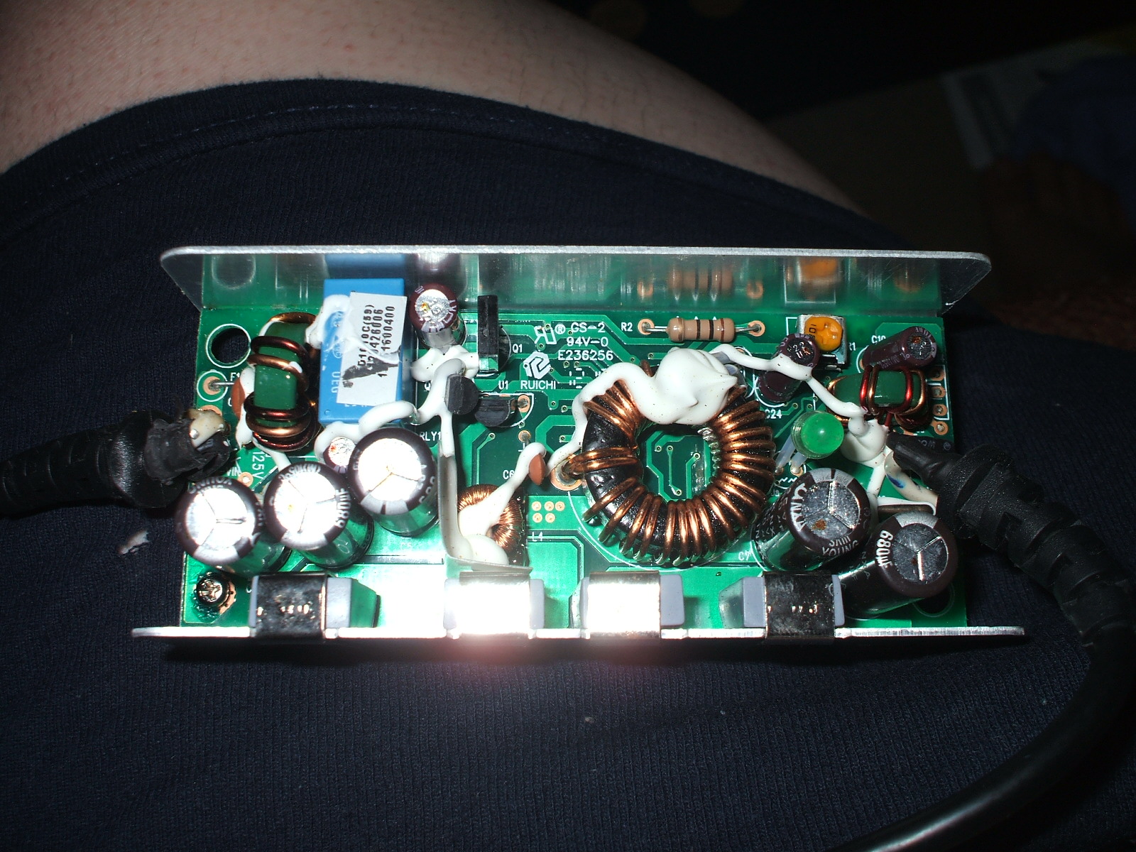

    I originally though I bombed the charger so I open it up... nope, all looks good (actually had decent construction aside from Sam Young caps). After bible study I test it with my wall charger... flicker flicker more smell and possibly smoke. It's fried all right
    Upon dissection I found that some sort of diode thing looks to have shorted and smoked... of course, no markings as to what spec it is. Lovely.

    First, the car charger that seems to have been the culprit:
    Pretty beefy specs there... Here's what's inside:
    Doesn't look all that bad to me. No load the output was reading 19.6V. I don't have a scope to check the ripple though. Maybe the Sam Young caps dried up?

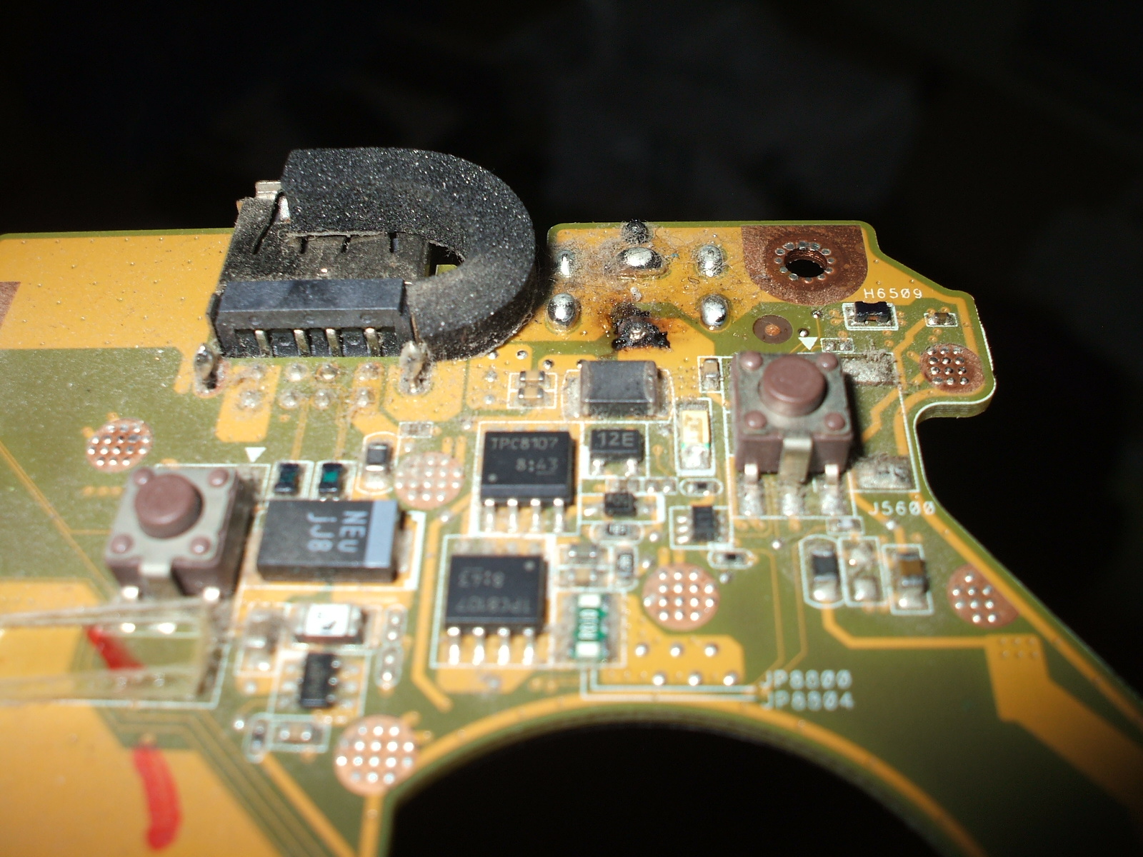

    Here's the relavent part of the laptop's mainboard:
    The part I suspect highlighted:
    Well, I guess I'm down to five working laptops now... If I come across another Penryn platform that I cam move the parts to, it will be tempting. As much as I love this ASUS, the features and serviceability may be good but the build quality is still consumer grade.

        Re: RIP Asus X83V
        fix that.
        i think it's just an inductor, so a jump wire will fix it temporarily.
        why is the pin of the connector so overheated above it?

                  • 31201
                  Re: RIP Asus X83V
                  is there a short across the jack now?
                  if yes, remove the inductor and see if it's on the jack-side or the laptop-side.

                      Re: RIP Asus X83V
                      ^diff found it. That's probably it too.
                      Plugged in the bare motherboard to see what was smoking... it was that bleeping positive DC solder joint! arcing!
                      I cleaned all the char (which I though might have been the issue, that stuff is conductive) and resoldered the joint (good thing I moved my soldering gear to my apartment)... Still arcing, now inside the PCB!
                      What I think happened is whatever went wrong charred the inside of the PCB, shorting the whole thing out. Aka not fixable as the substrate itself is burnt away. Dave Jones actually had this happen before:
                      https://www.youtube.com/watch?v=h6D4MMWjrmM
                      Whatever hit it was hot enough to melt the solder on the DC jack and make it loose contact and arc.
                      I'm calling it fried beyond repair based on what I'm seeing.

                        Test the adapter under load to see what the output voltage is.

                            Which adapter? The car adapter that I was using when it fried or the wall brick I'm using to test it now?
                            Either way if it's arcing inside the PCB itself the goose is cooked.
                            Test the dc to dc adapter. Maybe it goes high under heavy load. Are you wanting to find out what caused the high current load?
                              • 31201
                              Re: RIP Asus X83V
                              it's fixeable,
                              remove the power inlet, drill out the hole for the center pin,
                              refit the connector with a bit of sleeving over the pin to insulate from the board.
                              remove the inductor, and put a jumper from the inboard inductor pad to the connector-pin
                              it could also be a shorted ceramic cap, the schems say they are rated at 25v!!! bastards should have used 50v or 63v
                              6v is not enough headroom.

                                      cracked soldering will cause heating, then burning, then arcing.
