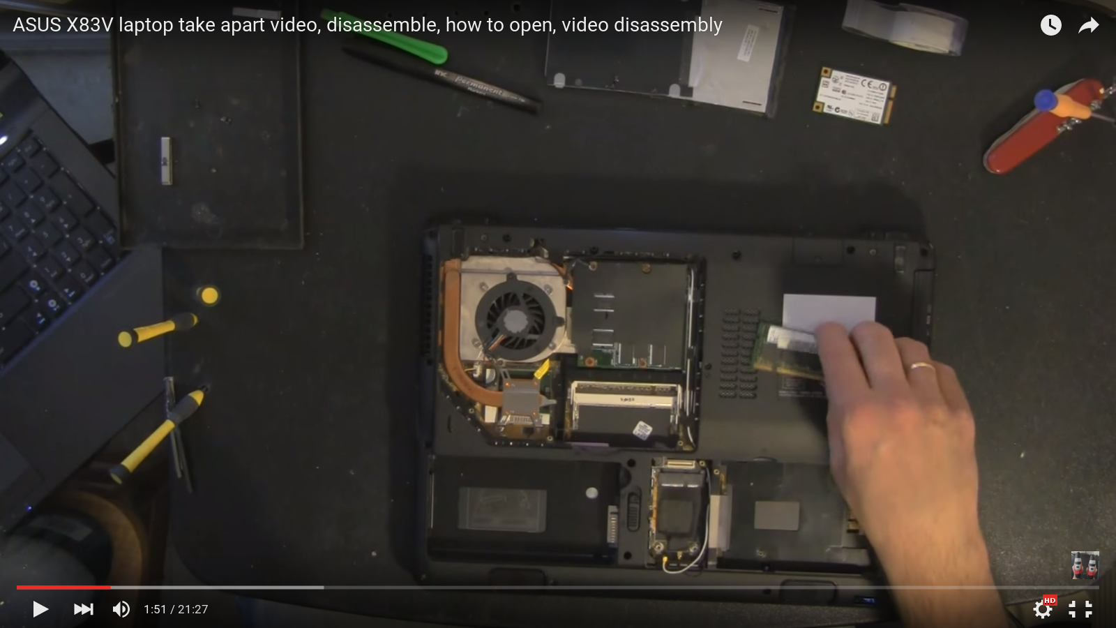

    Question/Idea: I have a heavily modded Asus X83V laptop that I'd like to upgrade the CPU in. It's already had a high-res screen (1400x900) and Intel 7260 AC/BT card hacked in. HDD swapped for a 7200 Seagate unit too.
    It currently has an intel T9550 2.66GHZ C2D in it. Not a bad CPU for the era, but the fact it was a hand-me-down from a buddy's upgrade of another laptop has wanting to bump it a bit.
    The thing is despite this being a consumer laptop, it was built like a barebones unit; one or two covers removed gives access to everything short of the internal BT option (which I don't have)... it even had provisions for a TV Tuner no less... its the most feature packed 14" laptop from 2009 you'll ever find. Anyway, between that and that it has a beefy cooler (shared with the GPU card, a Nvidia GeForce 9300M 512MB):
    (picture pulled from ebay, the CPU pad is the one exposed in this picture)
    ...that it seems like I could probably swap in a core 2 quad unit.
    I did some ebay hunting and found that for $36 or less shipped (from china) I can get a Q9000 core 2 Quad (2.0GHz)... the other two (the Q9100 and QX9300) are $100+ a pop and from the looks of things only marginally better.
    My BIOS is up to date (and FWIW, SLIC'd).
    So the question is... will it work? It looks to physically, electrically, and thermally be doable (the CPU pad, as in the picture, is full copper and appears to be big enough for the twin dies in a C2Q). What I don't know is if the BIOS will like it. I do know that the BIOS seems pretty tolerant of things in general (c'mon, it let me switch to a non-stock screen resolution and a definitely non-stock WiFi/BT card without any complaints)...
    Anybody have experience with C2D swaps on desktops or laptops? Is BIOS compatibility generally an issue?

    Still wasn't sure if the cooler would fit, so I did some image hunting and some manipulation with Gimp.
    First, I found a teardown video which allowed me to get a screenshot with the cooler mounted to the CPU:
    https://www.youtube.com/watch?v=tc2WunwY7Ek
    I then cropped it to the area of interest:
    I then found a picture of the Q9000 CPU from the review of a MSI laptop review:
    Finally, I cropped/rotated the CPU image, and scaled the images so the CPUs match in size. Finally, I overlayed the CPU image (reduced opacity) over the laptop image:
    Looks like it would fit, not by much. given the square marks on the C2Q, I wonder if that cooler size is a standard given by intel? They seem awful close...

      Any laptop that has the PM45 chipset will take a C2Q. You already have a 1066 FSB processor there so the requirements are met - the older 965 chipset only supported FSB 800.
      Btw, you have the 9300M GS not G. Otherwise the laptop would have died long ago as the 9300M G is simply a rename of the 8400M GS, and we all know the story behind that.

        you're going from 35w to 45w, and assuming the microcode is compatible. With all this laptop seemed to have integrated, lets hope they didn't cheapen out on the vrm

            Actually it seems ASUS did a good job on the motherboard
            I've attached some pictures I found of the motheboard. VRM look beefy? (I'm not a laptop VRM expert)...

              looks like only 2 phase power for the cpu... going from 35w to 45w tdp means an extra 5w of load per phase for the vrms. u can get away with it if u try putting mosfet heatsinks for the soic 8 leg mosfets. there are 4 on each side of the board for a total of 8. hopefully, the mosfet heatsinks fit in and dont block the laptop covers.
              was also searching for a list of mobile c2quads on wikipedia when i saw sumthing on there u might wanna pay attention to:
              Originally posted by Wikipedia
              Notebook Core 2 Quads are designated Socket P' [sic] and are not pin compatible with standard Socket P motherboards. They can be arduously modified to work on some Socket P motherboards, such as Lenovo ThinkPad T61 and HP HDX9000.
              Source: Wikipedia - List of Intel Core 2 microprocessors. take note of the additional apostrophe behind the "P".
              so the cpu pinout on mobile c2quads is different from their duo counterparts. if it doesnt work unmodded on the first try, u may have to do a pin mod by shorting or taping some pads on the cpu to get it to work... all the more reason to get the cheapest one u can find in case it totally cannot work at all!

                Funny, all that I'm seeing is that the Q9000 at least is regular old Socket P.
                Noted on the mosfet heatsinks, I'll look into that.
                Edit- Not sure how much of an upgrade it really is.. the Q9100 also has double the L2 Cache (6M vs 12M shared between all cores), which leads me to believe that the Q9000 is a dog, given the slow clock speed. I can get a T9800 for about the same price (2nd nicest mobile C2D)... Which would have 6M cache (only shared between two cores, not 4) and a higher clock speed.
