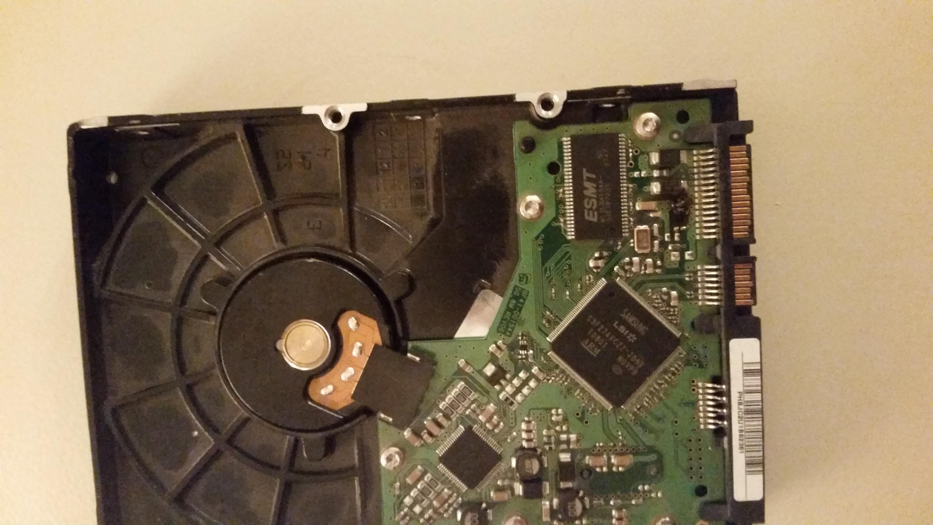

                              but i also have another issue unfortunately, my 80gb samsung HDD that had about 5 years of power on hours has died. i smelled smoke from the server but nothing stopped working so i pulled the plug anyways and the samsung pcb has burnt but the drive worked while it was smoking???. anyways it doesnt work now and was wondering if its possible to repair it again sorry for the low quality pic but heres the part thats burnt
                              Edit: Higher resolution picture of hdd board
                                • 31248
                                #35
                                Re: PC Killing HDDS?
                                probably repairable.
                                you need to clean the soot and tar off with IPA and find a foro of one that is o.k.. so we can see what's there.

                                      The Samsung HDD has been killed by on overvoltage on the +5V supply. You need to replace the 5V TVS diode (which will probably be shorted) and the zero-ohm resistor.
                                      http://www.users.on.net/~fzabkar/HDD/HD103UJ_TVS.jpg
                                      If you now remove the WD PCB, you will probably see the catastrophic failure that I warned you about earlier. Moreover, since the overvoltage hit the 5V supply, you will probably find that the drive has sustained a damaged preamp on the headstack, which now makes it a paperweight.

                                          #40
                                          that happened before replacing the caps. thats the reason i replaced them and i checked voltages and they were correct and stable (old caps 5v was jumping from 4 - 6, 12 was 10 - 14!!) corsair and their low quality crapacitors
