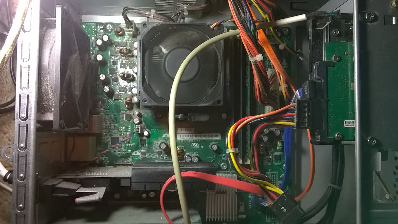

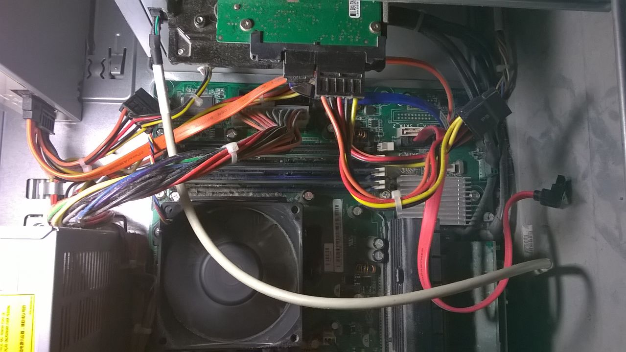

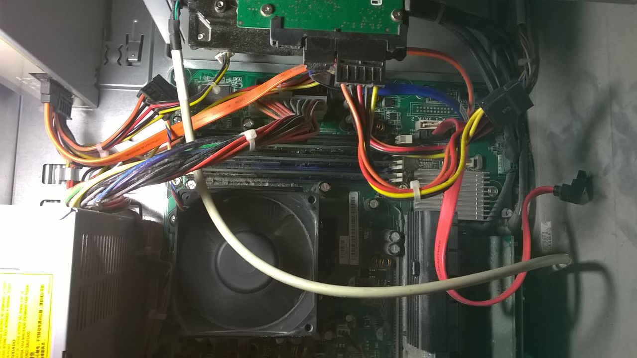

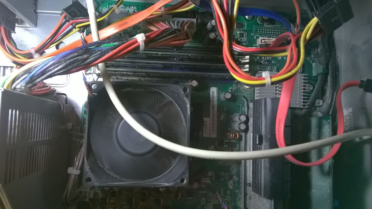

                        alright I took 4 photos of the inside of nthe computer. Looks like the human nervous system!

                            #73
                            Re: Dell inspiron 531 4gb ram 64 bit OS running very slowly
                            Wow, you need to blow the dirt off the CPU heatsink.
                              • 31304
                              #74
                              yea, i see a few things there.
                              first, take the fan off the cpu heatsink and vac all the fluff and dust out or the cpu will overheat and slow down.
                              second thing i noticed is the rear fan looks like it's fitted the wrong way around - it's sucking in insead of out.
                              now as for my original point, try removing the blue sata cable and replacing it with the spare red one that has one end disconnected at the moment.
                              btw, if your brave, try removing the psu and opening it for a visual inspection.
