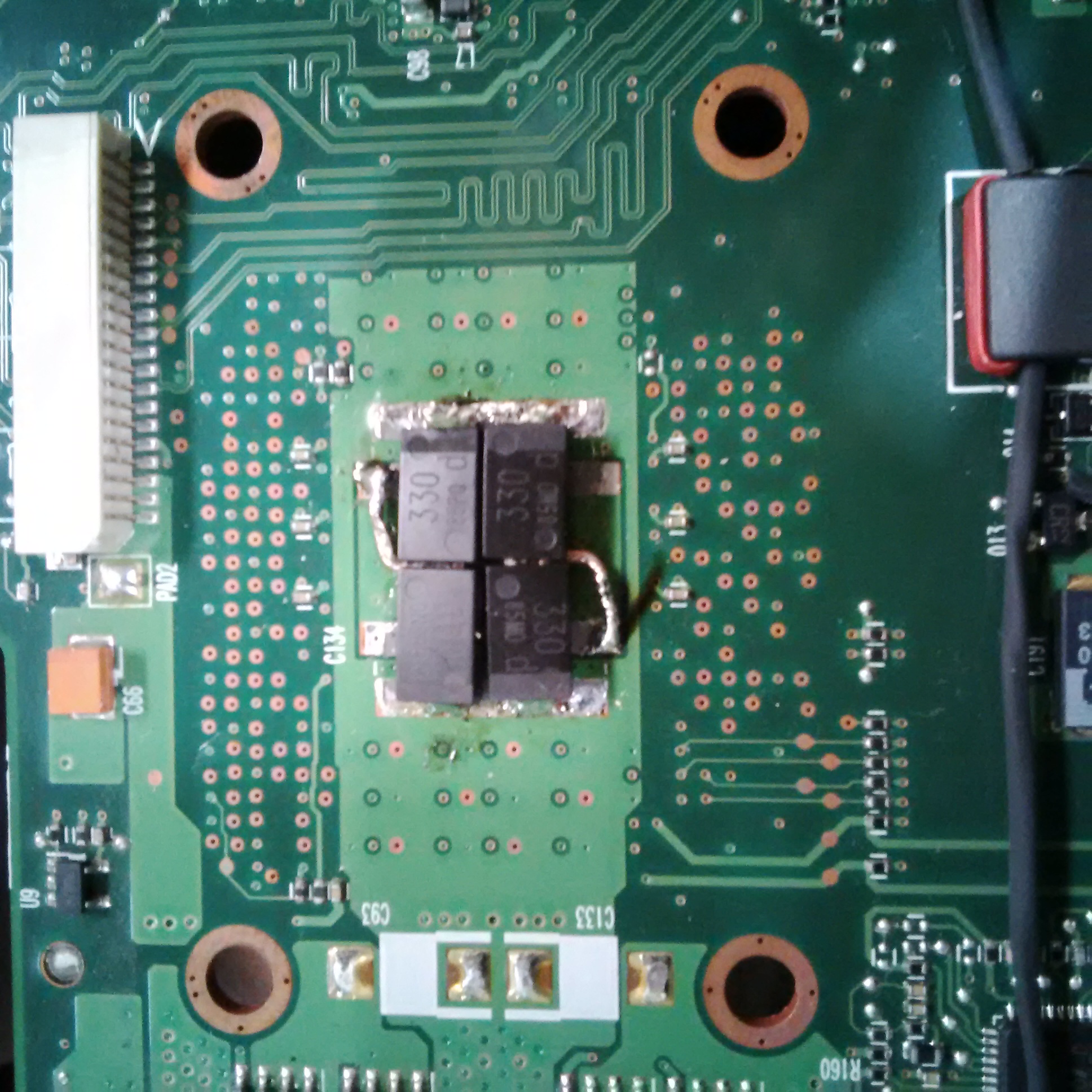

    Hi peoples, I have an A300 that needs to have the NEC Tokin 0E907 replaced. Now I am a novice at this sought of thing, so can some please post a complete fix: this would be from the removal of the Tokin, cleaning the 4 strips and how to solder the 4 new capacitors, including the soldering method, Photos of each stage. Also, what one has to to do to determine the corrects Tantalums. I have seen these Tatalums on ebay where they state them as being a replacement for the Nec Tokin 0E907. http://www.ebay.com.au/itm/4x-SMD-Ta...-/330953629462 Thanks peoples

    Read this thread, lots of help in there https://www.badcaps.net/forum/showth...ighlight=tokin
    Yes those tantalums are suitable.

          Advice Please, I can get these Caps here in Perth Australia, would these do the job???
          http://au.mouser.com/ProductDetail/K...1myMofWw%3D%3D

            At 3.1mm i believe they are too tall.

              Si I should stick to these http://www.ebay.com.au/itm/4x-SMD-Ta...item35d388d70c

                This work for me

                  Originally posted by bonniedoon
                  Yes

                    please could someone check these links to see if they would be ok to fix my a300
                    http://au.rs-online.com/web/p/tantal...itors/7887457/

                      it's oK

                        You can try to use ceramic capacitors to replace your Toshiba Satellite A300 NEC tokin. You can get the replacement capacitors from RS-Components Australia with this PART NO: GRM31CR60J107ME39L. There are some successful testimonials from this forum by just using at least 10 of these ceramic capacitors from these badcaps mega thread...

                        take a look at this... added some on the pads along with the original nec tokin chip but not really neat or just put them all 10 of the capacitors as a replacement for any tantalum one....

                          I found that ten of GRM31CR60J107ME39L were needed sometimes.
                          I have been using four of 2R5TPE330M9 2.5V 330UF for a year or so now.
                          If a lot are needed, they can be found on AliExpress for good prices.
