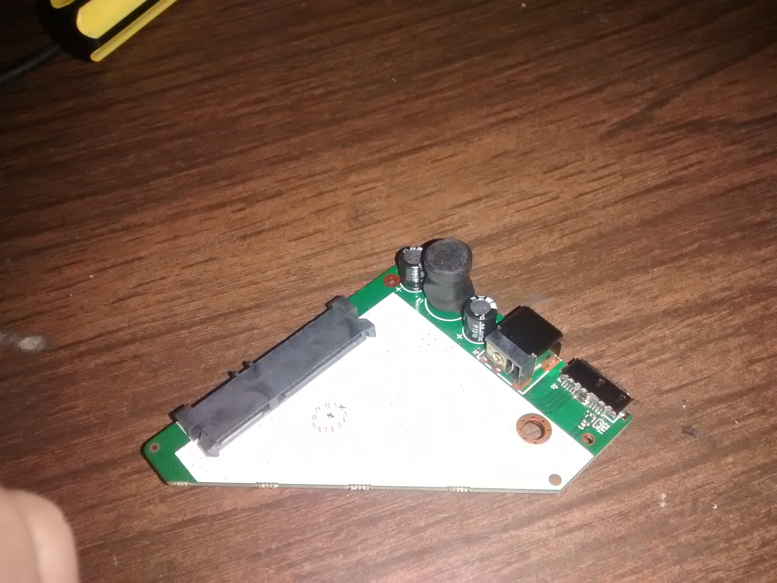

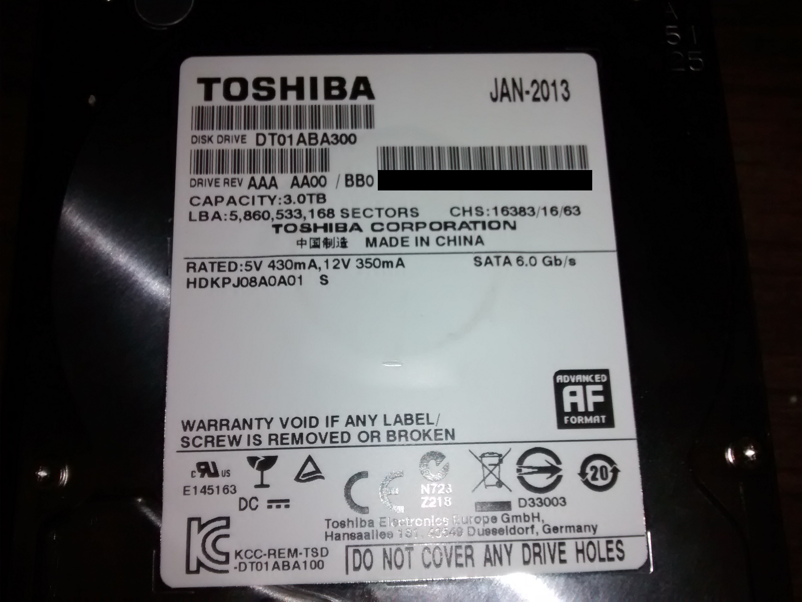

    This one is a 3tb Toshiba dwc130 Canvio brought to me because Windows Vista would not "see" it.
    It seemed to have issues spinning up and loading the heads, so i checked the power brick which checked fine, next i pulled the drive and swapped it into one of the hotswap bays of my system and it worked fine.

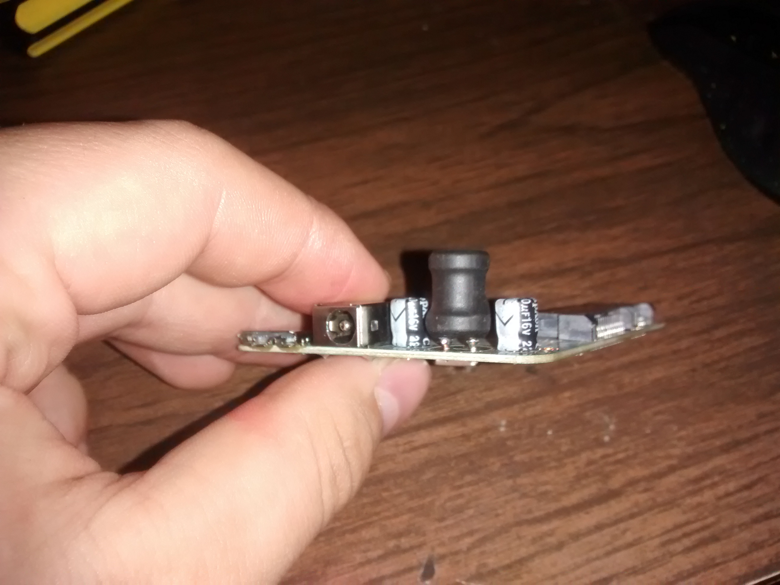

    The data was corrupted beyond all recognition so i went on to the drive bridge where i found two dry 220uF 16V CrapXon caps (pix before cap test).
    Going into the S.M.A.R.T data i found the drive was ran over temp (63c) for 720 hours, all others are fine with an exception of the number of interface CRC errors.

    some of those usb-sata boards have encryption.
    could explain the corruption.
    crapxons strike again!
    thats a buck to make +5.
    noise on +5 can corrupt data too.
    not the first toshiba external hdd i have seen die this way.shame on you toshiba!

      *UPDATE*
      the drive is absolutely fine. passed an extended self test and managed to survive a SECURE_ERASE command. it is now my backup drive in my hot swap bay.

                        I see a large inductor with an 8-pin SOP IC (most likely to be a DC-DC converter) nearby.
                        So therefore, these electrolytic capacitors (CapXon) were not up to the task of filtering the output of the onboard DC-DC converter.
                        For the given capacitance and size, I would replace with solid polymer units.
