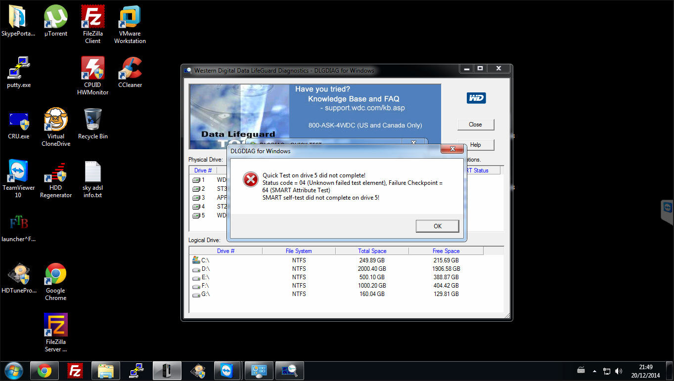

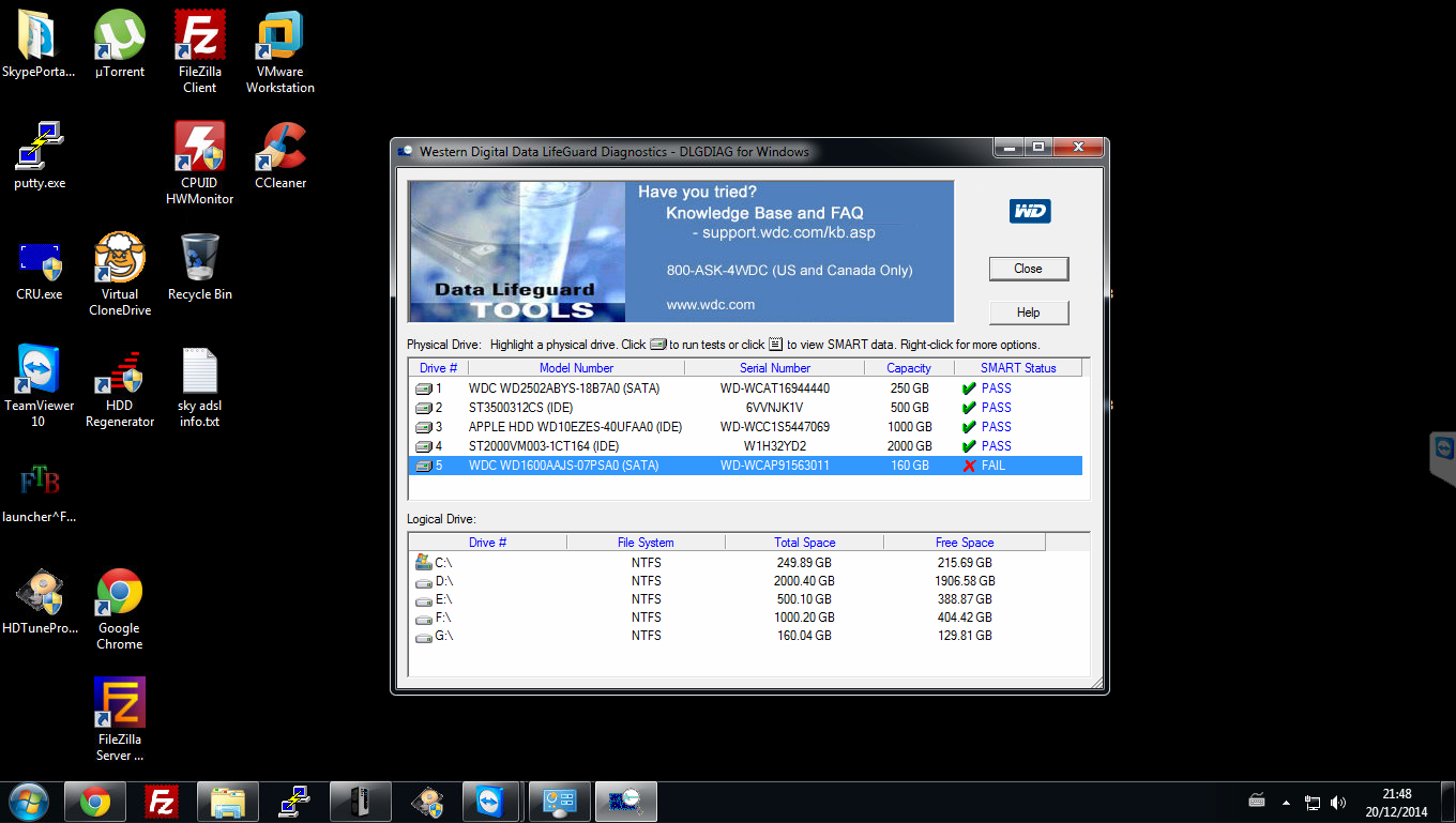

                                  I wonder if you would run this diagnostic of my benefit? http://support.wdc.com/product/downl...&sid=3&lang=en
                                    #37
                                    Re: Another HDD issue
                                    il run it and report back... so far this hdd is still running but now it doesnt show any bad sectors pending reallocation but when i do an error scan it shows new bad sectors, but never reallocates anymore or marks them as pending.

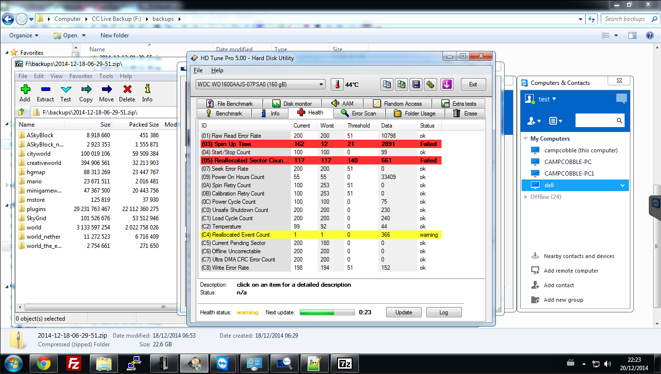

                                      How many are reallocated? It might be out of spares.

                                        It failed the quick test and currently is running the extended test. some screenshots from the quick test.

                                          This is the SMART info for the hdd. looks like it still has a few spares... i wonder if its running low so it gets more strict or something and only reallocates very bad ones
