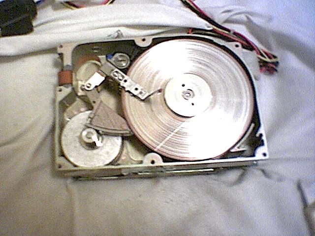

        Did your HDD make any unusual noises before the system froze? Was it 'clicking' and spinning down, then spinning up again in the middle of Windows? That happened once to a server of mine, and the HDD itself crashed (scraped platters) a few days later. Sorry about the low quality; it was taken with a webcam
