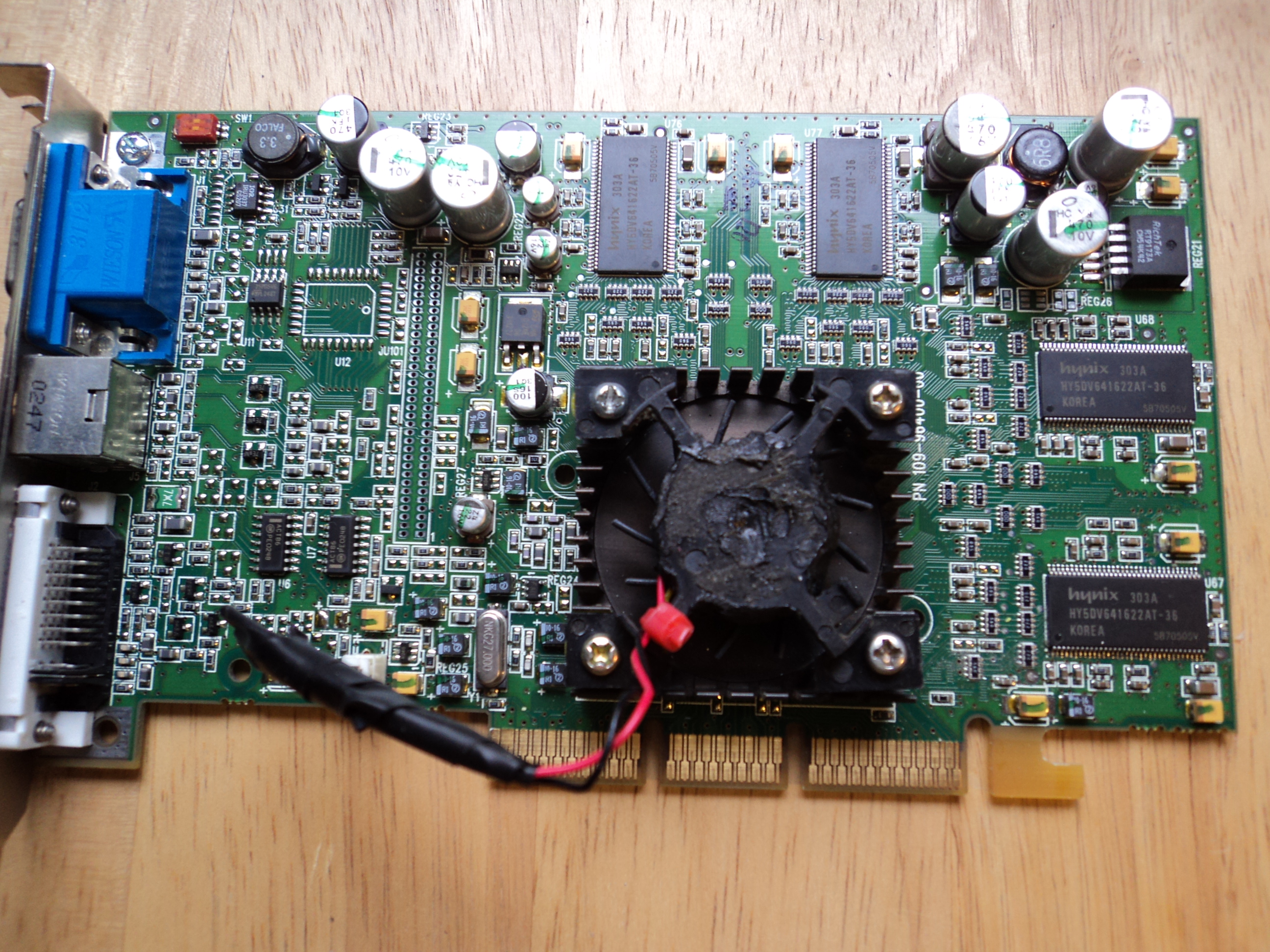

    Hi guys: i have installed a Video card RV 250 Ati 9000 on my
    Dell Demention 4500 P4,and it has a small fan and i checked and it's not moving at all, my question is, will it run when it gets to a certain temperature?.

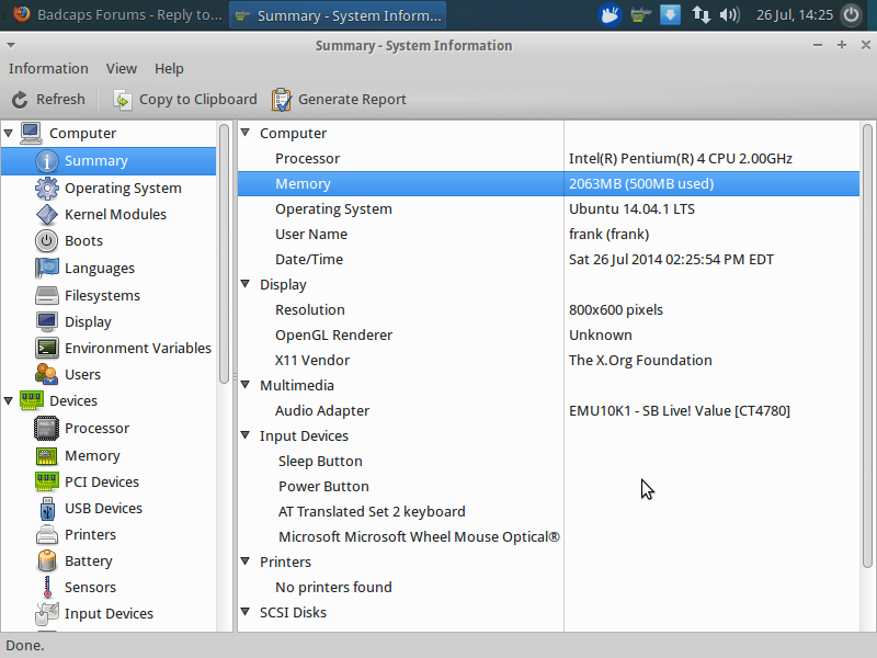

    Also i bought two sticks of 1g of mem ram to make the Dell Demention 4500 P4 2 Gigs of mem ram to change the 2 sticks of 525mb each.
    i've noticed on the specs of Dell 4500 it sais max 1Gb.
    my question will i take advantadge of the 2 gib mem ram that i ordered?

    you need a new gpu fan,
    or strip & clean & oil the old fan,
    or fit a bigger heatsink - or it will end up killing the card.

      Re Memory - according to Dell specs it will only take 1gb BUT there are posts in the Dell forum that suggest it will work up to 2gb so its gong to be a risk.

        got a foto of the fan?

          The memory should work, it seems Dell did not update their docs. as it is an older product, and at the time only 512 memory modules were available. People on other forums have upgraded to 2G no problem.

            Thanks Guys; update on Mem ran, i received today the 2 sticks of 1gb mem ram each and installed and the Desktop works fine it shows the 2 gb.
            Here is an atchment of the System info.
            about the fan this is a pic of it
            http://www.gpureview.com/radeon-9000-pro-card-66.html

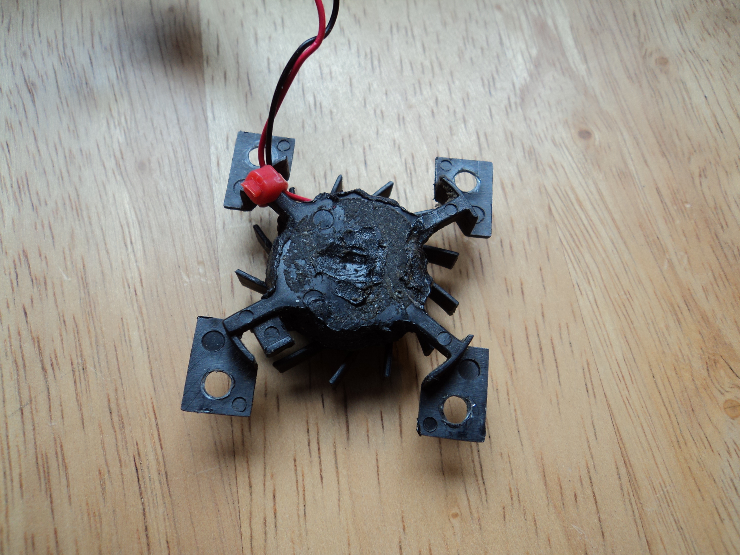

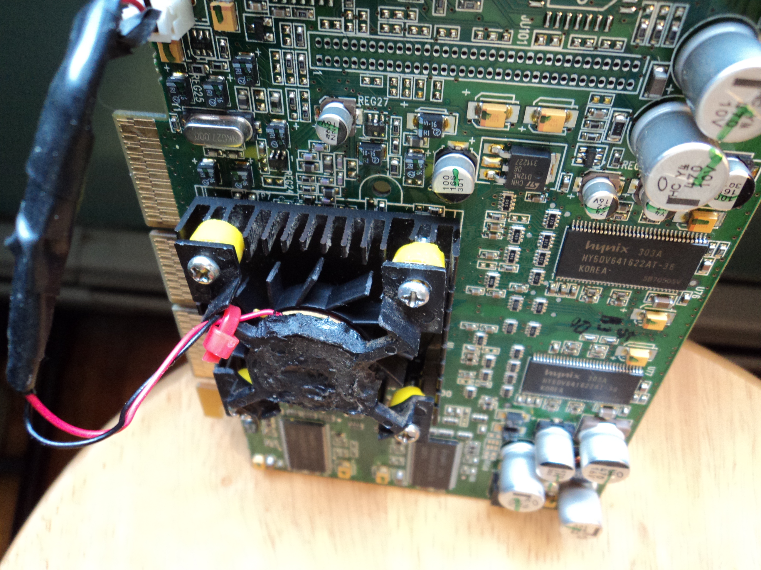

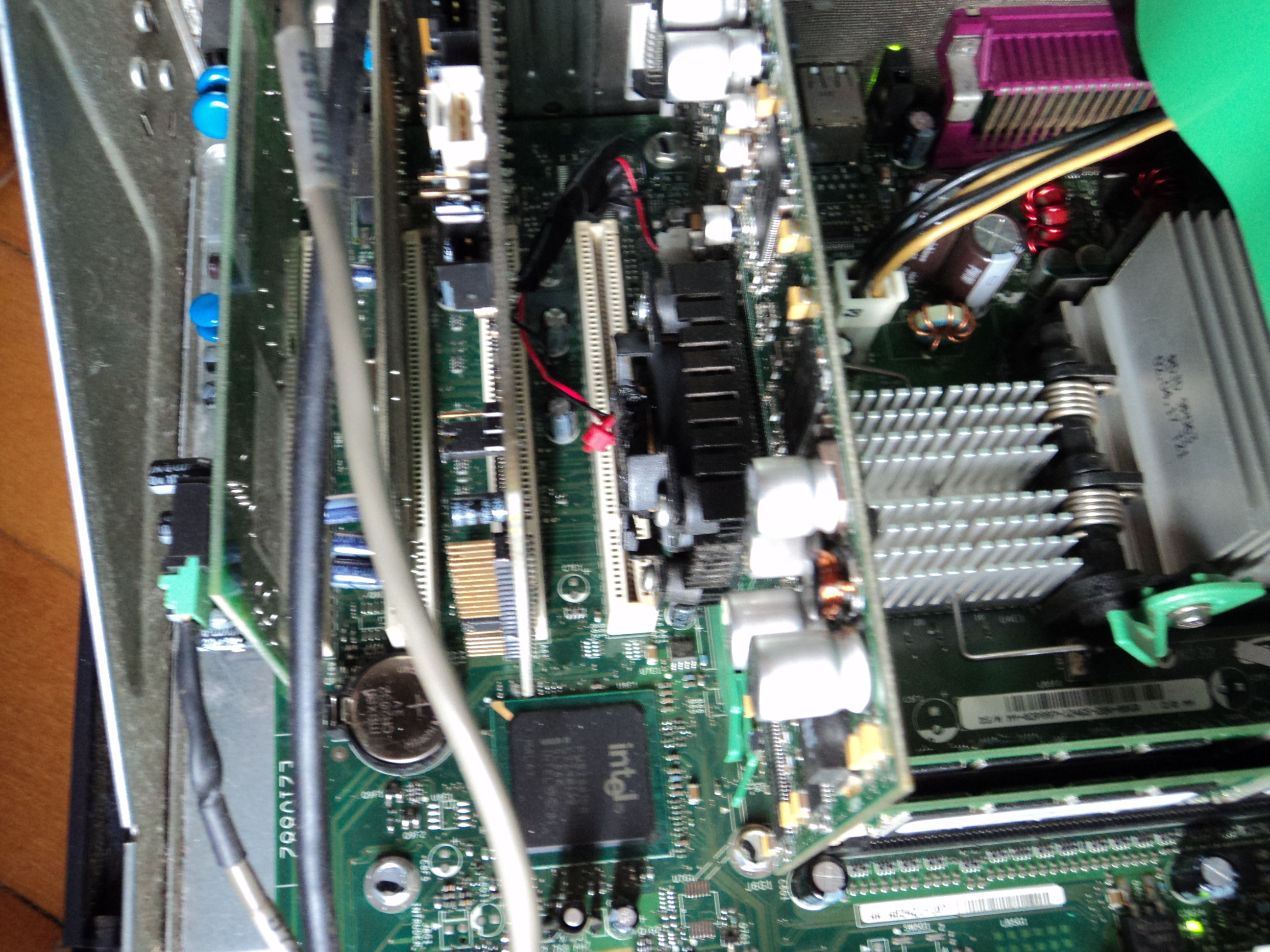

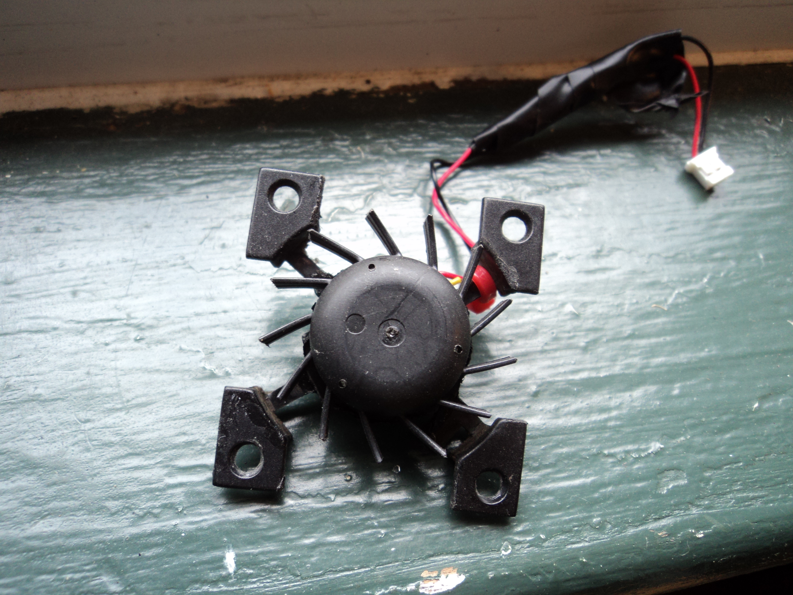

              Re: Help please
              Hi guys;Update on the video card fan,i had a PC small 6v fan hanging around and had to trim the Fan blades to fit the hit sink bed, also had to lift it a little bit with plastic rings cause it was Half a quarter inch thicker,then i attached the fan wires to the same 5 v card output and so far has been working like a charm,i love my inventions.
              see pic.
