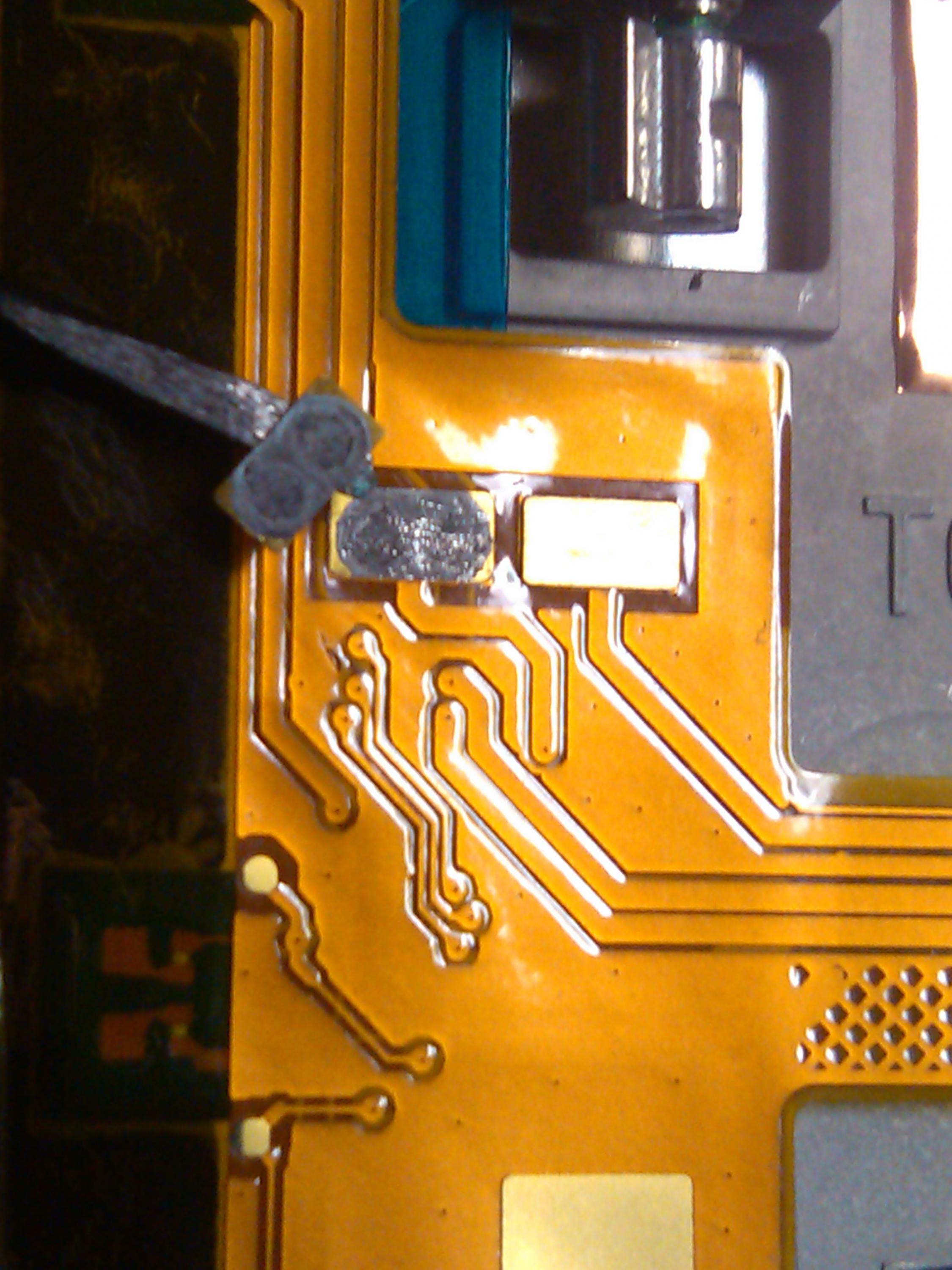

    I am replacing the digitizer on a friends HTC One X. I moved a flexible circuit board and a copper square fell off. I was going to just re-wet the square but I stopped because the solder looked more like an adhesive. I am hoping that someone here can tell me if this is an adhesive (and what kind) or if I am crazy and I just need to wet it again. I took a close up pic with the pad resting on a screwdriver next to the spot it fell off of. Thank you for your help!

    hard to tell from that pic....but it *looks* like solder.... On flex boards, its usually glue though.

      That's glue. It was holding the pad that you lifted in place. Is the track still connected to the pad? If so, just glue it back in place... Most people recommend cyanoacrylate, I personally don't like it since it leaves residue all over the place when it evaporates. Maybe a very thin layer of some sort of tack glue.

        Thanks guys for the quick help! I got some conductive glue and it's drying now.
