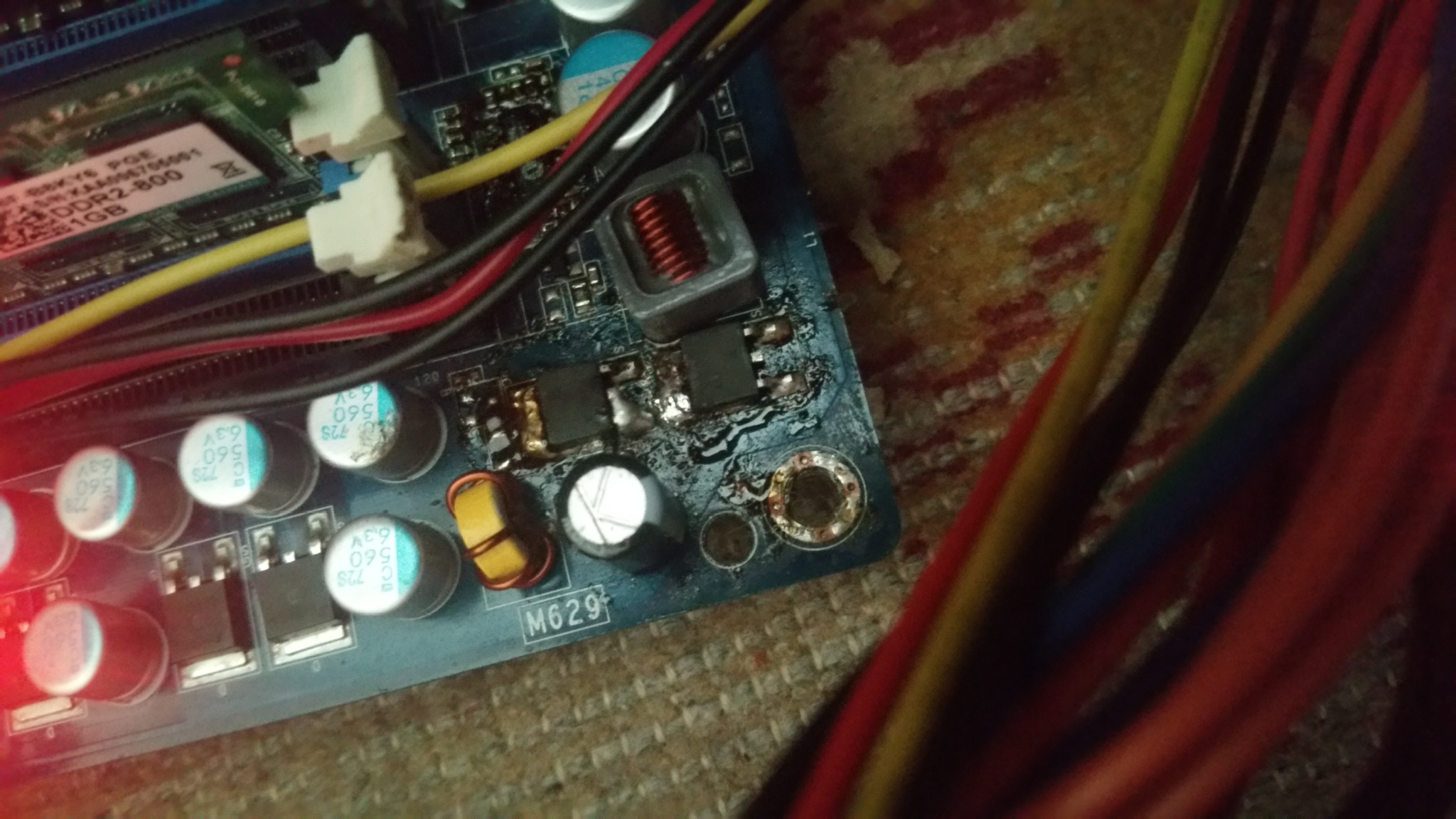

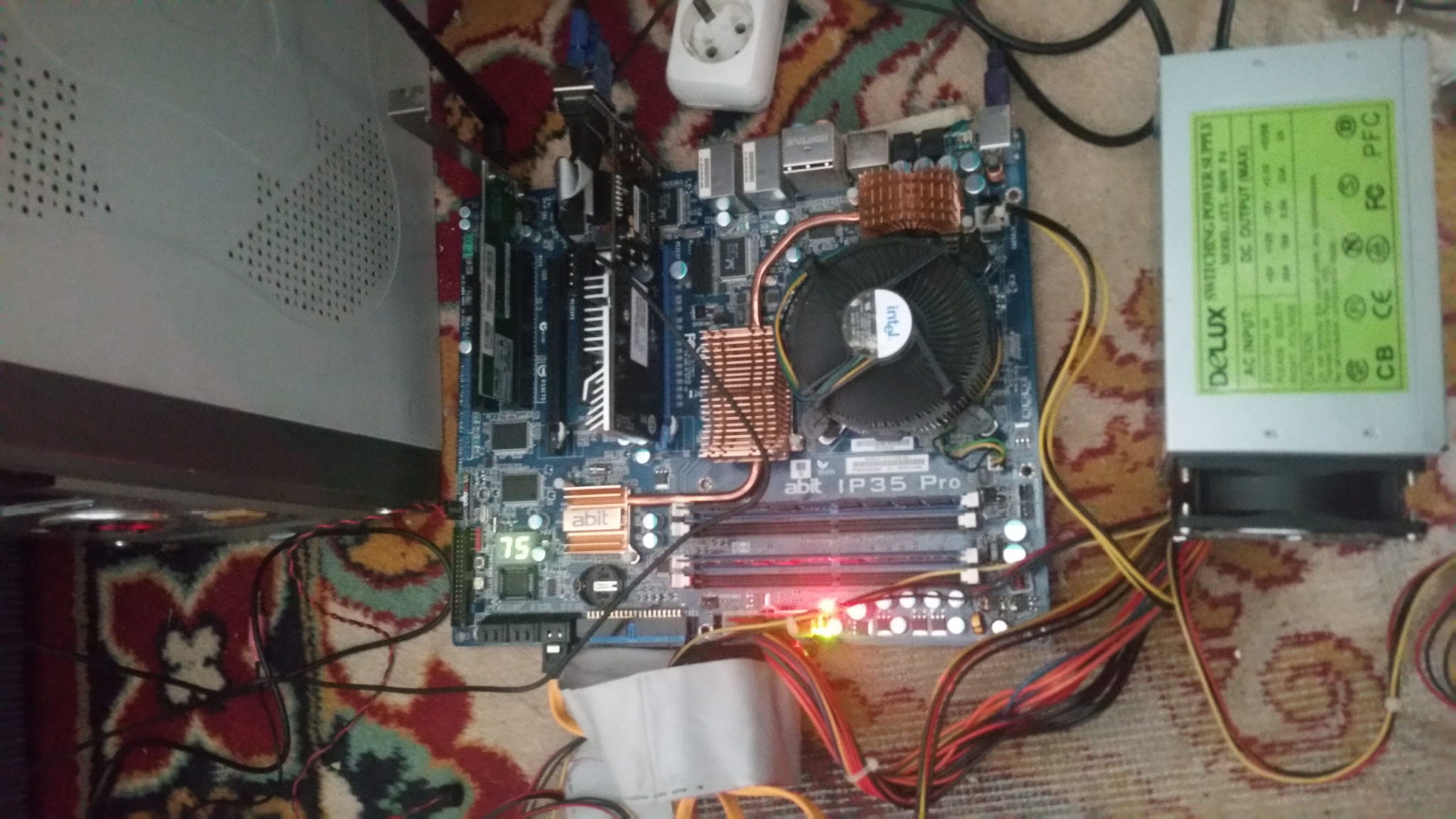

                  Strikin' again with another ghetto mod.
                  abit IP35 Pro mobo - replaced one Winbond chip that was bad near the RAM slots. This however didn't change the fact that it would still give error 8.4 and not POST.
                  You can see the mod here Now it works fine (although that area gets really hot, but that's a design flaw, my older IP35-E had the same hotness issue) although I keep getting 0x7E on Windows discs, but that's another story.

                    Re: The ghetto mod thread
                    BIOS UI reminds me of socket 462, LOL. (And early-2010s' Gigabyte AM3)

                      What winbond chip, what determined it was bad?
                      The picture looks like a bunch of replaced MOSFETs for the buck converter (which doesn't look that ghetto)?

                          An Winbond W83220G, which is a N-channel FET synchronous buck regulator controller.
                          I found out it was bad because before replacing it, the board kept freezing on POST (with the same bridge applied on FET, as without it the board simply won't boot and stop on error 8.4 which is DDR voltage)
                          Agent24- The SIO chip is fine.
                            That bridge you created essentially shorts Gate to Drain. I imagine this makes the MOSFET stuck On all the time. But it's not a good method, because you are back-feeding whatever chip is supposed to drive the Gate of that MOSFET. If the MOSFET is used just a simple pass-through switch with diode junction, then you're better off placing a jumper across Source-Drain junction. But if it's a buck regulator, this is certainly a bad idea (I see some inductors nearby, so check). In that case, you have to figure what's driving that buck regulator circuit and fix it, as that's likely the cause of the issue.
                                I think it acts as a switch and the other one next to it is the one that is important.
