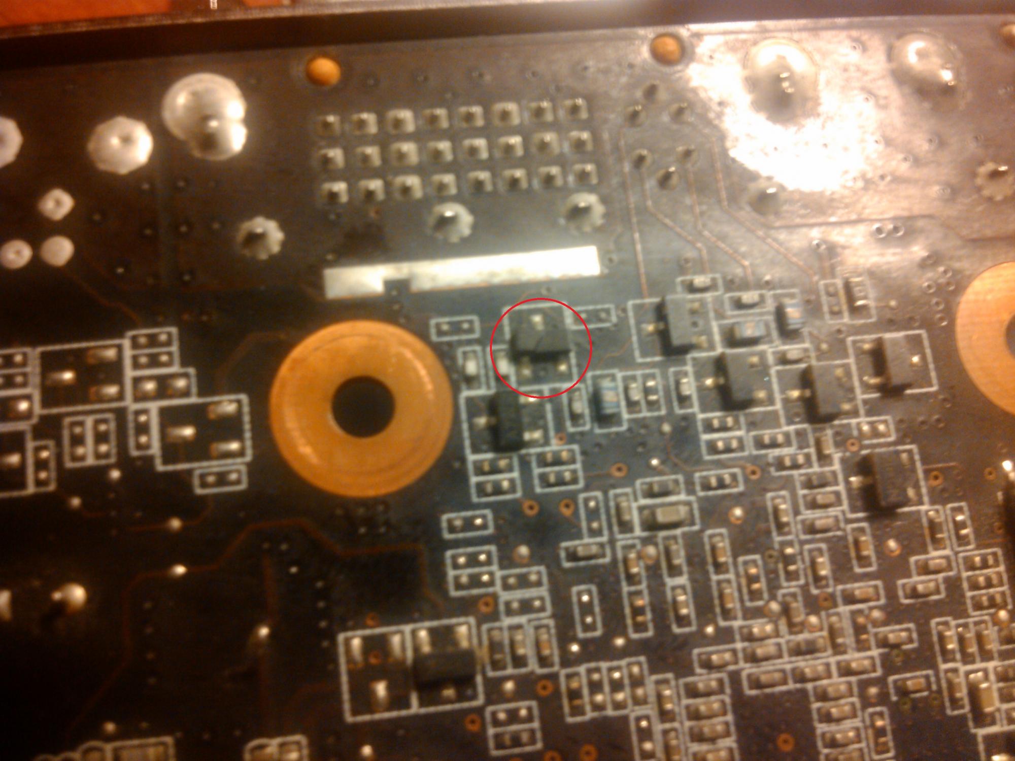

    Hello there.
    I just got this ASUS GTX 275 graphics card. It has one SMD component broken on the other side.
    Anyone know what can I use to replace this? It says A7W on it horizontally and 92 vertically.
    I couldn't get good picture of it, hopefully this is good enough to see the component.

    Here you go:
    http://www.digikey.ca/product-detail...5-1-ND/2209921

      Make sure to post results after replacement, would love to hear if it works or not. btw how did you break the component?

        Thank you. Well atleast it shows picture now. It has now horizontal lines going through the screen.
        Someone was giving this card away for free, he said that it has a component missing on the back of the card. I couldn't find anything missing, only this broken diode. Time for further investigations, I'm probably missing something...
