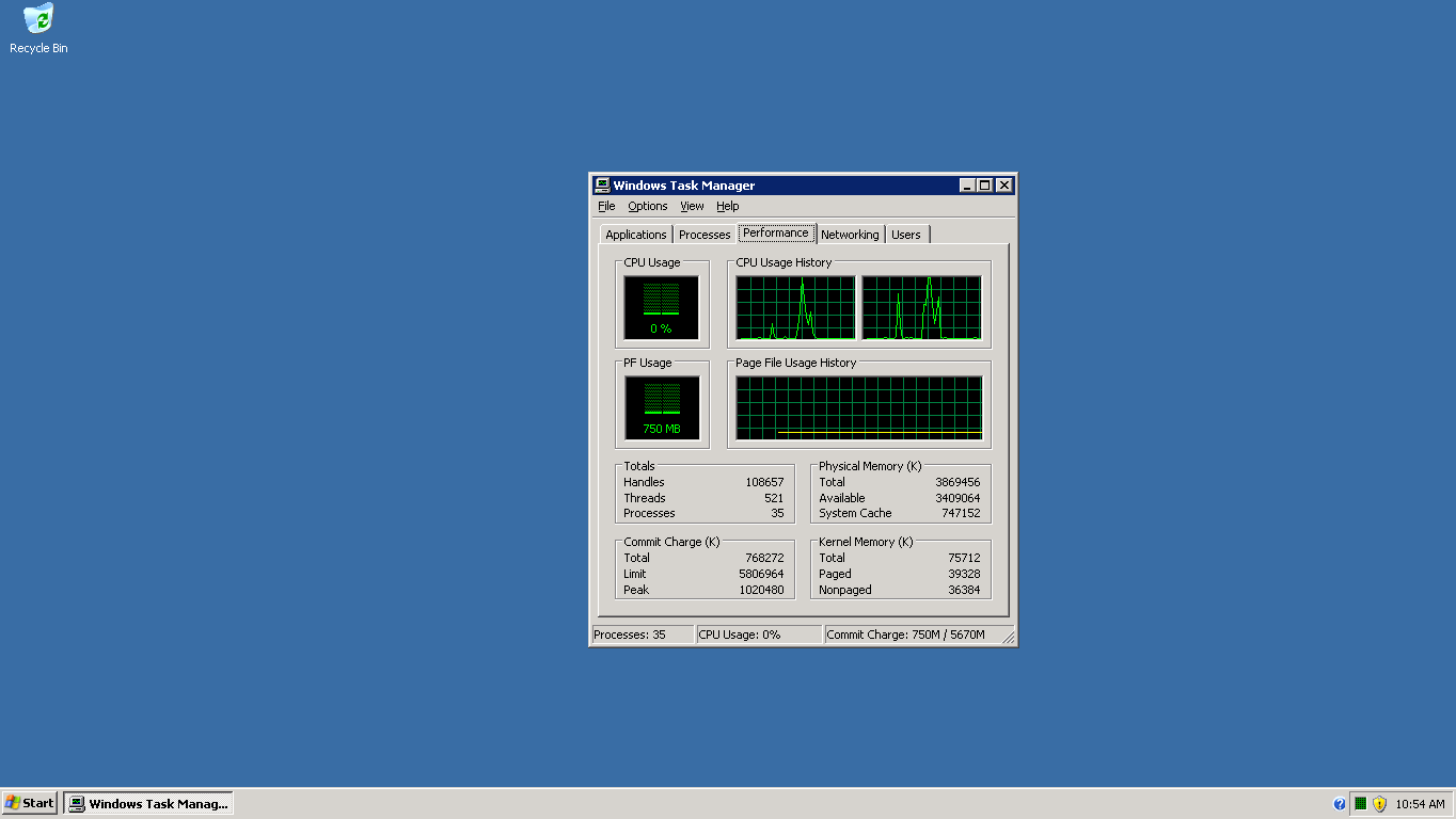

    I can't get a SINGLE operating system on this thing! We've spent the last week trying to!
    Specs:
    P4HT 3.06
    4GB RAM
    Motherboard from an HP dx2000 Microtower
    Promise Fastrak S150 TX4
    We've tried:
    -Windows Server 2003
    -CentOS 6.2
    -Debian
    -Ubuntu Server
    -Ubuntu
    -More I probably forgot...
    RAID configuration is two identical 160GB WD Caviar Blue drives in Mirrored RAID 1.
    Server 2003 does the first round of installing but after the reboot it won't boot from that (note that it worked once, but then we tried CentOS simply because, and now 2003 won't work again)
    Ubuntu Server gets errors partitioning
    Ubuntu normal can't install GRUB
    CentOS worked once but not again
    Debain was being a bitch
    VERY ANNOYING!
    Any ideas?

                    The DX2000 series are pretty common office machines, so unless it's broken (possible, they're not high quality), it's most likely the RAID controller.
                    Does it work without the RAID controller just using onboard SATA?
                    Is there a firmware update for the RAID controller and have you applied it?

                      I'm trying striped RAID right now... it's not the best for reliability but it'll give me extra capacity, and extra speed, and as proof of concept that the damn thing actually works
                      Edit: 2003 is installing just fine! yay!

                          Quick question does your raid card support booting?
                          You need raid card that supports booting from hard-drive and you'll need to enable "boot other devices" "int 13 option rom" or "boot from raid/scsi card" or something similar in the M/B bios.
                          It may install fine and then on reboot not be able to boot from drive.

                              Well ITS WORKING!
                              http://hardwareinsights.com/
                              HEHEHEHE I HAZ DEDICATED SEVRER!! :P
                              *excited*
                              The fine print: I don't trust it completely, given that it's striped RAID, so I'll backup weekly. That sure is an improvement over my previous backup scheme (every 3 months) lol!
