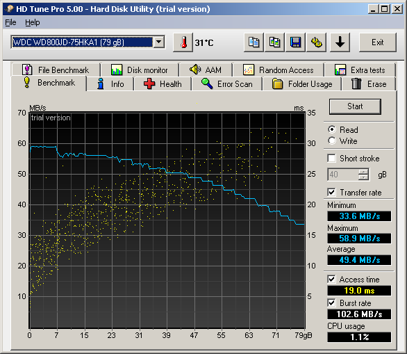

        Ah, better now.
        Avg.: 49.5MB/s
        O.D.: 59.6MB/s
        I.D.: 33.1MB/s
        Only got 0.2ms better access, though.

                                Okay, so I finally decided to disable AAM and measure again. That made things way better (the drive isn't a Black, but it's >4ms faster than before). And I still can't hear the drive in use. Now I actually think it's just as good as the 7200.7. AAM
                                Forget that I ever created this thread. It's not an awful drive at all.
