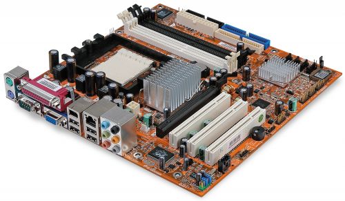

    nVidia nForce Pro 2200
    Is this part of the faulty nVidia chipsets?
    It's in a Dell PowerEdge T105.
    On a tiny little heatsink that I can burn my fingers on (OUCH!) so it's getting very hot...
    If it's indeed in the faulty range, I'm going to attach a fan.

    Re: nVidia nForce Pro 2200
    Dell T105 = Opteron 1200 series = Socket AM2 = defective. ALL socket AM2 and 775 nVidia chipsets were affected AFIK.
            Could a messed up nVidia chip cause the computer to shut off randomly?
            It did it once while browsng the web and once when I tried to get the WEI assessment.
            • c_hegge
              • Sep 2009
              • 5219
              The chipset could be overheating. Those tiny heat sinks that Hell like to use always get insanely hot, even on intel chipsets. I'd say add a fan to it and see what happens. If you have some big enough screws, you could screw a fan into the fins

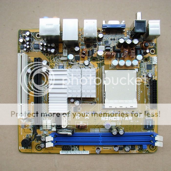

                            Originally posted by Scenic
                            That strange form factor is called DTX btw. Basically mini ITX with one more slot. (and in case of the board in the picture, a proprietary PSU connector)
                            FWIW, unless I chopped the wire from it, I have a loose pigtail to one of those... I got an ac-bell PSU with that for free which was parted out... it used standard wire colors so one could splice it to either a PSU or to a male ATX connector (to make an adapter).
                            sigpic
                            (Insert witty quote here)
                            • Scenic
                              o.O
                              • Sep 2007
                              • 2642
                              Or just buy one if you're lazy
                              • mockingbird
                                • Dec 2008
                                • 5488
                                DDR- 939 or 940
                                DDR2- AM2 or later
                                I repaired the PSU before even looking at the motherboard. The "M2N" gives it away ina cinch.
                                Thanks for that bit of info... I was wondering how to find the adapter for the miniaturized PSU connector... (There is no seperate P4 conector coming from the PSU - this means that I can't just use -ANY- ITX board, right?)... A sure bet mod for this particular system is to replace it with the Asus IPILP-AR Motherboard, which is the Intel equivalent of this board, and it would fit perfectly as it is meant to be used in the same chassis. But as long as it works as Shovenose says...
                                • ratdude747
                                  Black Sheep
                                  • Nov 2008
                                  • 17136
                                  look at the amperage specs on the PSU... if it is heavy enough on the 12v, then you can solder in a p4 pigtail to the PSU's PCB and chop off the existing mobo connector and splice in an ATX pigtail... both pigtails can be stolen from a dead junk PSU...
                                  sigpic
                                  • mockingbird
                                    • Dec 2008
                                    • 5488
                                    The PSU has three connectors. One is that small proprietary "DTX" connector, the other two are SATA power connectors. One for the CD, one for the HDD. Maybe a SATA power connector splitter? PSU is 160 Watts.
                                    • ratdude747
                                      Black Sheep
                                      • Nov 2008
                                      • 17136
                                      Let's try that again:
                                      Step 1. Look at the PSU's rating sticker and post what it says for the max amps for the 5v and 12v.
                                      (also note, Power = volts * amps if you want to find the rail wattage)
                                      --- after some experts have chimed in on what the psu can and cannot do-----
                                      step 2, if there is enough juice for a 12v based system (one with the 12v plug), proceed to step 3. otherwise, the PSU by itself cannot do the job
                                      step 3. locate a junk PSU and chop off the ATX pigtail and a the 12v pigtail at the junker's PCB
                                      step 4. at the PCB of the good PSU, locate the 12v rail and solder in the two 12V cables into an empty area on the rail. repeat for the 12V's two ground wires, using the ground rail.
                                      step 5. chop off the proprietary PSU connector and then splice in the ATX pigtail, matching the wire colors. use electrical tape or better yet, heat shrink to cover the solder joints (if you solder splice).
                                      step 6. test the PSU and verify that everything works and is stable.
                                      make sense?
