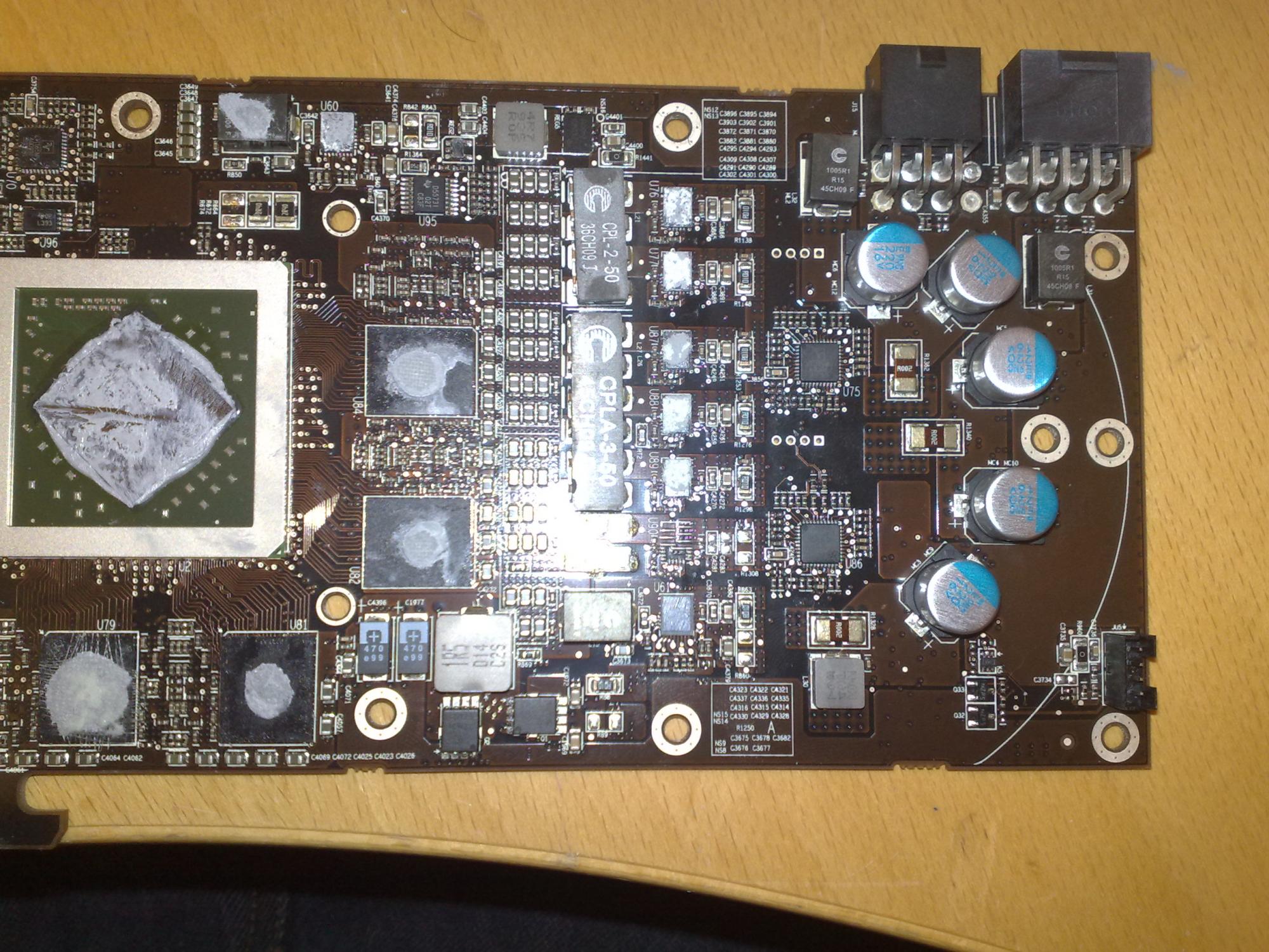

    Hello.
    I've been searching a bit on the net and there seemed to be a lot of people with with good technical insight on this forum, so I was wondering if anyone could help me with two faulty graphic cards that I purchased recently.
    So. I recently purchased two used Radeon 5970 cards for cheap.
    I was told by the previous owner that the cards had stopped working after his PSU had all of a sudden started sending out 16v on the 12v lane, causing his motherboard and both the graphic cards to stop working.
    He suggested that the problem was propably due to broken Volt Regulators on the cards and it shouldn't be too difficult to replace. I have a hot air station and have replaced mosfets and a few smds earlier, so I thought it wouldn't be too hard to replace the Vrm chips.
    When I received the cards I first tested the cards in my computer, to see what happened.
    The first card got no signal on the screen and the fan was running at 100%. But even though the card didn't output any signal, the computer continued to boot into windows, as if everything was working just fine
    The second card also did not output any video signal. This card however, the fan was running at stock speed. But here also, the computer continued to boot as if nothing was wrong.
    So, I dissassembled the cards, to see if there was anything visibly broken on the cards. But as far as I could see, nothing seemed broken.
    I then noticed these Vrm chips and they did not look at all like what I was expecting. I was expecting to see something like mosfets, or transistors or something, but in stead, there where nine tiny chips on the right side and at the top of the card.
    So I realise that I've propably gone in way over my head here and that these cards should propably be looked at by proffessionals, but I was just wondering, could it be as easy as to just replace these chips and the cards would be up and running again?
    Cause if so, then I think I should be able to replace them with my workstation as long as I can find the needed parts somewhere
    It's possible, but not highly likely.

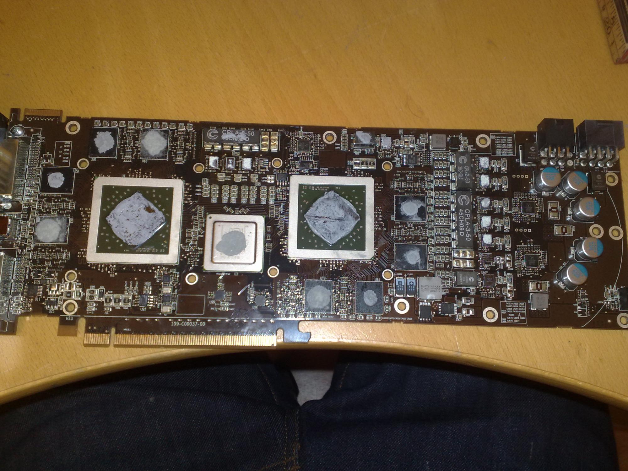

    Do you have a multimeter? If so, start checking the MOSFETs for short circuit between Source and Drain. Keep in mind that some MOSFETs may apart shorted due to surrounding components in the circuit.
    If you're not sure what I'm talking, just post some pictures of the cards here (use the "Manage Attachments" forum feature for that) and we can tell you what to check.

        I took some pictures of the card. I decided to start of with the card which had the fan at stock speed.

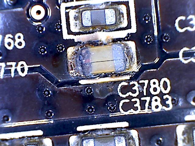

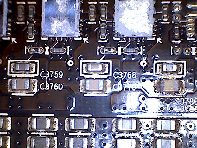

        When I looked over the card, I noticed that one of the components (I think it is a capacitor) looked a little dirty, so I used my cheapo usb microscope to get a clooser look at it. As you can see in the pictures that I have included, the capacitor on the right side, had a thine "line", running across it. I tried to pick at it with a tweezer, to see if it was just a piece of hair, or something else, that had been placed on the component. But when I picked on it with my tweezer, I discovered that it was in fact a small crack.
        So, I tested these three capacitors, or components, using the diode function on the multimeter.
        Using the positive probe from the multimeter on the left side of each component, I got these readings. Starting from the left: 0.648v, 0.000v, 0.217v.
        I compared these readings with the other card. On the other card I got these readings. Starting from the left: 0.669v, 0.669v, 0.702v.
        Could this mean that the voltage regulators for the two capacitors which had different readings are broken?
        And could this also mean that the Gpu's could have gotten too high voltage, causing a short inside the gpu?

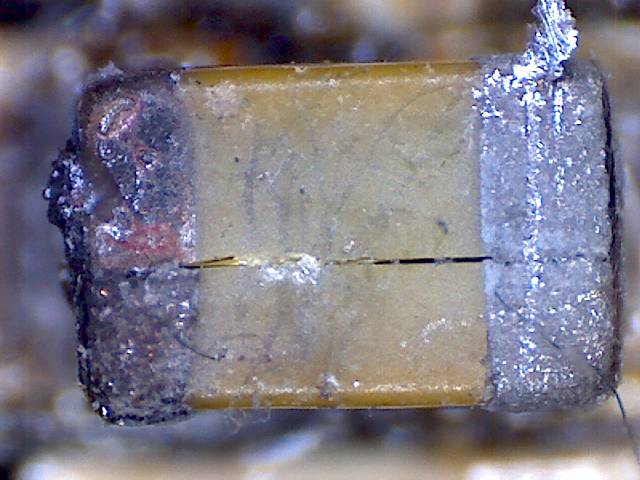

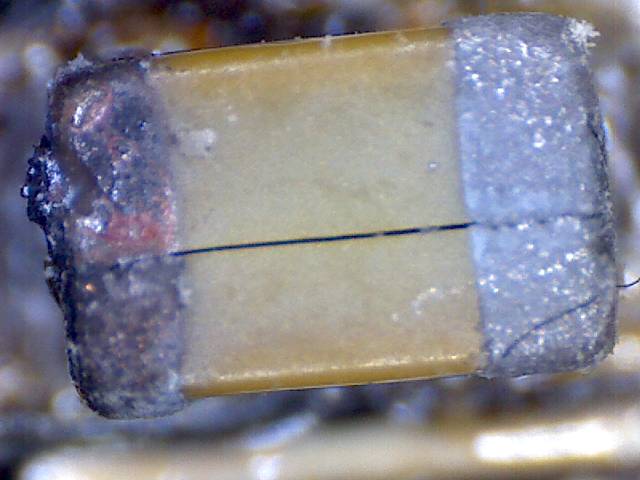

          That ceramic capacitor is indeed bad. Ceramic capacitors tend to go short circuit when they go bad. Remove it from the board.

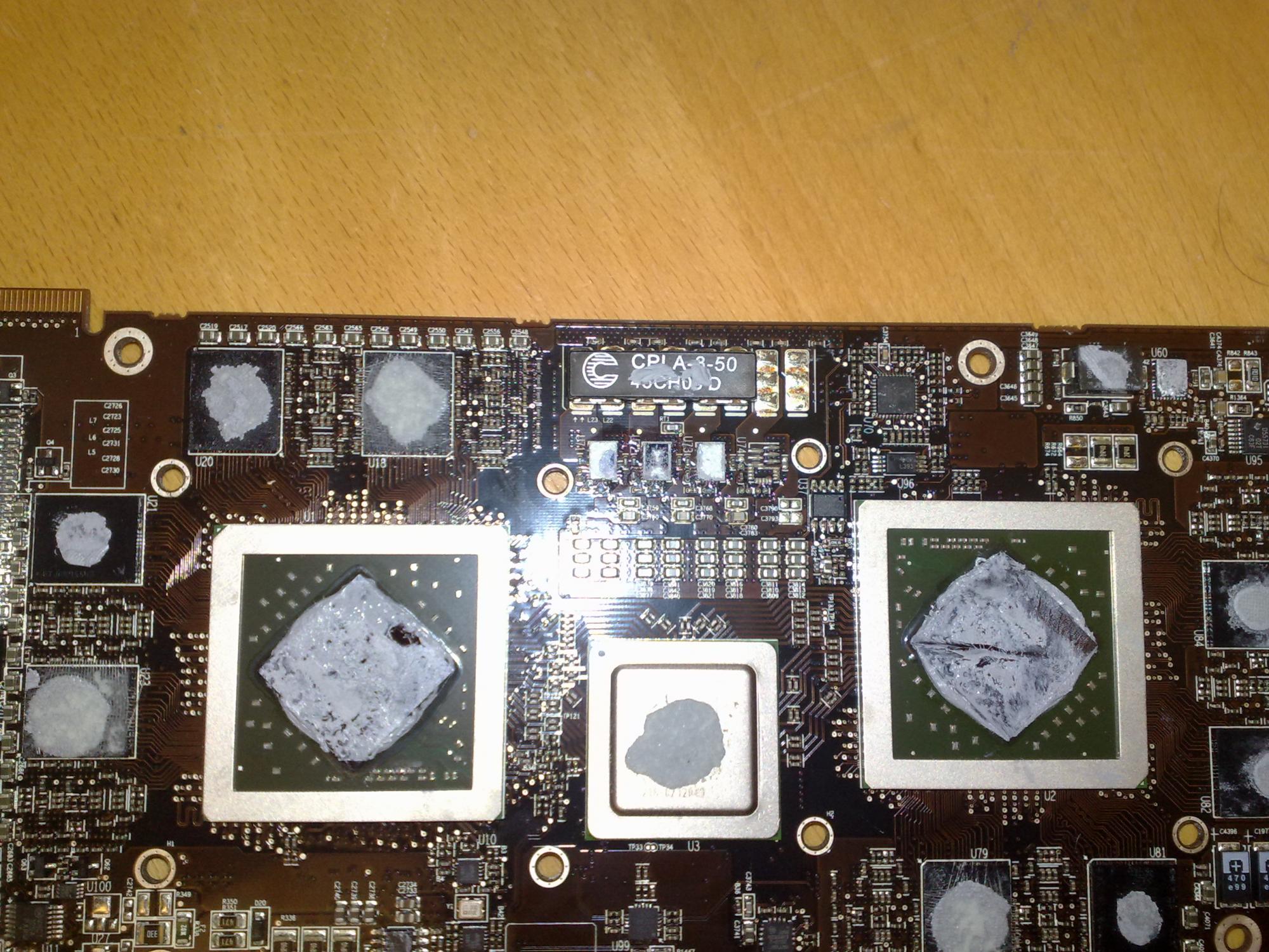

          Looks like the middle and rightmost ceramic capacitors are bad. However, these may not be the only bad ceramic capacitors on those rails. If you look above them, you will see other smaller tan-colored ceramic capacitors - those can be bad too.
          What to do: remove the ceramic capacitors that are showing 0.000v and 0.217v. The use the diode test function on your multimeter again to check the spots where those ceramic capacitors were located. If you still get the same readings, then you haven't found the shorted capacitor(s) yet. In that case, keep looking with your multimeter for capacitors that show the same 0.000v and 0.217v readings. Once you find all (or as many as you can) capacitors like that, see which ones look the most dodgy and burned and remove them.
          Also, don't throw away the capacitors you remove yet. Check them with your multimeter on diode test function instead. If they show open-circuit (multimeter acts as if you have nothing connected across its test leads), then the ceramic cap in question is likely fine.
          Can't tell from the measurements you did. First remove the ceramic capacitors that appear shorted, then we will see.
