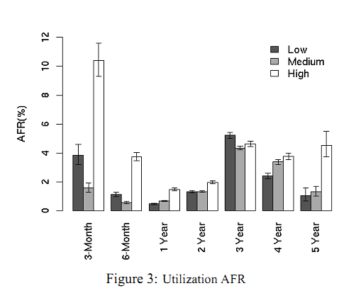

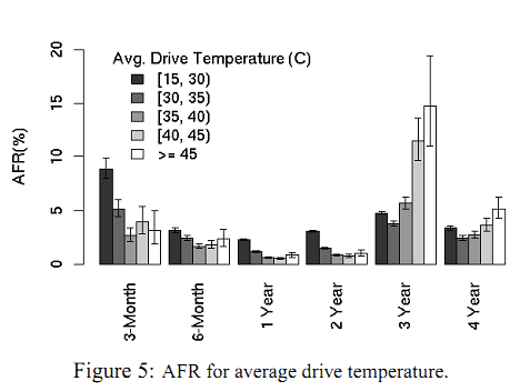

                                    IMHO the difference is pretty much only in price.
                                    As the Google's hdd failure study showed ( ) if the drive survives the first 3 months, chances are it will work just great for up to 2 years, after that it's pretty much an 8% average failure rates.
                                    So even a 3 year warranty is enough - if a drive will fail, it will fail before 3 years and you pretty much replace the drives anyway in 5 years - 5 years ago I had 80-200GB drives, now I have 1 x 1 TB drive and 2 x 2 TB drives in my system.
                                    Slightly offtopic... interestingly enough, they also showed that statistically, at the beginning the drives have more chance of dying if they're cold. If they survive the first months, they pretty much don't care as long as the drives are at less than 45C - more than this and the failure rates goes up a lot:
                                    Oh and an interesting conclusion... once you get a smart error (reallocation etc) they say drives tend to fall within 60 days (increased errors and so on up to complete death)...
