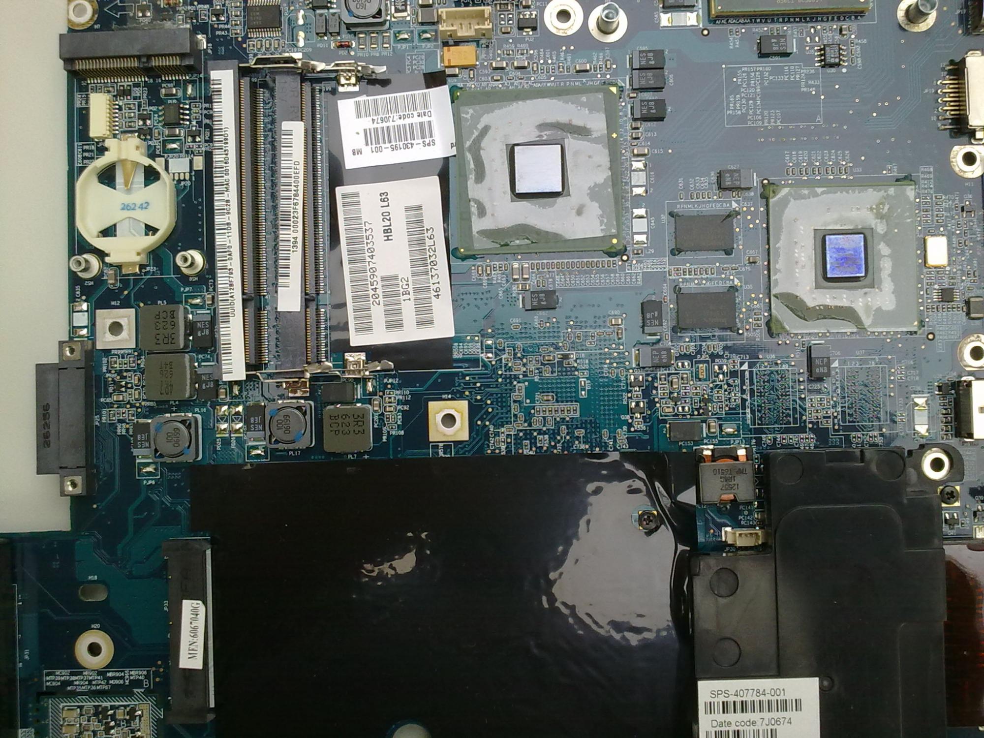

    Got this HP that won't post boot, power led continues to flash while holding the F10 key down, fan spins up for a few seconds.
    I tried reset boot, tried also removing CTR battery, battery is good, tried with external monitor and no post screen!
    Was reading some simular senarios and sounds like it could be the thermal paste on the CPU that needs replacing?? Anyone heard of this before?

    how far does it go?, if it shuts down within a few seconds then you have a hardware problem, remove everything ie battery, ram,hdd,dvd drive, wireless card and make sure nothing is plugged into the usb's, then try booting, if it goes then put back the items one bit at a time until it locks up, with your ram i would try a totally different known working stick as you could have both sticks faulty (if you have 2 sticks)

      Just tried it without wireless card, dvd drive and HDD, with and without memory still the same power led flashing.
      The sticker says its got a nvidia video card or is this built into the MB?

          HP Pavilion or the other model that have a nvidia or ati chips common problem is overheating. So the north bridge chip or nvidia/ati chip or both contacts are cracked, oxidised and etc.
          It might be that reflow or reballing of the chips would help to fix this computer.
          I have done reflow for 4 laptops with nvidia and ati chips Packard Bell Minos, HP DV9000, HP DV5 and one of the Asus (cannot remember model). All 4 are working ok now. Still in testing stage for couple weeks but no problems at them moment.
          If reflow done properly it is still not the best option. Reballing holds 6 months or longer.
          Before trying to do one of the mentioned things, try to check all parts. Some of the laptops with blinking lights have problems with ram, try to change into good working ram. Also check contacts in mainboard, try to clean with spirit or other solution sometimes it can help, never know.

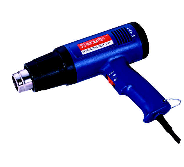

                    The "hair dryer" in those videos is probably a heat gun. A hair dryer doesn't output a high enough temperature to fix the issue.

                      hair dryer:
                      heat gun:
                      heat guns have a bare metal tip... hair dryers do not (plastic or painted metal)

                        You're right it was a heat gun, the hair dryer was a comic about the Nvidia chip problem. I gave it shot yesturday with a heat gun running at around 250 - 300c for 5 minits put it together and still nothing to brag about.

                                  Went ahead with flux twice today and nothing has changed!!
                                  Even borrowed another good heat gun that I tested on another scrap board and removed a chip within 4 minits at 200c. I then tried it out on Hp board for a 5 minits moving 360 all the time.
                                  I am begining to think that the video chip is fried and useless even after reballing, by the way gpu/nb is the Nvidia video chip right??

                                    Added this photo incase some thing has been missed.

                                        How many times can one heat these boards, I tried with flux and without but I think this problem goes further than just the chip or should we scrap it, any feed back appreciated
