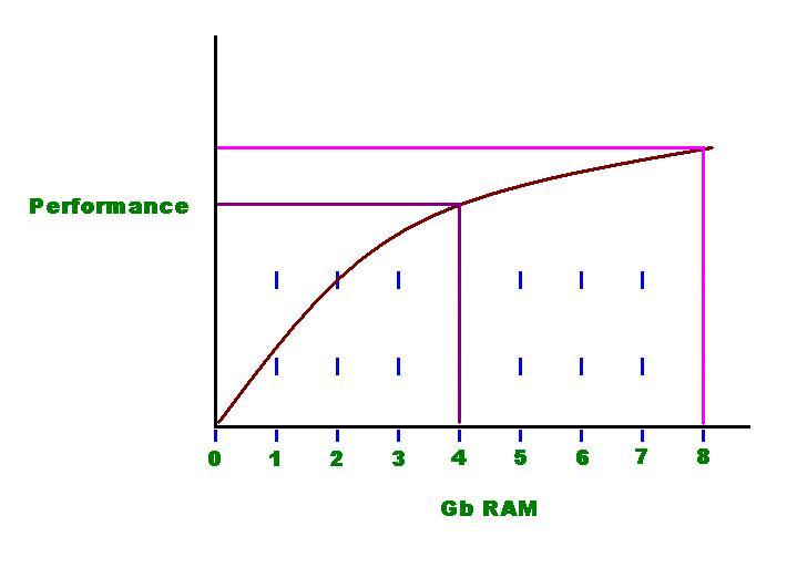

    More memory or less memory than speed?
    On a computer with i3 core to 3.2 that comes with 4 GB of DDR3 1333Mhz, if memory conbined with other 4 modules of 1024Mhz, the bus goes to work at 1024Mhz ... the difference is very noticeable in performance or is it better to have 4 gigs of ram to 1333 rather than 1024? thank you very much

    Re: More memory or less memory than speed?
    It is slowing down to reduce loading on the RAM BUS and RAM Power.
    Which is better depends of what you do with it.
    For most people 4GB is more than they actually use anyway.
    If you have a 32-bit OS then it won't use more than 4GB even if you have it.
    If you are not a gamer and you don't do CAD or some kind of graphics processing then 4GB is enough. [Probably more than enough.]
    I would choose the 4GB at 1333MHz.
    If you want more then use 4 x 2GB modules.
    Fewer -modules- will reduce the load and it -might- even run at 1333 that way.
              Originally posted by patriciopat
              So which is faster A1064 8 gigs of ram or 4 gigs of ram to 1333? I refer to levels of performance, and if you would notice a lot ... the OS is MacosX ... thank you very much friends
              Like I said before, that depends on what you do with it..
              If you are an average user then you probably don't -actually- use more than about 2 GB of RAM anyway and the 1333MHz would be faster.
              I've attached a typical RAM vs Performance Curve.
              That extra 4GB will probably gain less than the lower speed will loose.
              - But as said by 3 people now,, it depends on what you do [apps] on the PC.
