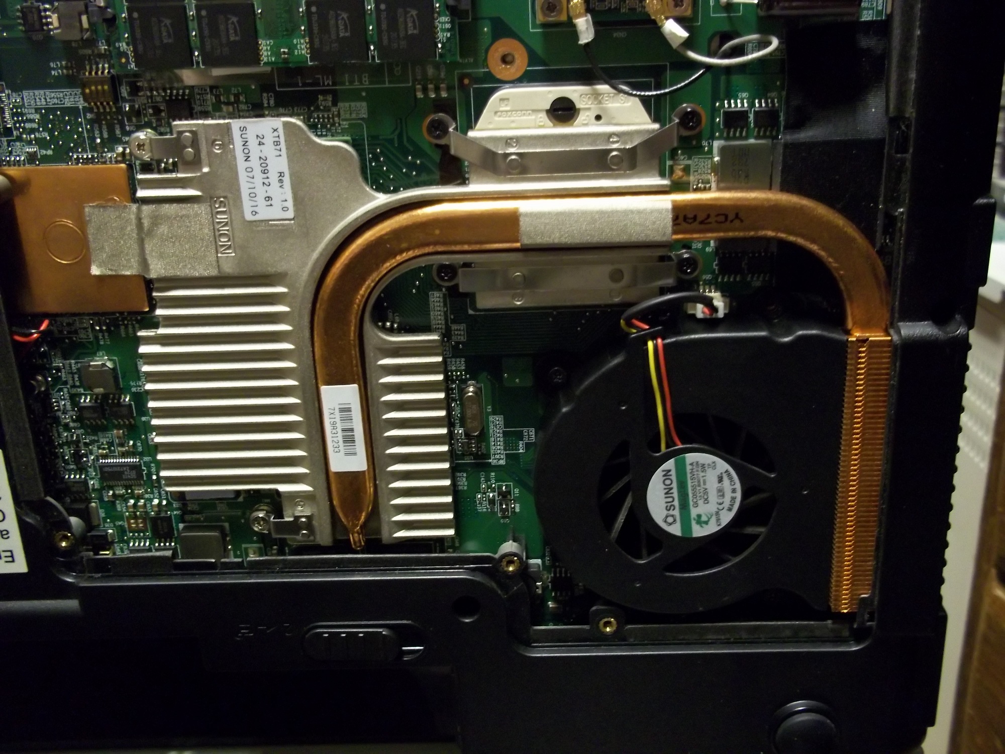

    My laptop is sucidial.
    Everex Stepnote xt5300t
    CPU: AMD Athlon 64 X2 TK-53 Dual core 1.7GHZ
    GPU: Nvidia 8600M GS.
    In this photo my laptop is on and running opensuse. This fan will not start spinning until the laptop is on fire. It does the same thing in windows if I set it to powersave or balanced. This thing kicks on and off like an air conditioner. It's annoying I just want it on all the time.
    I can't use speedfan or sensors to control the fan, it's not detected.
    Bios doesn't have anything useful, very limited. Also Manufacturer went out of business, and US version of the website is no longer around, meaning no bios update.
    I've re-did the thermal paste about year ago and used Artic silver 5 both on gpu and cpu, it helped some. I can use it with little discomfort at idle but when I'm doing intensive stuff on it, it starts burning my leg.
    Thing runs hot, cpu idles around 50 Celsius and that's at 800mhz. When everything is full load it can get up 70 easily and GPU can hit 90, before the fan starts going full rev.
    The problem is not the heat transfer from the processors but the lack dissipation due to the fan not running.
    Let's mod this bitch.
    I think this fan is controlled by voltage and not by PWM.
    I would like to make something that amplifies the voltage enough to make the fan spin but still in control of the system.
    I don't have alot of knowledge on how to make something that complicated, but would be grateful if the badcaps community came together to assist me in this crusade against my laptop, who's with me?!

    nVidia graphics. Run the fan full speed all the time.

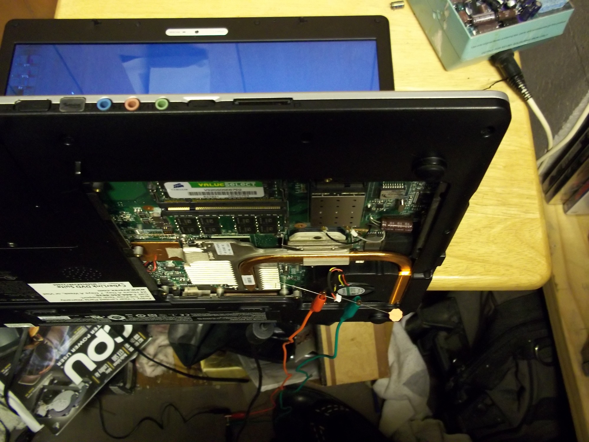

      Experimented with it using a adjustable 1.5v-12v power adapter. The Fan is 5v 1.7W, I set the adapter to 4.5v. The sound doesn't both me that much, so I guess I just wire it to 5v source.
      I just need to find a place that supplies 5v but won't blow the fuse or fry the board. USB jacks are near by, I think I can solder on some wire and tap into the 5v there?
      The only problem is 1.7W / 5v = 0.34 amps 340mA
      Isn't the USB power specification 500mA max?
      Safe?
      or should I wire it to the sata/power plug in the hard-drive bay? Harder to get to.
      If usb, anyone know what the pin out is for the USB receptacle?

        Yeah. USB is 5v 500mA. It will be fine for the fan, but don't use the port you connect the fan to or you might draw more (unless it's through a powered hub).
        http://pinouts.ws/usb-pinout.html - USB Pinouts
