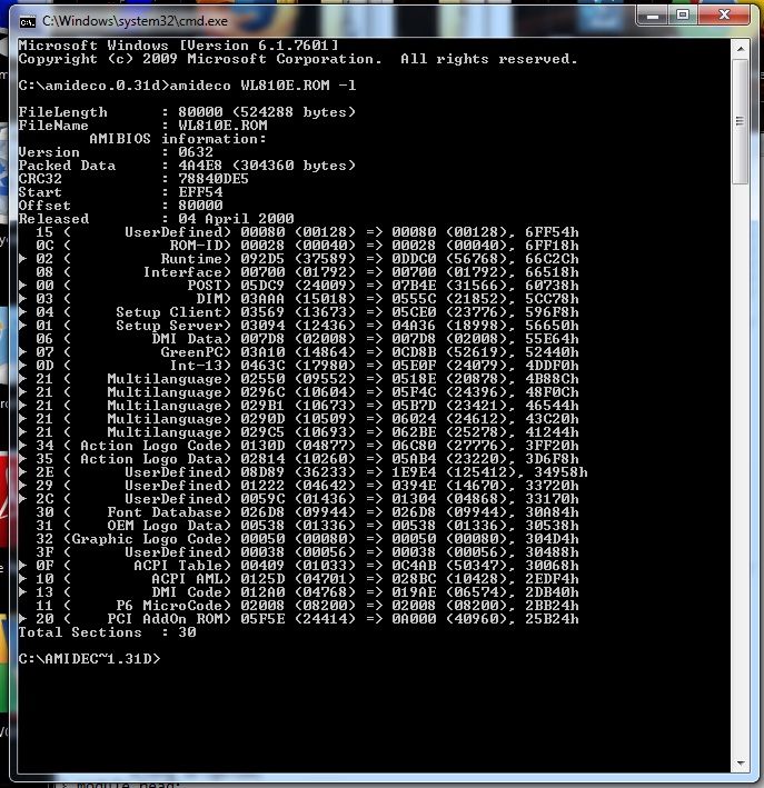

                                  • mahkeymike
                                    • 10
                                    Re: Successful P4 478 OEM Gateway to retail Intel bios flash...
                                    Originally posted by Digital Technophile
                                    I remember AMIBCP can corrupt certain BIOSes and the BIOS is more likely using some sort of compression. Sorry it's been a while since I did anything with BIOS modding and lost all my stuff, I'd try looking around Rebels Haven forum. There are some pretty in depth threads dealing with all kinds of BIOS and applications.
                                    I havent even got that far.I cant find any tool to open/edit even the straight dump from the chip.
                                    Here is the bios image from dumping the chip on a willem programmer.
                                    Maybe someone can find a tool that works.
                                    BTW, the dump is good, i reflashed it to a spare chip and it worked fine in the board.
                                      Cant seem to let this mobo R.I.P Was able to see and decompress contents with AMIdeco but now cant figure out what file is OEM logo.
                                      If you look you will see "OEM LOGO data" but this file when extracted is 1KB in size.
