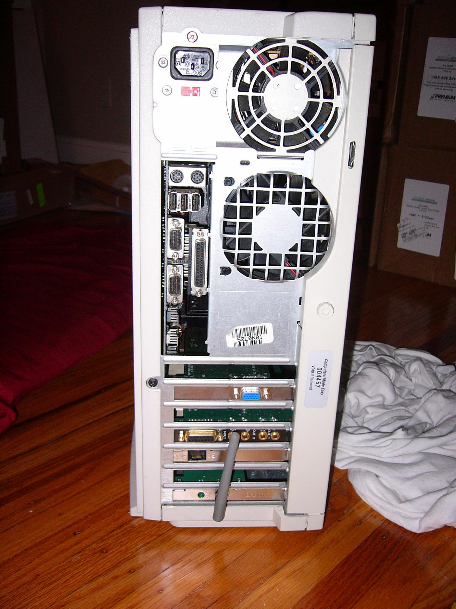

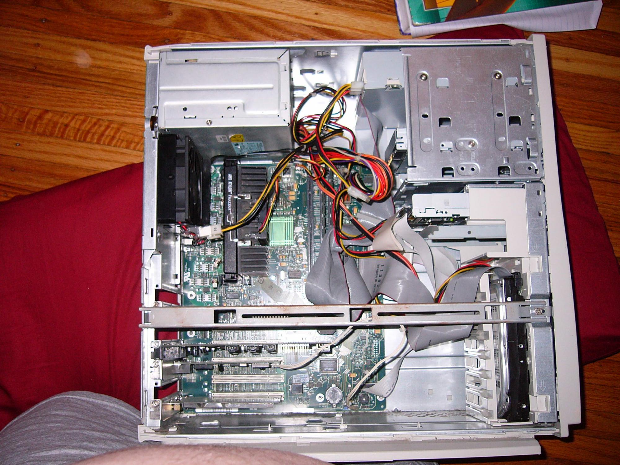

      ok... i took a look at it. it still has the overkill 300w unit in there... and only 256mb ram. likely another case of 256mb cuts it.
      i snared some pics... that way we can compare boards and if yours is the same, you have some ideas on what they are good for.

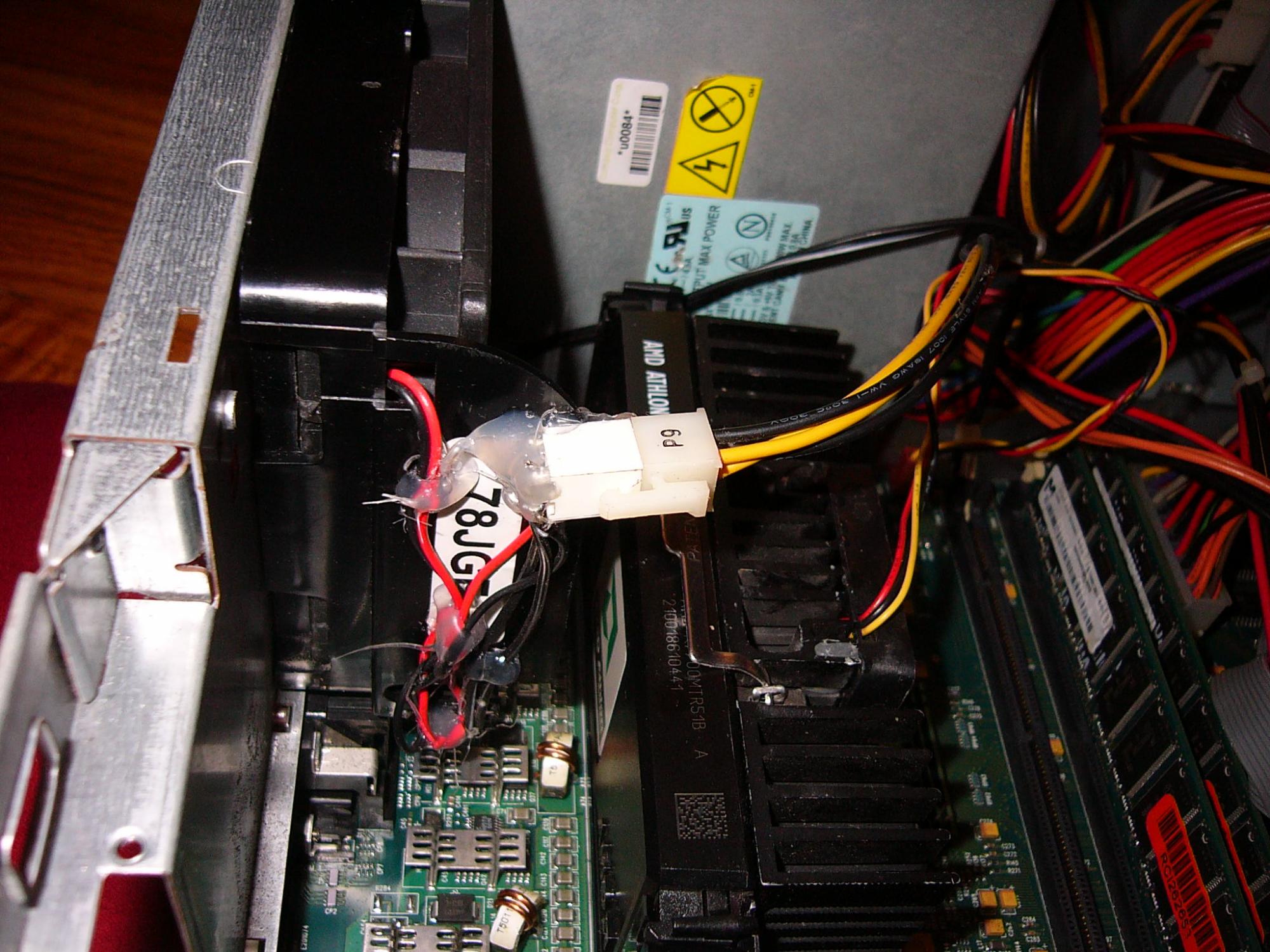

      my main use for it was a computer for the garage. it does light to medium web browsing well, does email well, and was good for messing with xubuntu. mine was tweaked... it has hard to find ndiswrapper drivers for the TI wifi chip pre-loaded and it also is tweaked to be able to use gnome wigets (for palm sync, mainly).
      good luck with your find!
      edit- mine is the 700mhz, but exact same board. very nice board... it uses the same pinouts as intel did back then (jabil made intel's boards around that time), so it is a good drop in for OEM cases with stripped out boards, like i did.
      good score!

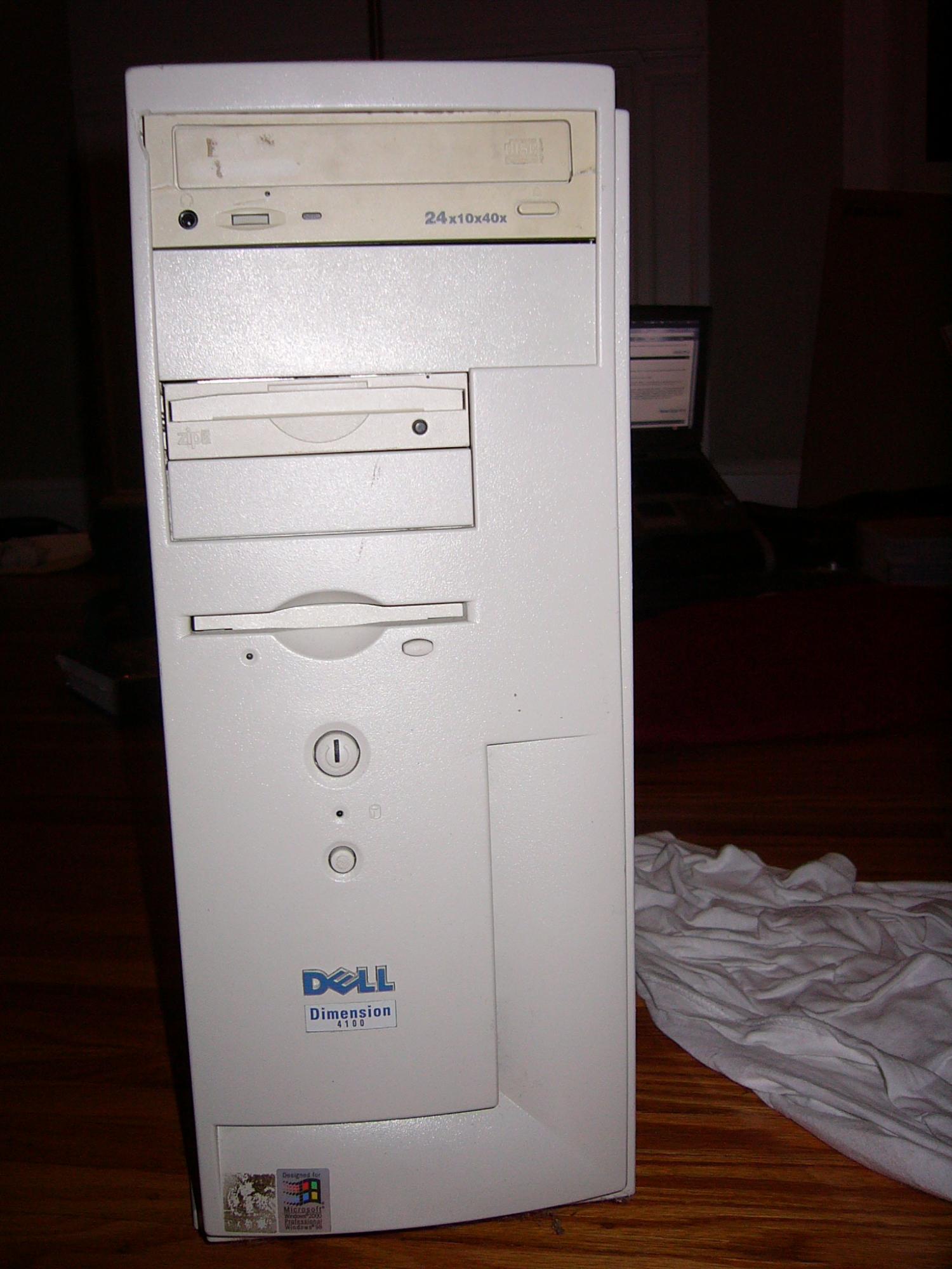

            no handy reset switch. not a biggie, but i care... the dell 4100 had one though... always nice.

              Looks like an Intel LX motherboard. Fastest processors are the 66mhz FSB Celeron Tualatins. 733mhz IIRC. I don't know that I'd spend that kind of effort like you did. Nice job though.

                its AMD slot A. it is exceptionally nice, as it has both amd north and south, amd has NO eletrolytic caps. runs xubuntu reasonably. nice board for the era.
                gateway did use LX boards... they did have some nichicon pm's and that was it.

                  Ah, I didn't see yours, I was talking about his. Still, nice system, all tantalum caps. His also has some tantalum caps but his VRM looks like gigantic UCC LXZ.
                  Do you have the place for the goldfinger on your Athlon?

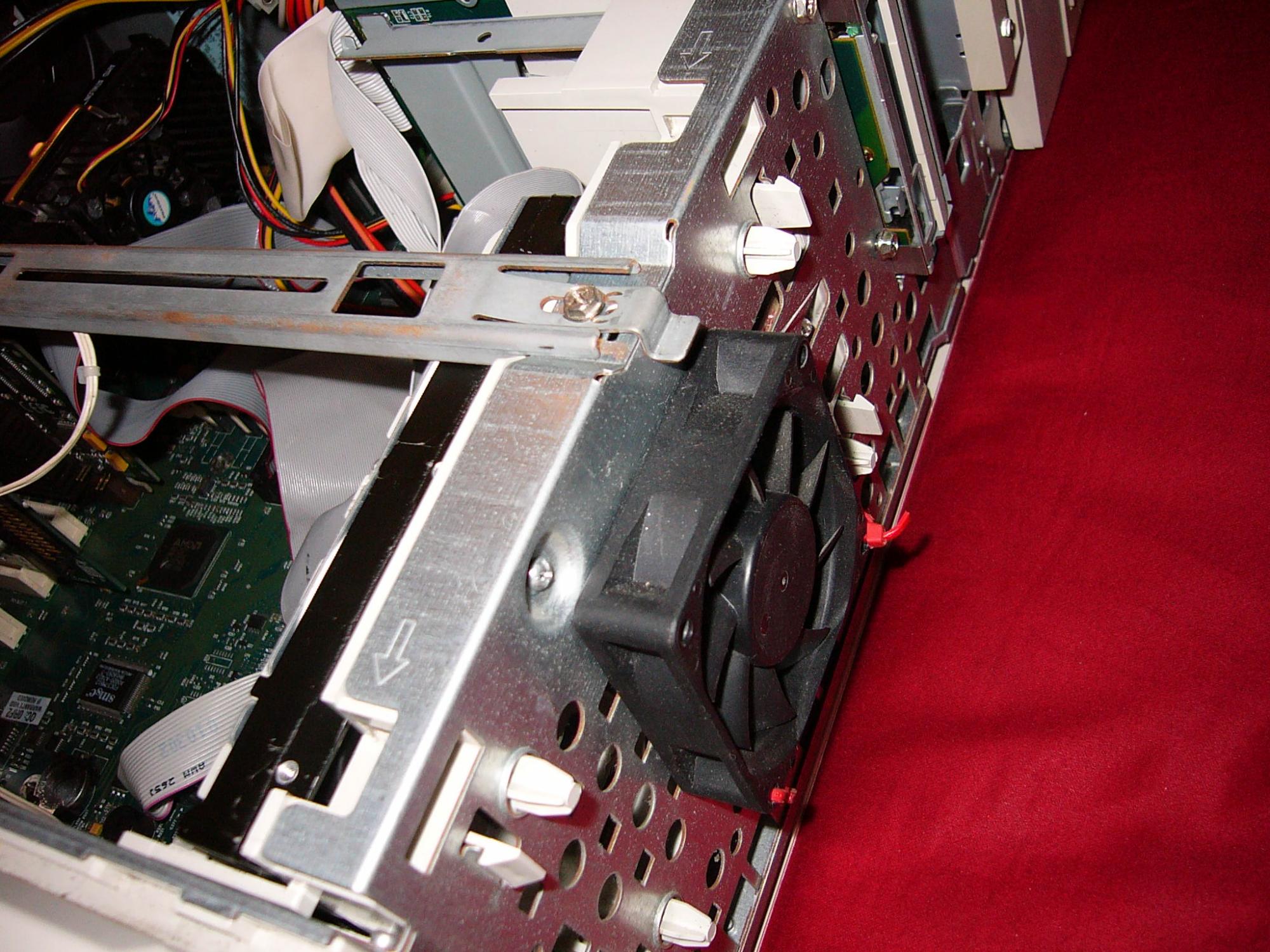

                      That old Dell case is generic, I saw it used by one other maker.
                      1. This takes microATX and ATX boards.
                      2. Case can take standard ATX PSU up to 500W as long as the length of PSU is standard.
                      How I know? I had one. Nice and slim. As long as you have drive brackets especially the HD bracket for bottom mount under the floppy drive cage.
                      Second, it needs 4 long screws to mount second hard drive where that fan is. Mine were missing.
                      Cheers, Wizard

                        yeah, i know... got a micron pII unit with the same case. it was broken... bezel taped on. i scavenged a cross brace and the hardware for the bottom hd mount. i also got a better set of long screws for the fanned hd area (the dell was originally missing one of the two).
                        i agree they are not bad cases... not to mention the cdrom bays coue out as a unit as well.
                        i had already dremeled the existing fan holder so i did not use the more standard one in the micron.

                          Cross brace? Where it hooks together at both ends?
                          Mine was not there and wasn't a issue. Re: Micron; I was trying to put finger on what name it was, that was it!

                            it goes from front to back...crosses the edge of the hard drive. it is a non-issue but i figured why not.
                            better than the one the old gateway case had- now that i remember, thats why i hated the case so much. the crossbar (brace, whatever) was a PITA to remove and it was necessary for the case to work. it blocked cards and the hard drives, but was needed to support the large 120mm cpu fan. beastly but such a pain. the only fix would be a standard cooler, which i did (and then i got the 4100 case as a freebie, did some research on pinouts, discovered it would match, and swapped the boards)
