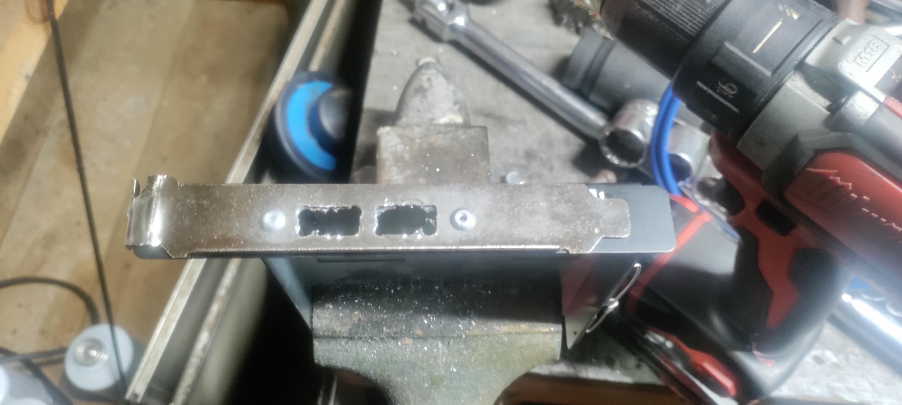

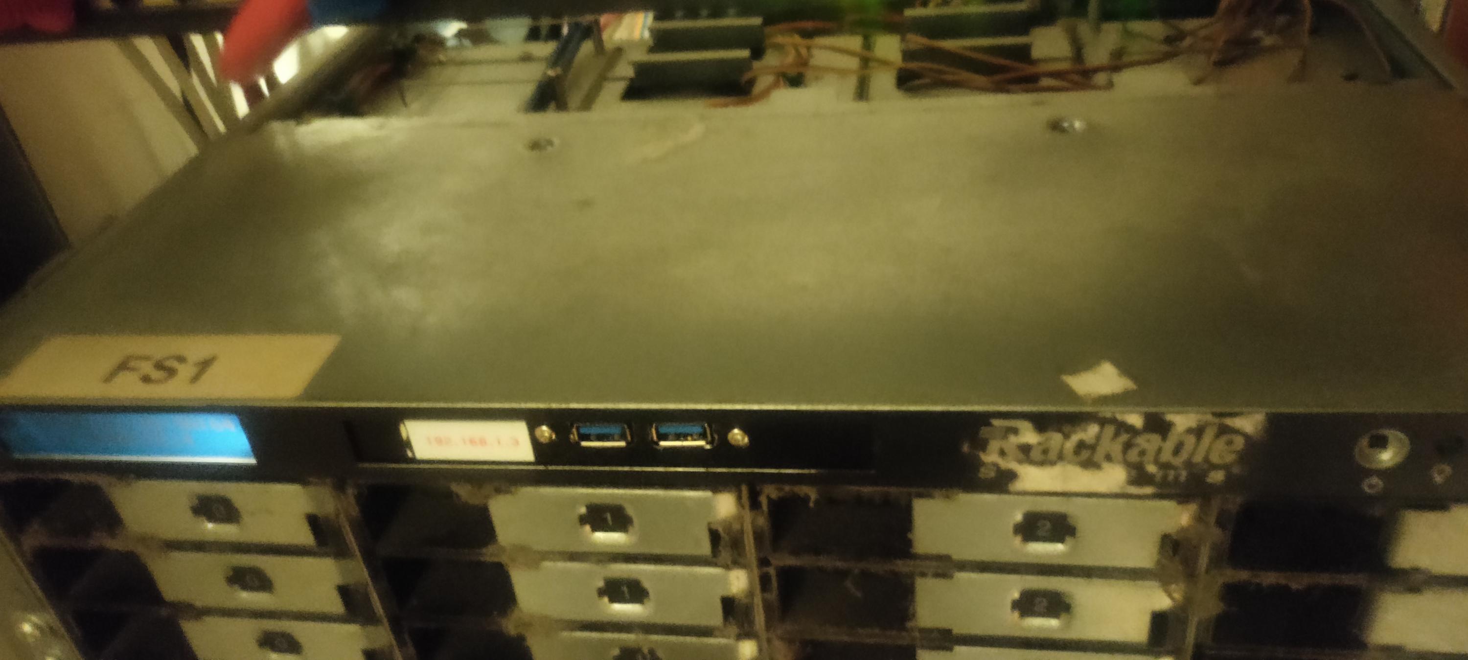

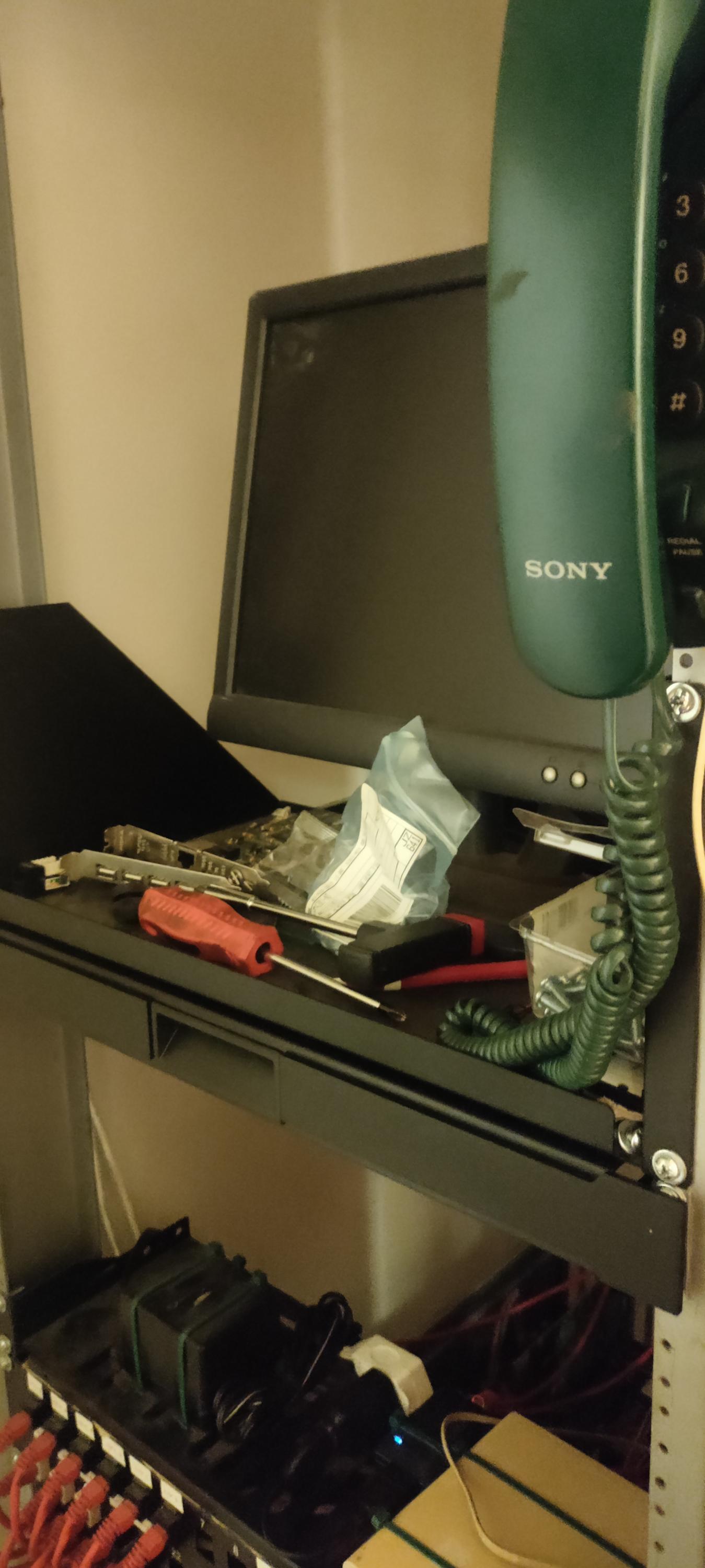

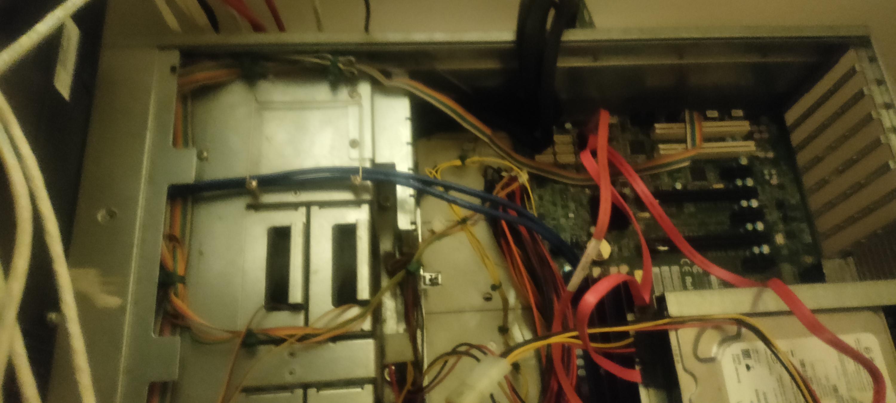

              Pics:

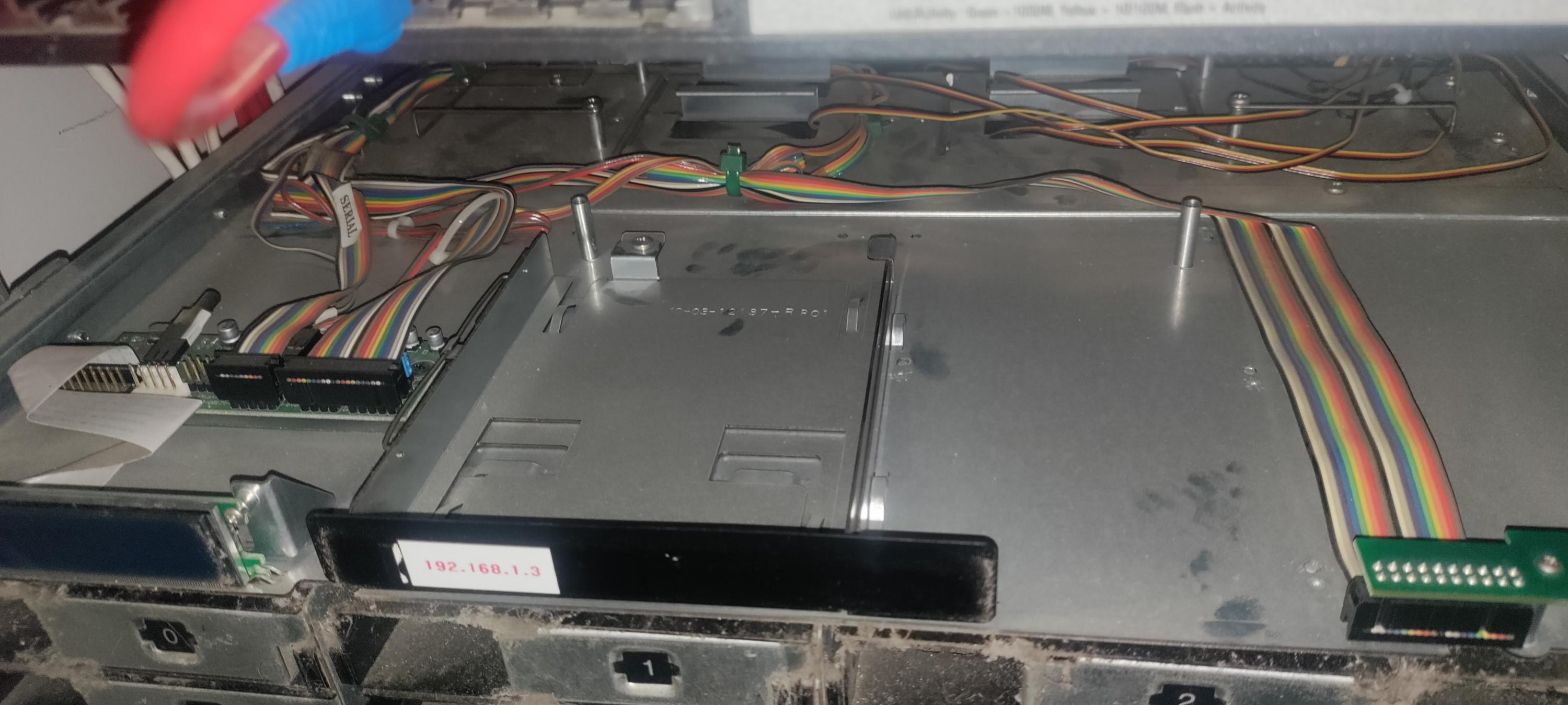

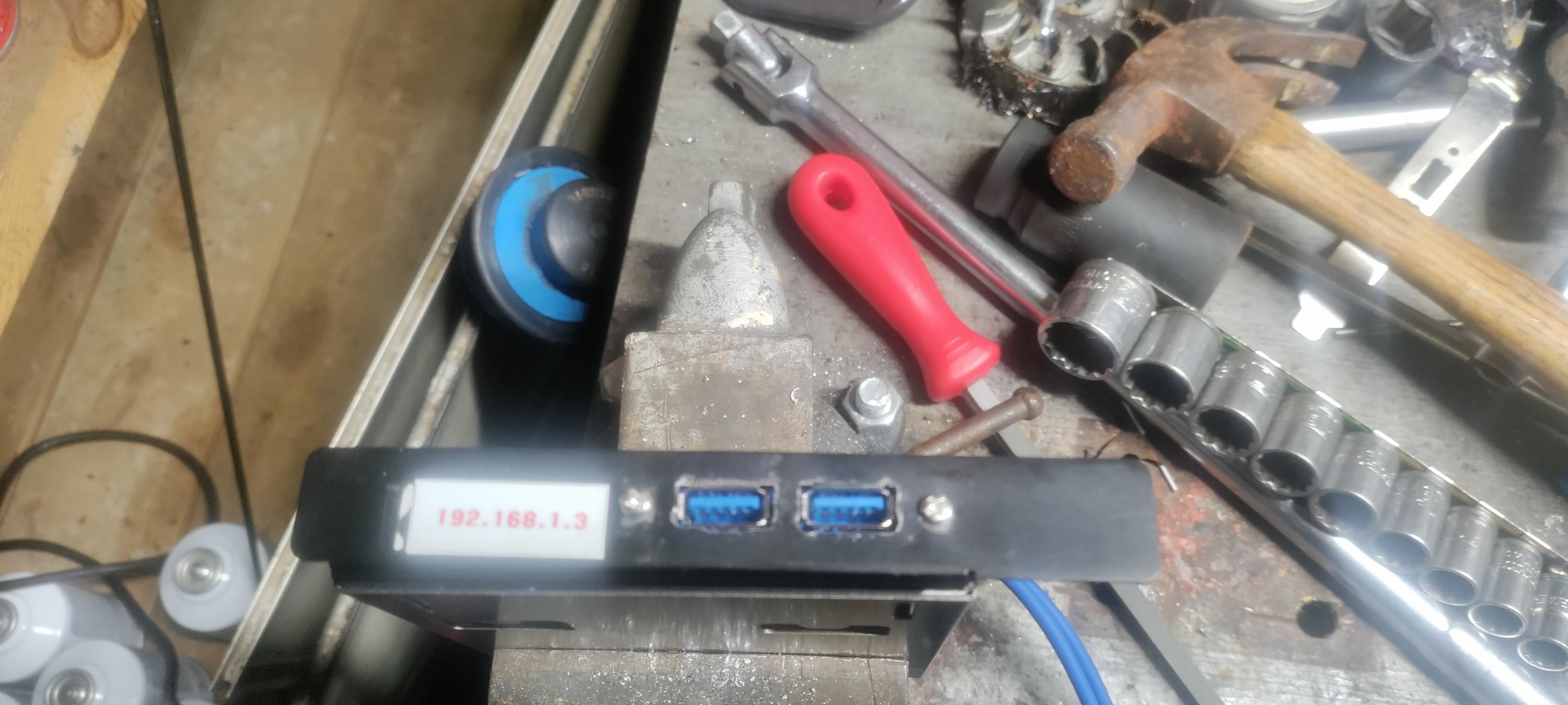

              I did a bit of case modding to bring it up a decade... Drilled out a slim floppy/DVD filler into a set of front USB3 ports:
              I ordered header cards for this. Sure, I could have saved a couple bux and ordered just headers, but the brackets can be used as templates for drilling/filing the holes. I flattened the bracket (and bend a new tab for spacing reasons), then match drilled and riveted it to the filler to allow for drilling and filing the holes for the ports themselves:
              (Yeah my bench is a mess... like I was saying about being busy and zombified)
              Once done, I then drilled out the rivets and...
              (yeah the picture quality is potato )
              Installed:

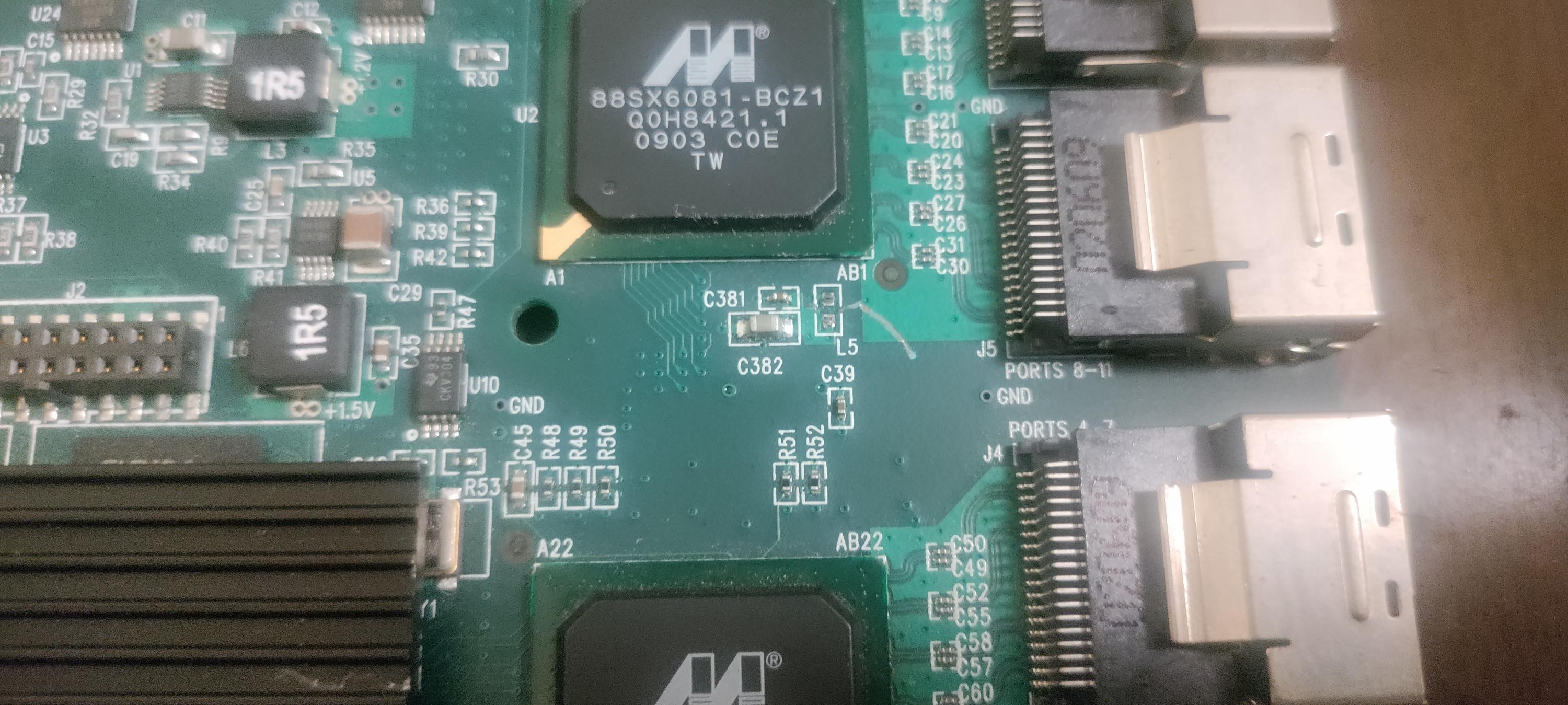

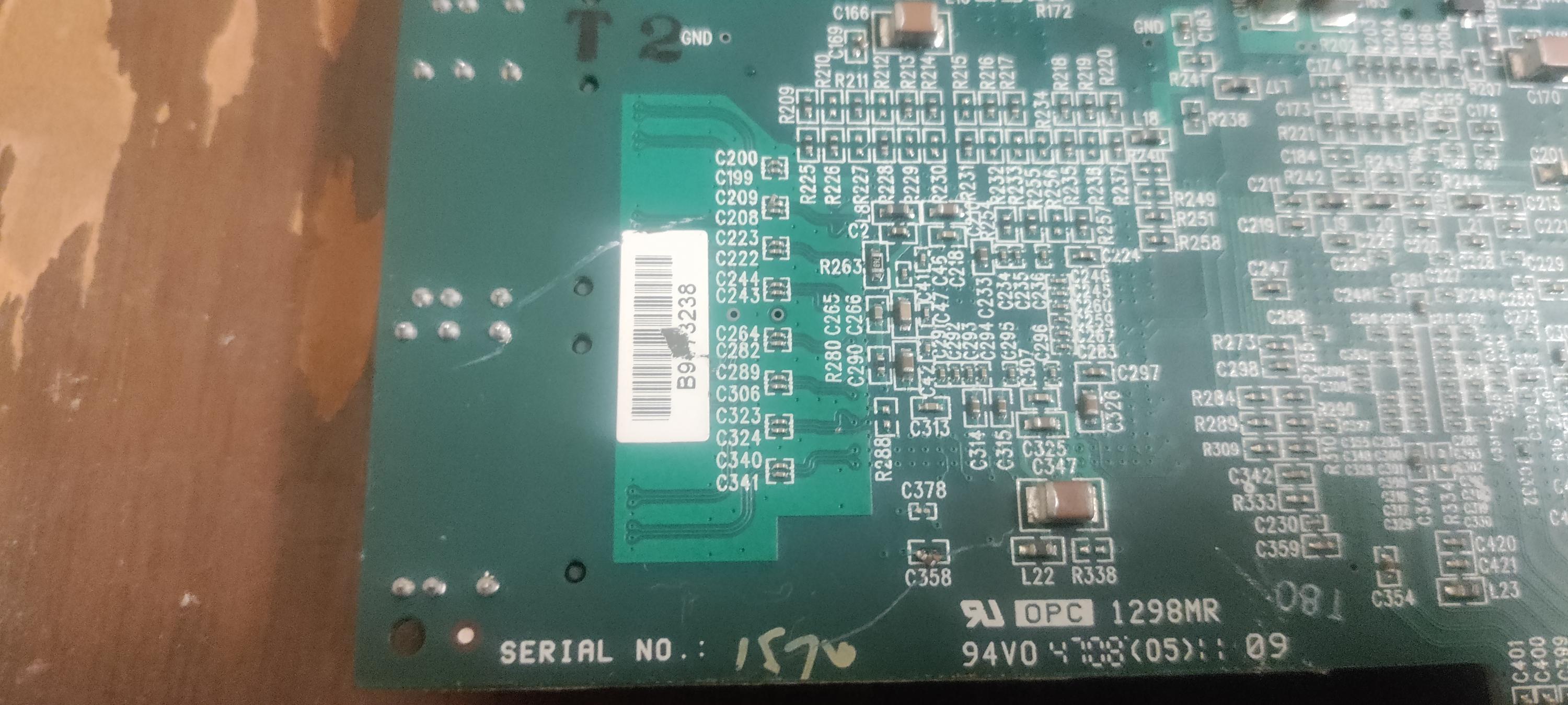

              Pics of the trashed 3ware card I'm sending back for a refund:
              I guess by "tested", they meant "it POSTed". As only 8 of the 16 ports were working and I have a bad feeling it may have fried the two bad drives (as they didn't come up as failed with a bad config/head clicking until after trying this card). Yes I did pull the drive boards and clean the contacts... no bueno.

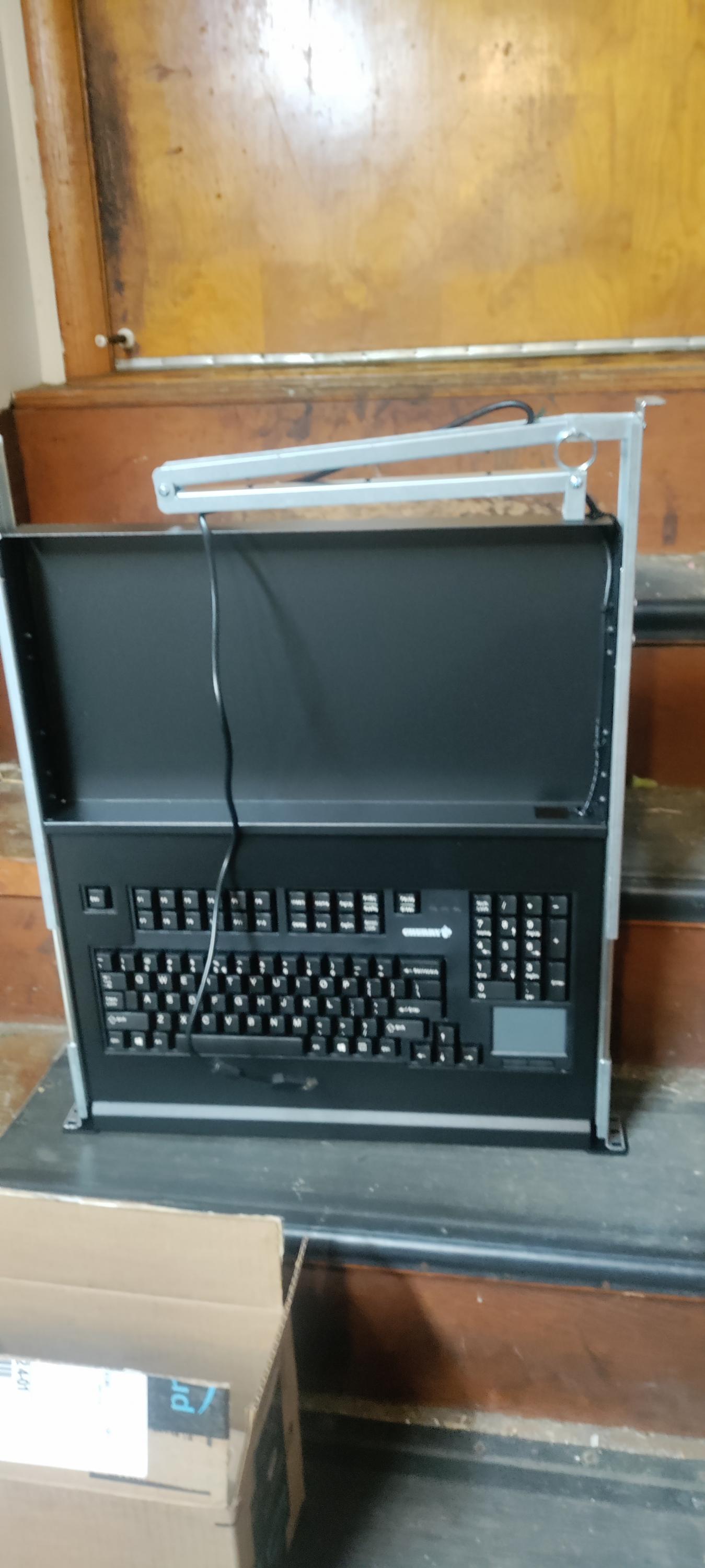

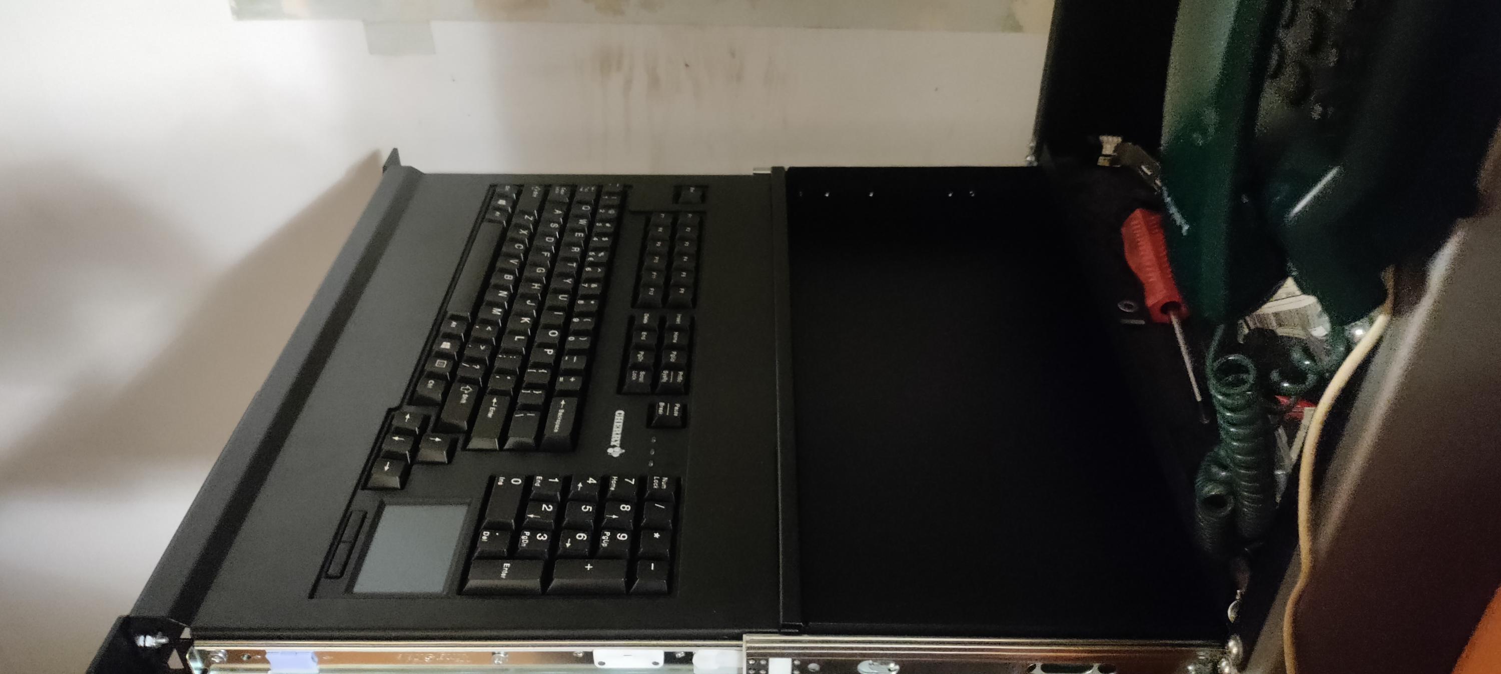

                More stuff came in last night. HDDs are in... easy enough. I have two hot spares (all 16 bays filled) and two offline spares. Should last me a while... or at least until NVME raid cards (and NVME SSDs) get cheap enough that I don't have to fork over $500 for such a setup (which is what the current going rate on eBay seems to be). Until then I don't see a point in spending money on a new drive setup... save that for a much larger change (1u/2u chassis swap, etc.).
                Also, the keyboard came in... yep, actually a new in box unit:
                Installed:
                The only downside is that it's big enough to get in my way when working in the closet. Have to back up a bit. But, sure beats the cheapo USB mini-keyboard I was running.
