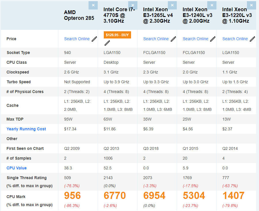

                                Here's a comparison of my CPU options:
                                https://www.cpubenchmark.net/compare...on-E3-1220L-v3
                                Well then. The first one is my existing setup (only as a twin-CPU setup). The second is what's already in the board I ordered. And the last 3 are the best performing chips in LGA1150 for the various wattages (Broadwell only went down to 35W, the 25W and 13W options are Haswell). If these benchmarks are true, to maintain my current performance anything quad core is a winner... but if I'm OK with losing performance (which probably isn't an issue unless I ever go back to hosting game(s) on it), the 13W special is viable.
                                That said, E3-1265 V4's are unobtainium it seems (no "cheap" ebay listings), so that can be scratched off (and the other Broadwell 47W chips are the same way). And E3-1240L V3's can be found in China for $52 ($69 in the USA). E3-1220L V3 is $35 in the USA... so in terms of $$$ a CPU swap doesn't completely pay-for-itself (if the benchmark annual cost to run is accurate for my area- I really don't know). So, for now, I'll probably leave the 65W i7 as-is unless I run into heat issues (or the financial incentives change).
