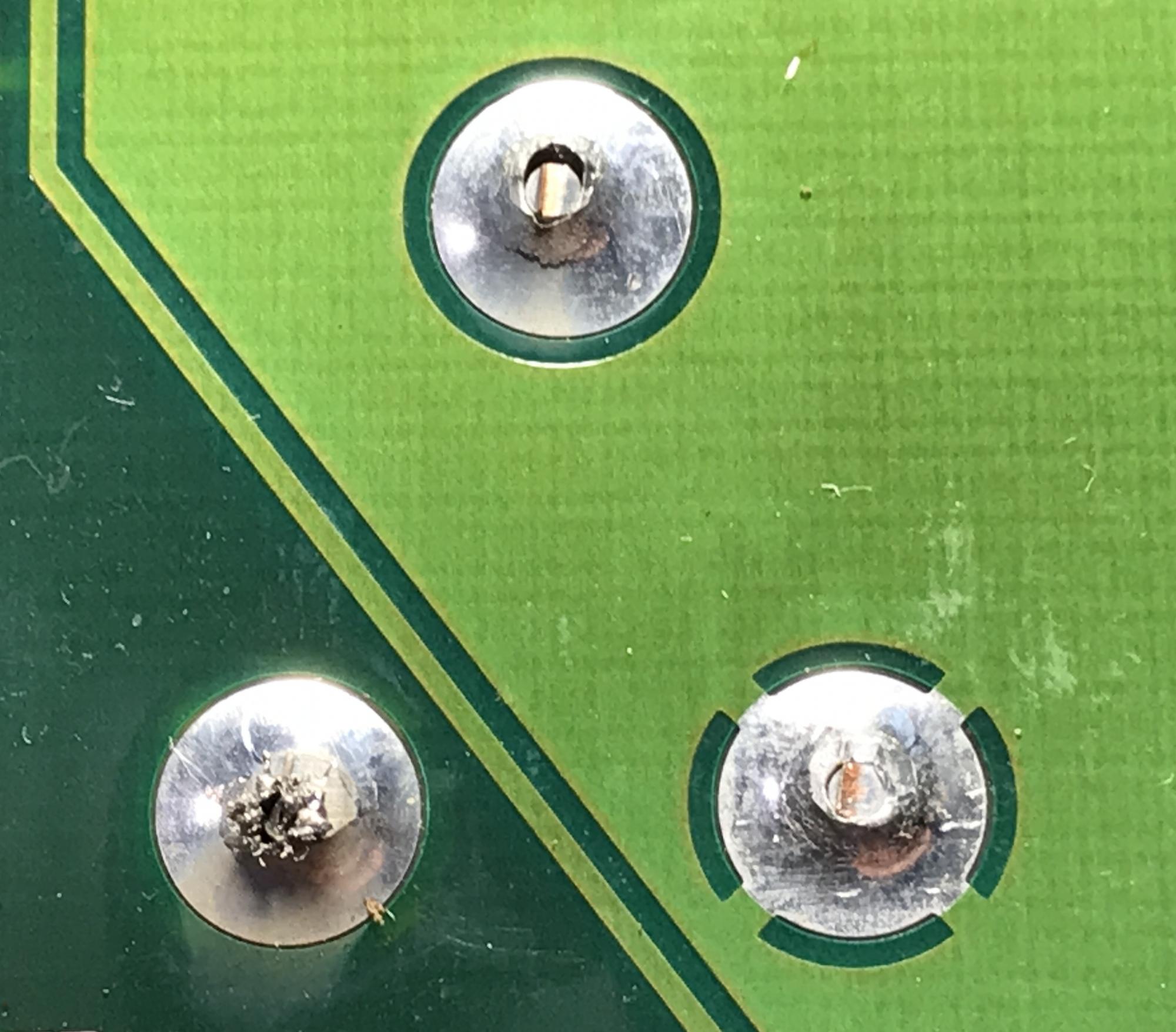

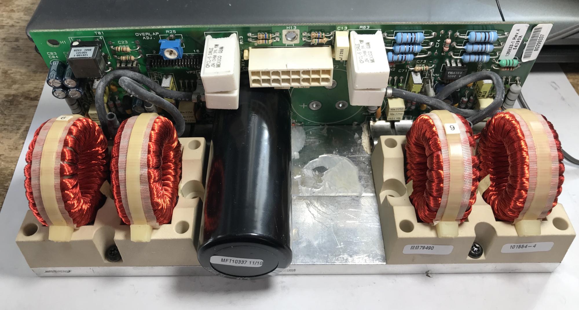

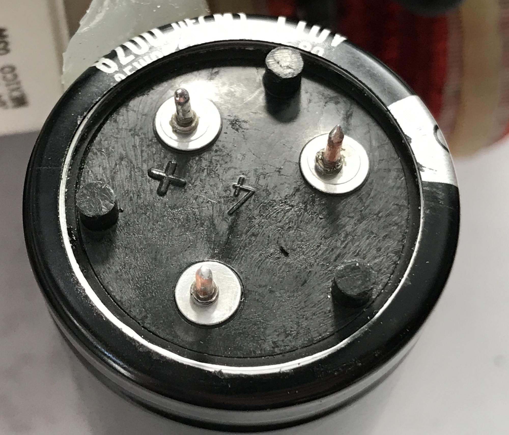

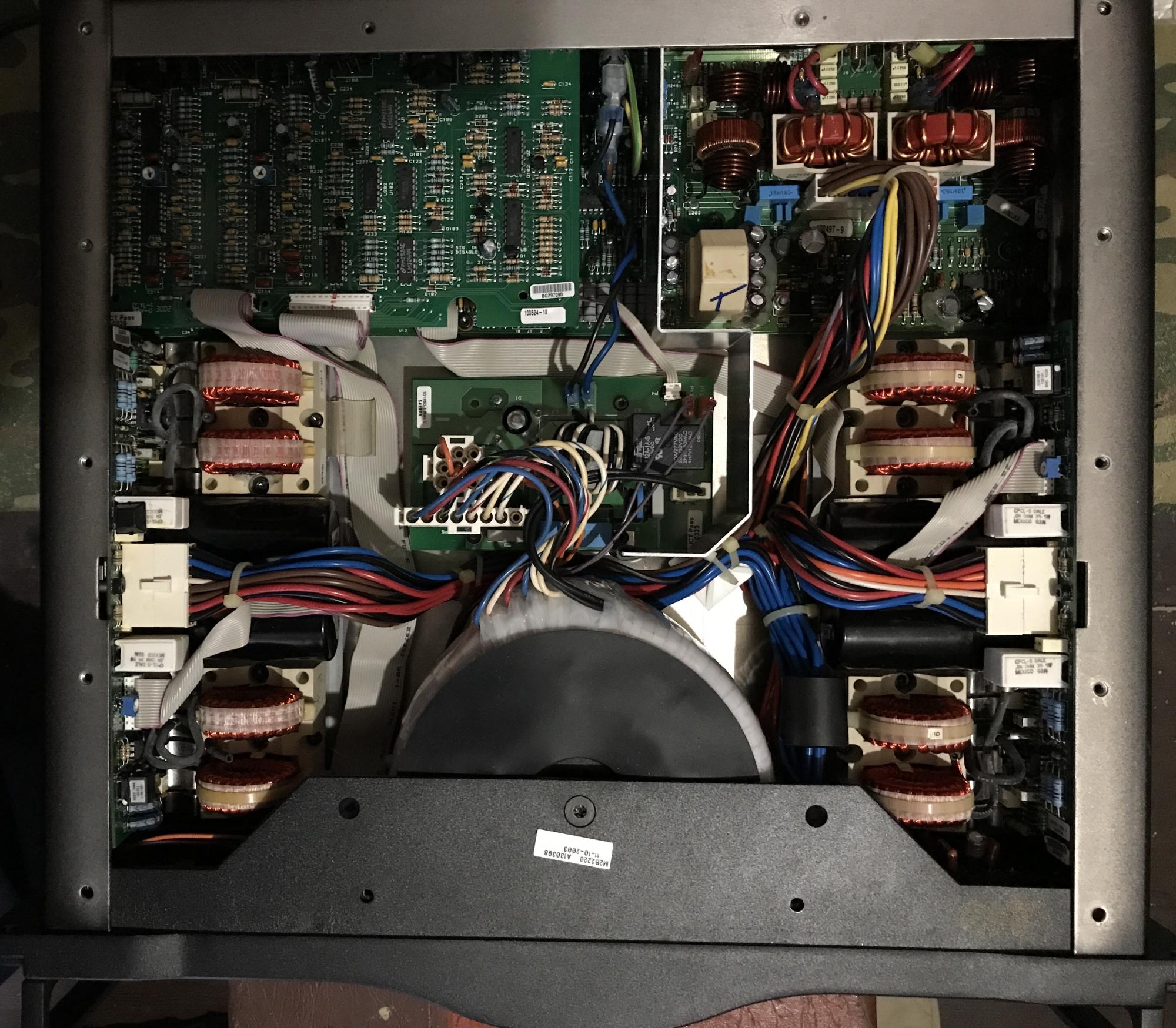

    I am repairing the crown k2 amplifier, bad soldering of Nippon Chemi -con capacitors and found a knock in one capacitor. I checked its capacity and ESR - everything is fine, it meets the parameters. The question arose whether this capacitor will work normally?

    It is hard to say, sometimes big capacitors dropped on a floor will end up shorting out.
    But in this case it looks more like it was rubbed a bit?
    If that is the case I would say it is probably fine.
    But the only way is of course to just test it long term and see how it goes.

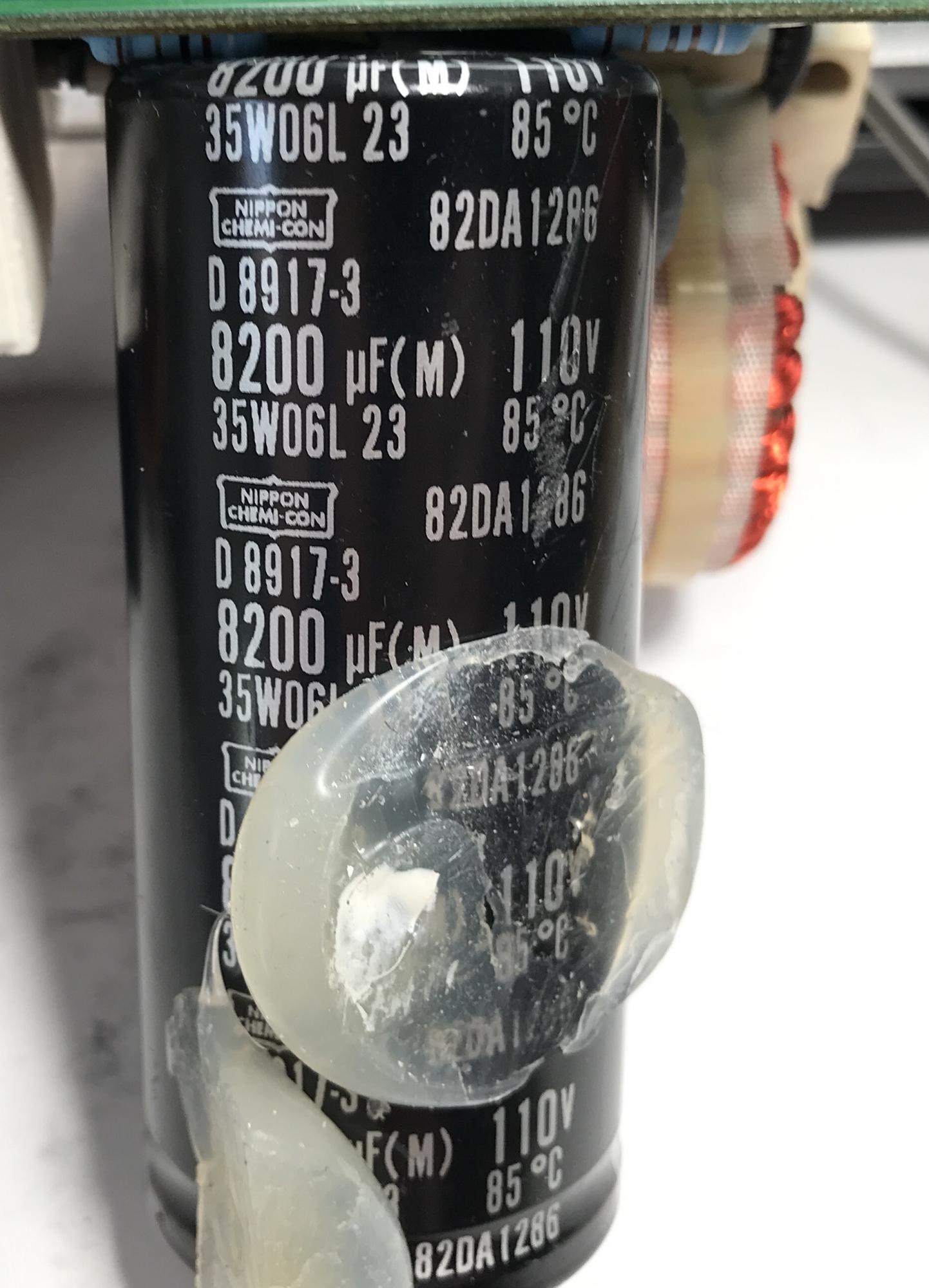

      The condenser was very tightly glued with thermal glue to the radiator and the second condenser. When I got it, I had to rock it, and something clicked in it. I'll put everything back in place tomorrow, just so it doesn't explode. I'm unlikely to find exactly the same new one.

        If you have a variable bench supply you can connect the capacitor to it and bring up the voltage slowly.
        If it is shorted you will notice the current increases sharply at rated voltage, use a low current limit...

          Yes, I connected the capacitor to the power supply and everything is fine, but the maximum voltage on this power supply is only up to 15 volts.

            15V instead of 110 is almost nothing to show the problem

              I assembled the amplifier and tested it in real conditions for 2 hours - it works fine .

                feeling the caps after an hour may be a good test - see if the damaged one is warmer or the same temperature

                  The temperature of the capacitor housing does not increase during the operation of the amplifier. Of course, a longer check is needed, but the owner will take care of this already.
