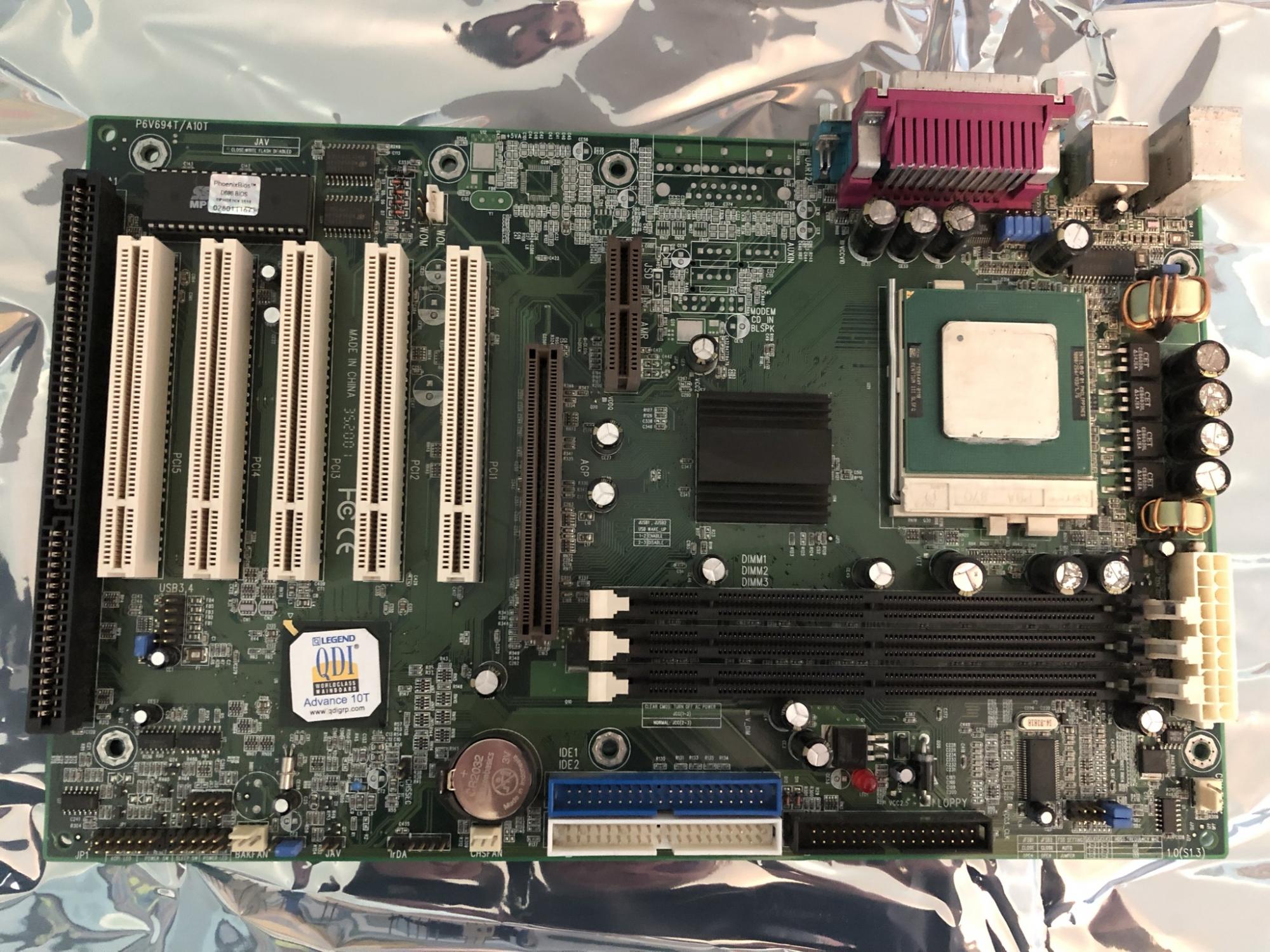

    Hey all, I am in the process of putting together a "vintage" Pentium III system and picked up a QDI socket 370 motherboard.
    The individual I bought it from said it's in excellent working condition, but since I'm still in the process of collecting some necessary parts, I haven't had a chance to try to get it to post yet.

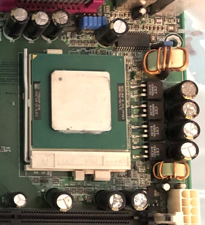

    I noticed that some of the caps around the socket appear to be either leaking or maybe just dirty (they're near where the heatsink/fan is) but I can't tell for certain. The caps are not bulging whatsoever and are as flat as could possibly be. I attached a couple pics and was wondering if anyone can help me determine if the caps might be problematic or if this is likely just grime that built up over the years.
    Thanks!

    Looks like corrosion from moisture / wet dust / moisty basement to me. Those are Panasonic (Matsushita) capacitors, and quite good quality. Looks like FC series (or perhaps HFQ?) Either way, no need to replace them. You can try cleaning the dirt with some IPA, if nothing else helps.
      • 31209
      Re: QDI socket 370 motherboard Bad caps or dirt?
      not FC, they would be a purple/blue sleeve.
      personally i would replace them, but only because i had a ruby MCZ explode all over me once simply because the board had been unused for years and it had depolarised!
      after that i just dont like old caps regardless of make/series.

        Panasonics can stay. Instead, replace the smaller "Y" shape vent caps as they are Licon and well known to cause trouble on QDI, Zida and some PCPartner/Octek/Sapphire motherboards. I have personally had a QDI Advance 10E lock up after counting RAM or flat out refusing to POST due to it being filled with Licons (IIRC the CPU caps were Panasonic, just like yours.).

            Here's a simple breakdown of which are which: Panasonic caps are the big ones near the CPU, and the ones that need replacing are the smaller 1000uF 6.3v caps, which should very likely be marked "Licon" in some kind of gold printing. Oh, and the residue on the Panasonic caps is probably crusty dirt.

              No.
              Old/traditional FL series have black sleeves with gold negative stripe and text.
              Newer FL series have black sleeves, but may sometimes have text and negative stripe in gray coloring.
              FLS, IIRC, is not an actual Panasonic series.
              FJS, is though... and they have the same black-gold or black-gray color as FL series. Same goes for FJ, IIRC.
              I don't remember what the FK series looked like (at least not in non-SMD form)... but those are quite rare.
              Besides, this board is too old to carry anything like FL or FJ/FJS series. Those came around later on with the Pentium 4 era, when motherboards really started needing ultra-low ESR caps. Rubycon MBZ were probably among the first ultra-low ESR series... then later on came the MCZ and custom-order MFZ series.

              I dismissed those as UCC when I saw the Panasonics around the CPU. But Licon does indeed fit the description too, with that "Y"-style vent. While Licon is not overly-horrible, I do agree it's a good idea to replace those - at least the ones around the RAM slots.
              These -are- with blue sleeves... just very dark blue. I think the picture makes them appear black, but if you look carefully, you will see they are dark blue, just like normal FC and HFQ series. Era-wise, those were pretty much the only widely-available low-ESR series from Panasonic, so I don't think they could be anything else. Maybe FK, which also came around the very early 2000's. FM came out much later, I think. And FR and FS are relatively recent series.

                  I tried some IPA pads then some 91% IPA but that didn't seem to do the trick. Perhaps these are just better off getting recapped in the long term?

                    Hmmm. I guess that has to be some kind of corrosion from exposure to moisture / temperature extremes mixed with dirt/dust that reacted a little bit with the outside of the capacitor's aluminum can. It looks just cosmetic.
                    That said, if you're going to be replacing the Licon/other electrolytic caps on the board, you might as well replace those Panny FC's too - it's just going to be a few more caps, after all. Do save the old Panasonic FC caps, though - in case you run into another (and perhaps less important) projects that might need a recap.
