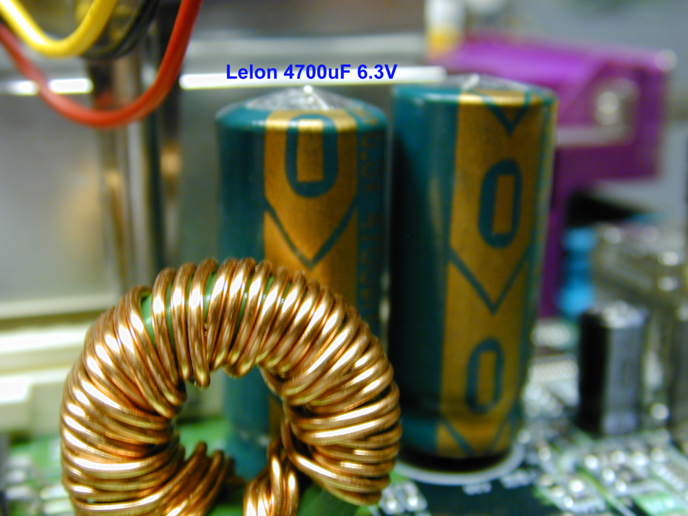

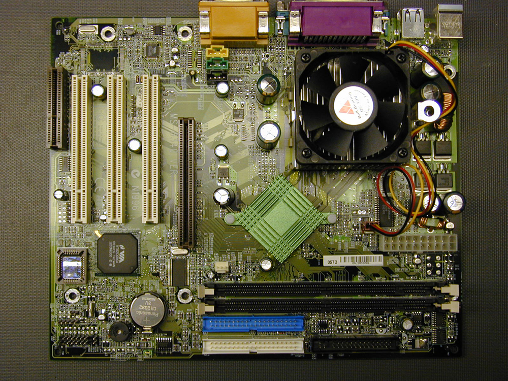

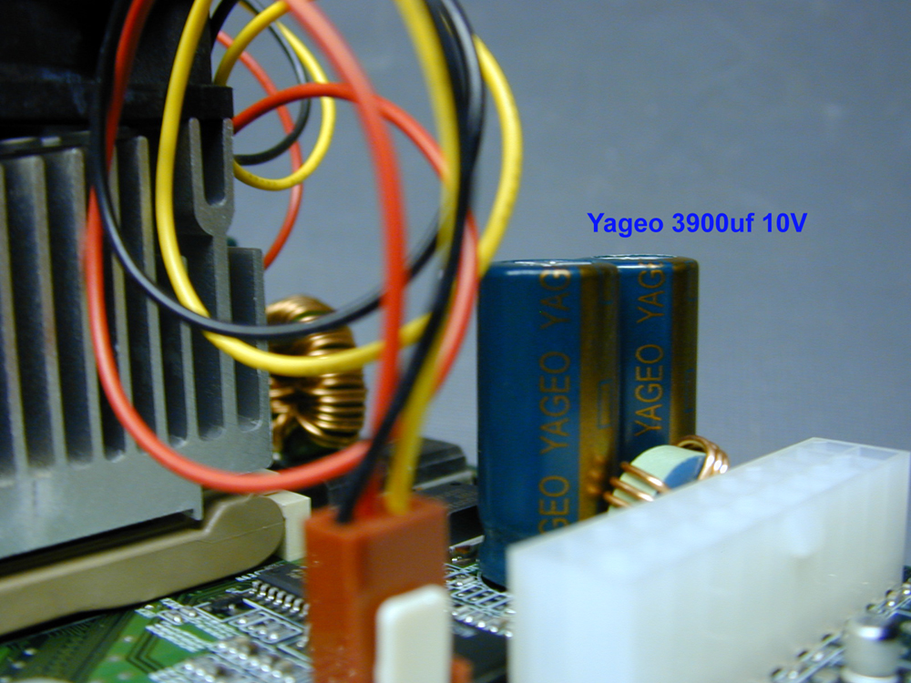

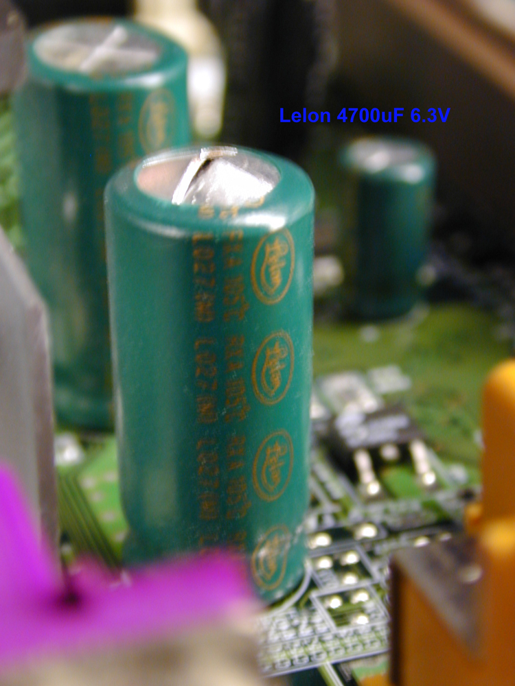

    MSI 6340 v1.0:
    M6340 K7TMPro
    This board was awesome! Until it started rebooting and freezing on W2K. Damn! this board was cheap at a local comp. show back in the day of all the eMachines and Systemax warranty returns (I didn't know any better at the time). Anyone remember? There were thousands of returned machines that the white box builders bought at auction and parted out. New shit for cheap, unless you got a MSI or a Giga like me! The PSU in the new cases also had the crap caps and puked after a year of 24/7. Anywho here's the materials list:
    4700uf 6.3V (4) Lelon
    3900uF 10V (2) Yageo
    2700uF 6.3V (1) Tayeh
    1000uF 6.3V (6) Tayeh
    330uF 6.3V (2) Tayeh
    100uF 10V (1) Tayeh
    This board was tested and purchased with caps that were good, but then went bad. Live and learn.
    BTW- I just replaced another PSU this weekend on a white box manufactured in 2000. 250W PSU blew vented all of the low voltage side of caps. New brand for me please add it to the list "SU' scon"
