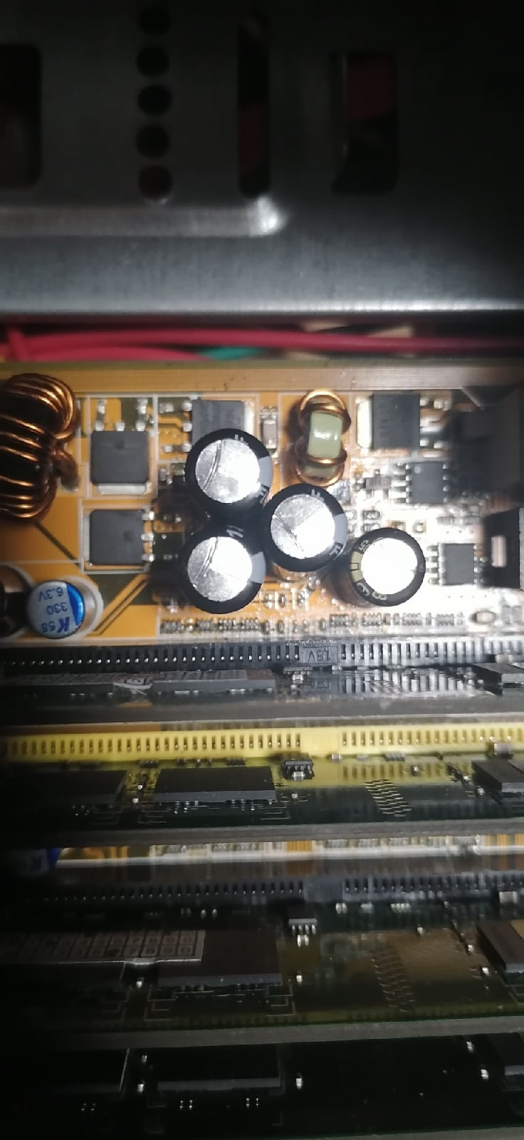

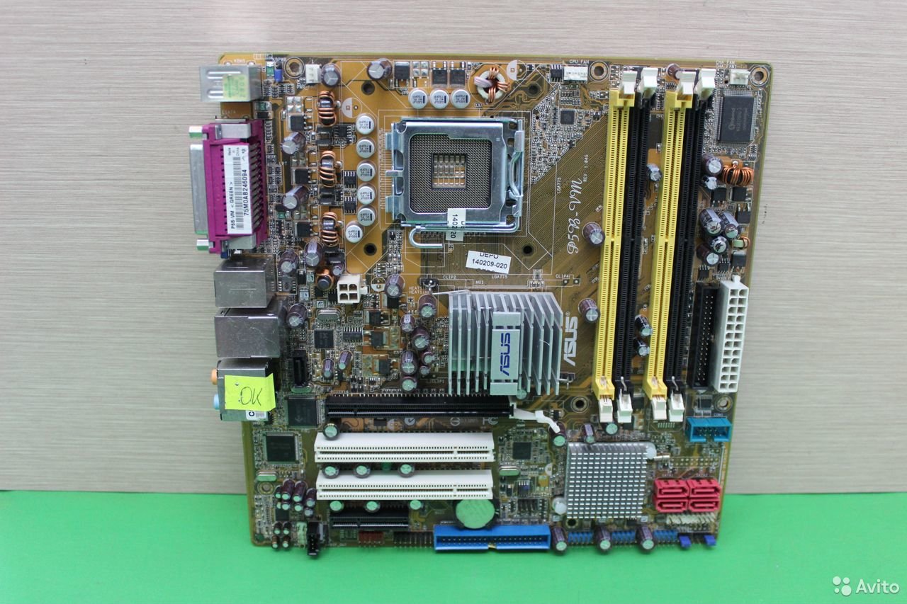

Did I just bought a fakecap ?
  • xnRS
    replied
    Re: Did I just bought a fakecap ?
    Originally posted by brethin
    You got faked, keep crying.
    wow, so toxic, funny man, get out of that forum. Noone wants to see you there
    Leave a comment:
  • brethin
    replied
    Re: Did I just bought a fakecap ?
    You got faked, keep crying.
    Leave a comment:
  • mockingbird
    replied
    Re: Did I just bought a fakecap ?
    Of course they're fake.
    I have never seen Panasonic FL sold to the masses that were genuine, nor are they even manufactured any longer.
    Leave a comment:
    replied
    Re: Did I just bought a fakecap ?
    1500uf will be fine, but i suspect we wont find more than 1200uf.
    Leave a comment:
  • xnRS
    replied
    Re: Did I just bought a fakecap ?
    Originally posted by stj
    best i'v found in 8mm so-far is 1000uf, but i'm still looking
    I think this is would be hard one, as polymers are more wide and more low, so I found only 10mm 1800uf one...
    Leave a comment:
    replied
    Re: Did I just bought a fakecap ?
    best i'v found in 8mm so-far is 1000uf, but i'm still looking
    Leave a comment:
  • xnRS
    replied
    Re: Did I just bought a fakecap ?
    Originally posted by stj
    0.016 is a lot less than 0.11
    yea I know
    also, btw, can you give me a link to a poly caps pls
    Leave a comment:
    replied
    Re: Did I just bought a fakecap ?
    0.016 is a lot less than 0.11
    Leave a comment:
  • xnRS
    replied
    Re: Did I just bought a fakecap ?
    Originally posted by xnRS
    they are 330uf 6.3v, will check the datasheet for these Kemet A758
    So from datasheet it says ESR at 100 kHz 20°C is 16 mΩ
    Leave a comment:
  • xnRS
    replied
    Re: Did I just bought a fakecap ?
    Originally posted by stj
    a polymer with 0.11ohms sounds so wrong!
    they are 330uf 6.3v, will check the datasheet for these Kemet A758
    Leave a comment:
    replied
    Re: Did I just bought a fakecap ?
    a polymer with 0.11ohms sounds so wrong!
    Leave a comment:
  • xnRS
    replied
    Re: Did I just bought a fakecap ?
    So, after desoldering caps what I got is:
    3 died panasonic(probably not) caps, each of them lost half 800 uF of their capacity(Finally got at least LCR-T4), and got high ESR
    1 out of 4 Kemet caps died on desoldering, as one output lead desoldered(or what it has done) from the cap too. Other Kemet caps survived and still got good ESR in range from 0.07 to 0.11 and 360-380uF capacity
    Leave a comment:
  • xnRS
    replied
    Re: Did I just bought a fakecap ?
    Originally posted by xnRS
    Funniest of all that K58 Kemet caps survived...
    And the board worked for a long time... You know... 3 days...
    Leave a comment:
  • xnRS
    replied
    Re: Did I just bought a fakecap ?
    Originally posted by xnRS
    CRAAAAAAAAAAP, FORGOT ABOUT THOSE xD got the same issue on Asus GPU yesterday
    Funniest of all that K58 Kemet caps survived...
    Leave a comment:
  • xnRS
    replied
    Re: Did I just bought a fakecap ?
    Originally posted by stj
    how wide are the 1800uf caps? 8mm or 10mm
    8x20(Width x Length)
    Leave a comment:
  • xnRS
    replied
    Re: Did I just bought a fakecap ?
    Check the polarity of the capacitors: you installed them backwards.
    Asus are crazy and uses the half circle on the PCB to designate the positive side.
    See for example:
    https://www.badcaps.net/forum/showthread.php?t=10480
    https://www.badcaps.net/forum/showthread.php?t=16890
    CRAAAAAAAAAAP, FORGOT ABOUT THOSE xD got the same issue on Asus GPU yesterday
    Last edited by xnRS; 06-05-2021, 04:33 PM.
    Leave a comment:
    replied
    Re: Did I just bought a fakecap ?
    Check the polarity of the capacitors: you installed them backwards.
    Asus are crazy and uses the half circle on the PCB to designate the positive side.
    See for example:
    https://www.badcaps.net/forum/showthread.php?t=10480
    https://www.badcaps.net/forum/showthread.php?t=16890
    they dont always do that - which is actually worse because you need to note the details before you pull the old caps - or go searching for pictures afterwards.
    Leave a comment:
    replied
    Re: Did I just bought a fakecap ?
    how wide are the 1800uf caps? 8mm or 10mm
    Leave a comment:
  • Per Hansson
    replied
    Re: Did I just bought a fakecap ?
    Check the polarity of the capacitors: you installed them backwards.
    Asus are crazy and uses the half circle on the PCB to designate the positive side.
    See for example:
    https://www.badcaps.net/forum/showthread.php?t=10480
    https://www.badcaps.net/forum/showthread.php?t=16890
    Leave a comment:
  • xnRS
    replied
    Re: Did I just bought a fakecap ?
    *Update*
    Those caps didn't survived, maybe they are still working but they are bulged(Screen attached)...
    They didn't survived because they got overheated(common problem on this ASUS P5B-VM board, saw another one for sale with same bulged caps, screen attached by the way), even original factory Rubycons MCZ didn't survived this one, so those caps wouldn't get even a chance either Also near are Kemet A758 caps which I bought from same seller, they are still good(0.67 BYN / 0.27 USD each btw), they replaced 3 bulged and one none bulged Evercon 330uF 6.3V which were installed from factory for some reason... So maybe you'll give me an advice which poly cap to use for this board, as I didn't found any 1800uF 6.3V poly cap on Ali.
    Last edited by xnRS; 06-05-2021, 12:49 PM.
    Leave a comment:
