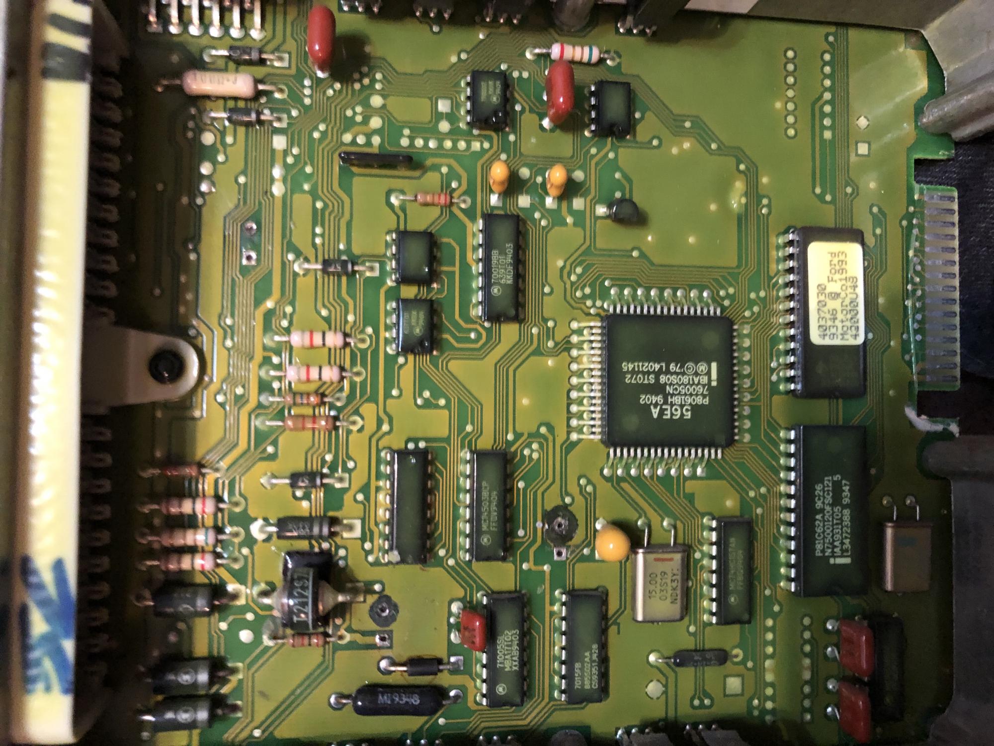

    Hello, Iam working on my dads EEC-IV computer from his 94 Lightning Pickup, it has bad nichicon PC(M) 2x47uf 16v and 1 10uf 63v what would be a decent replacement? I noticed Panasonic makes the General purpose NHG series any they are rated to 105c whould those be okay?
    also on the bottom left of the board capacitor I see I guess a diode or something, it has no markings and had electrolite under it which i cleaned, did that cap possibly short it out?

    Heres a picture of the bad cap next to what I think is a diode? I see a black pool under it but is that electrolyte from the cap or the diode?

      Re: Nichicon PC(M) replacement
      It could be glue but then you would expect the same under other components so I guess not.
      It looks like the board is conformally coated, maybe the electrolyte somehow dissolved that and created that mess...
      As for the cap choice I don't know because I did not find a datasheet for the Nichicon PC.
        Here is a datasheet for Nichicon PC...
        If you want to be strict about it, you could use an automotive-grade cap like RX30 or similar.
          https://www.badcaps.net/forum/attach...1&d=1614021069
          I found these but 50v vs 16v for the original capacitance is the same.
          https://www.mouser.com/ProductDetail...ysgx62ww%3D%3D
          I also found some guy trying the WURTH alluminum polymer caps, would those be a better choice since they wont ever leak again or would you go with the rubycons? Thank you for the help!
          My Computer: AMD Ryzen 9 3900X, Asrock X370 Killer SLI/AC, 32GB G.SKILL TRIDENT Z RGB DDR4 3200, 500GB WD Black NVME and 2TB Toshiba HD,Geforce RTX 3080 FOUNDERS Edition, In-Win 303 White, EVGA SuperNova 750 G3, Windows 10 Pro
            • 31139
            i would try to see what the caps do.
            are they just smoothing dc, or on a dc/dc convertor output? or signal blocking?
