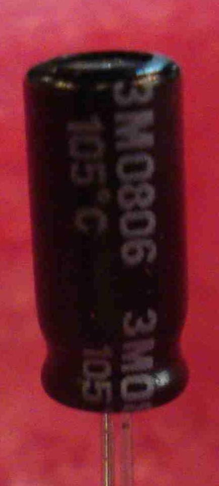

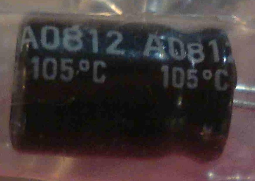

Reqd Date Decoder for Rubycon Electrolytic capcitor
  • callmejr
    • Jun 2009
    • 3
    Please if anybody has the Date code decoder for the Rubycon YXG & YXF electrolyitc capcitors, please help me
    or please decode the following 2 informations from 2 caps
    3M0806
    A0812
    Regds
    Ravi
  • brispuss
    • Dec 2012
    • 54
    • NZ
    Re: Reqd Date Decoder for Rubycon Electrolytic capcitor
    Not entirely certain, but the letter usually indicates manufacturing location.
    The "08" indicates the year 2008.
    And "06" and "12" usually indicate the week of manufacture.
    So 3M0806 capacitor was manufactured in week 6 of 2008, and A0812 capacitor was manufactured in week 12 of 2008.
