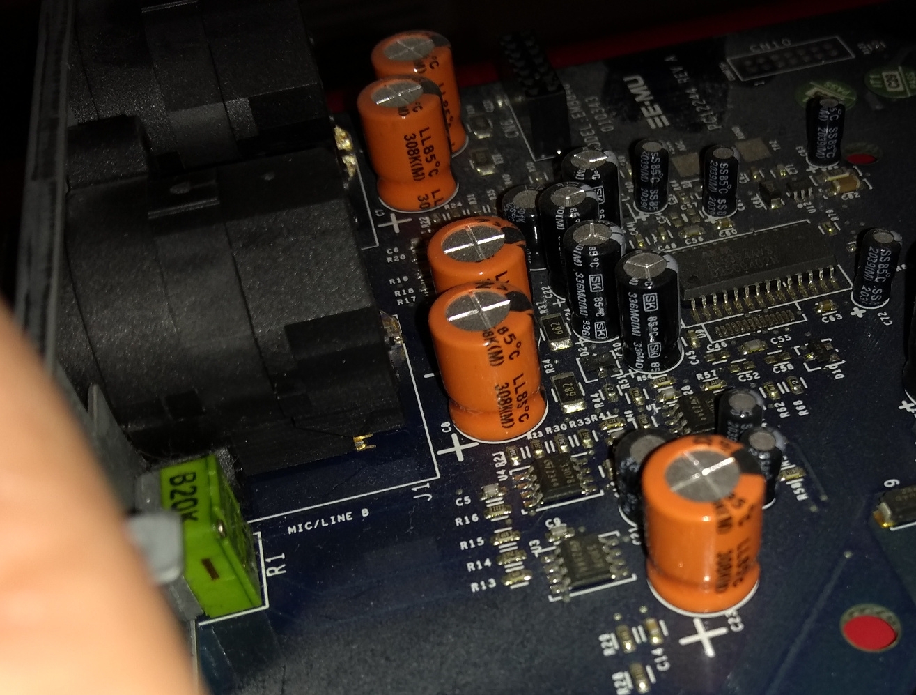

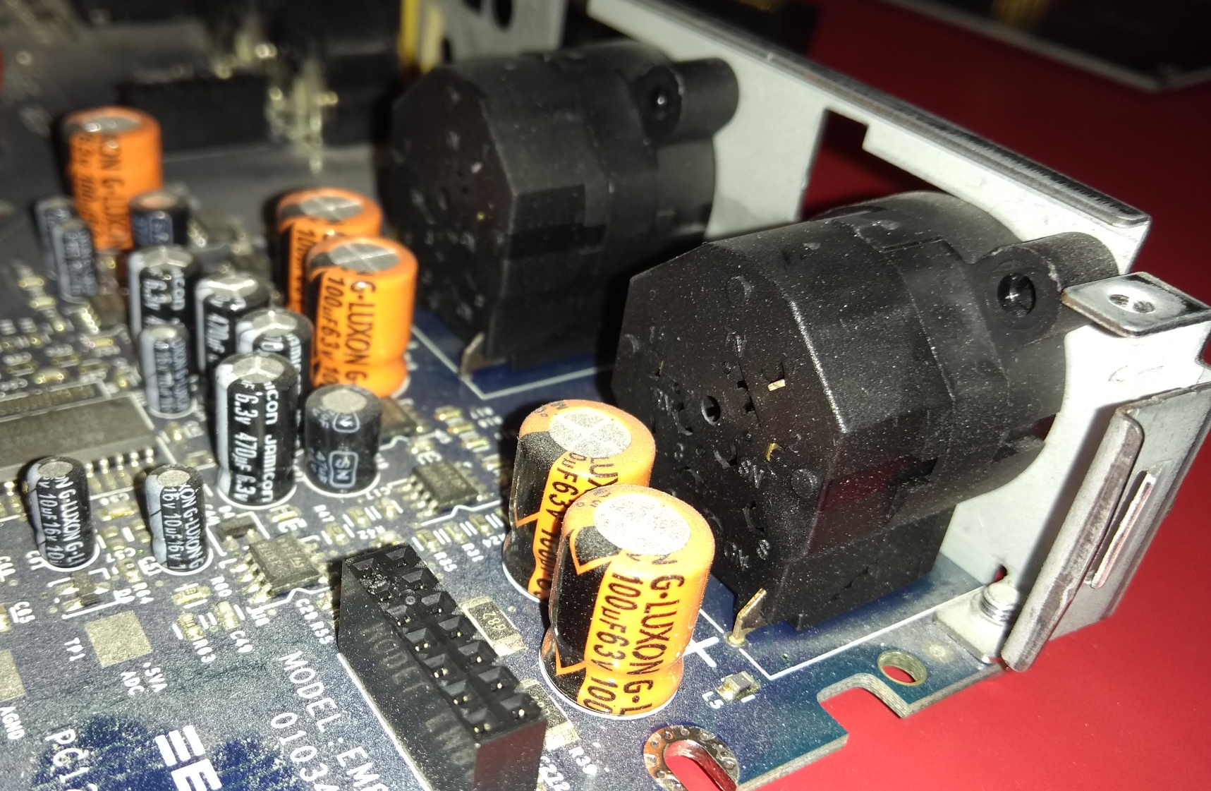

    Hello!
    I'm changing capacitors on an E-MU 1820m soundcard/breakout-box with G-Luxons in it. Much thanks to this board for providing information on the matter, otherwise I might not have dared starting this project.
    I've found the datasheets for a lot of G-Luxons, but can't find any mention of the following capacitor apart from on this very forum, for the exact same box(!): https://www.badcaps.net/forum/showth...light=LL85%B0C
    The markings on the capacitors are
    G-LUXON 63v 100uF LL85°C 308K(M)
    Does anyone know what this might be? I've googled to the best of my abilities but turned up empty handed.
    Currently considering not replacing them cause I can't find any information on them, and they are in the audio path (the black connectors are XLR connectors for two microphone inputs), with currently no known faults.

    I attached the G-Luxon LL datasheet. It is a low leakage current 85ºC series to which Chemicon's LLA series is a direct cross. Haplessly, the case size for 100uF 6.3V in the datasheet does not match those in that breakout box.

      Thank you very much! (They do match though, as I need 63V and not 6.3V - and the dimensions for 63V match.)
      Now I just need to figure out a suitable replacement, the ones in my preferred stores seem to be rated for a leakage current "<= 0.01CV (or 4µA, whichever is greater)", whereas these G-Luxon LLs are "<= 0.002CV (or 4µA)" and I'm not sure how much this matters.

        Wow, I feel so dyslexic now. I don’t know how I missed the fact that there was no space between the 6 and 3 on the voltage rating. In that case, it turns out that Nichicon’s KL series may be a better replacement. Mouser has some in stock.
