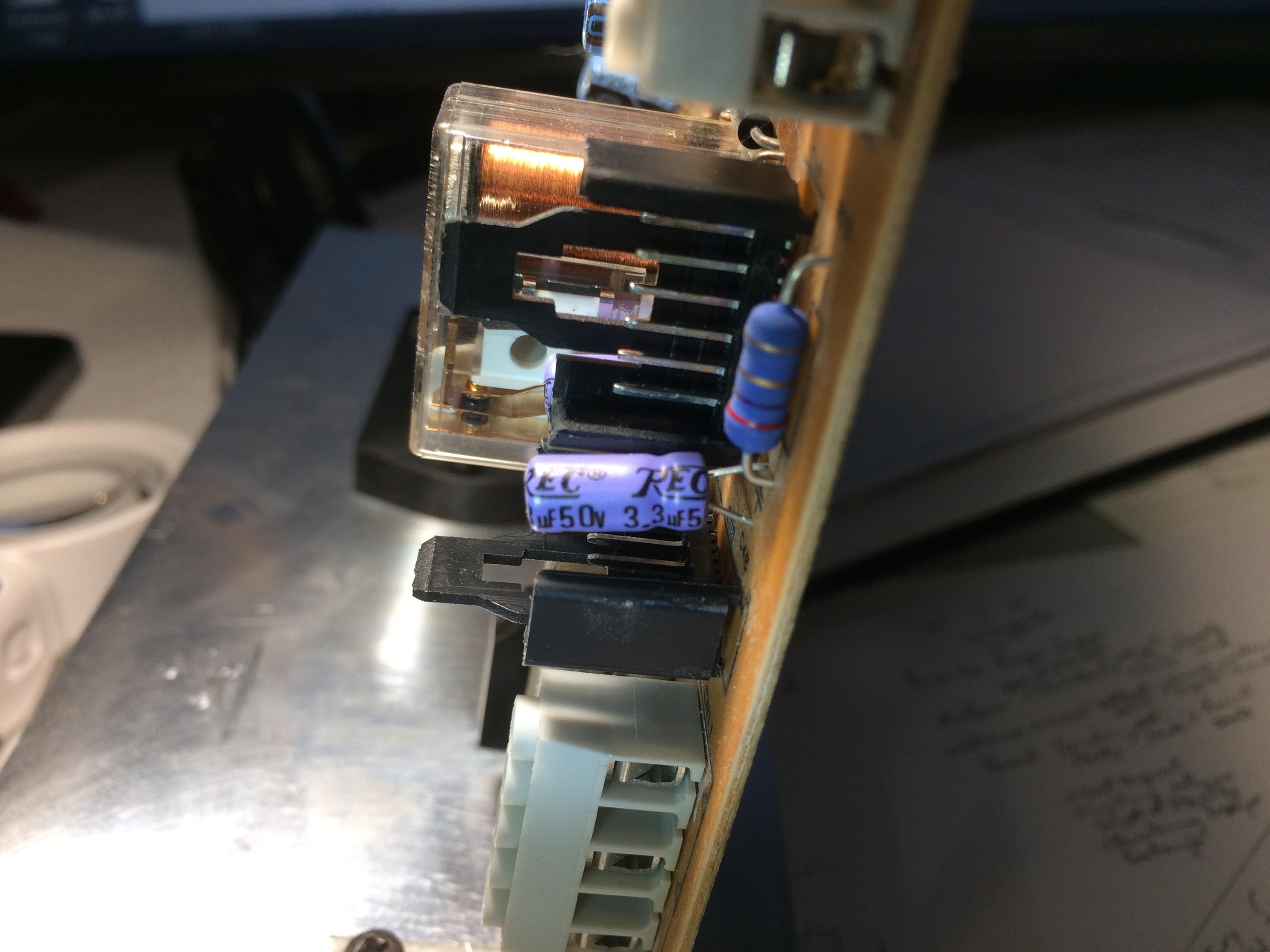

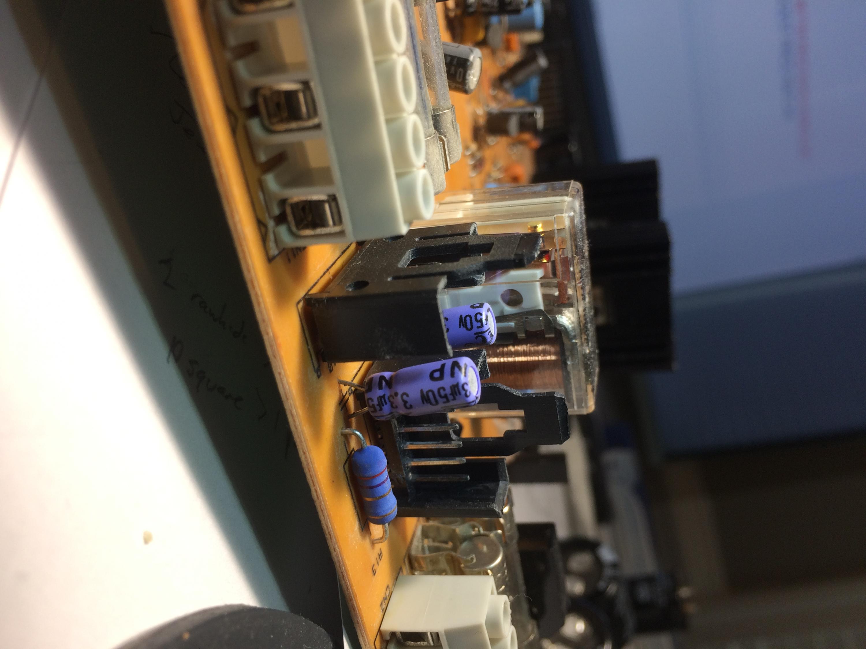

    Please help me find a data sheet for this so I can replace it.
    Trec NP?? not sure if NP is for non-polarized or for the series. NP series seems to be a fiction, so I presume it's some other mysterious series. They are purple.
    Any ideas on what series it is??
    Thanks,
    Ryan

    NP usually stands for non-polarized and based off of your photos i think those capacitors are non-polarized as i don't see a negative stripe on those capacitors.
    From what i can find it they could be trec BR series or trec NR series capacitors.

            Yes that's a non polarized/bipolar electrolytic capacitor. Usually the characteristics of these capacitors are pretty crappy to begin with so likely you can replace with almost any crappy np/bipolar electrolytic capacitor of the same capacitance/voltage.

              NP CAPS are used a lot in speaker cross over, and also in Class D amplifier output.
