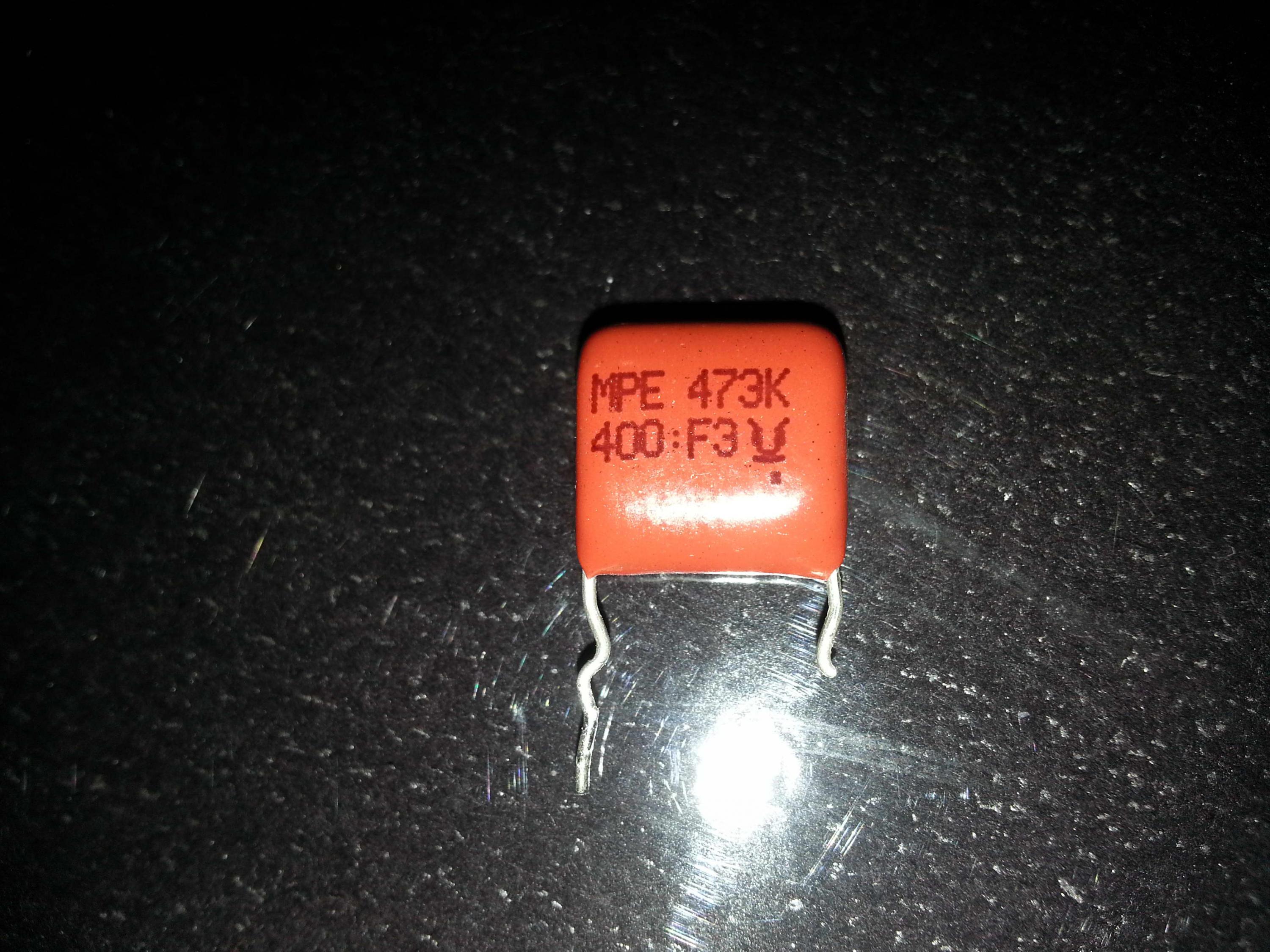

    I am working on a Yamaha RX-Z7 and need some help in identifying a suitable replacement cap. Info from parts list:
    C4 - WJ361200 - C.POL.MTL - 0.047uF 400V
    I have attached a portion of the power supply schematic that shows its circuit location/use as well as a shot of the actual cap. Not sure why I am having trouble identifying a good replacement. Higher voltage would be okay as long as it is physically close in size. Current device is approximately 11mm x 10mm x 4.5mm @ 10mm spacing. Any ideas?

    This one would do just fine I imagine. http://www.mouser.com/ProductDetail/...6x3yOoT7uvw%3d .

      Thanks. Looks like this will work fine. On order!
