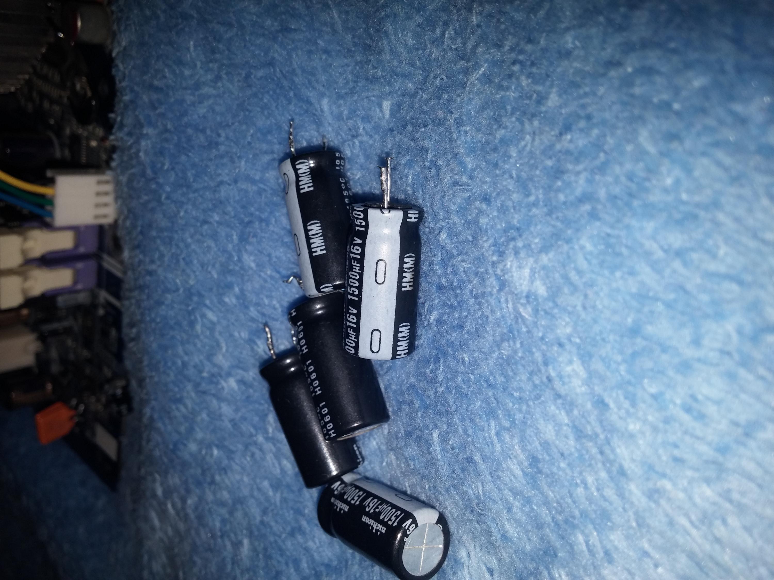

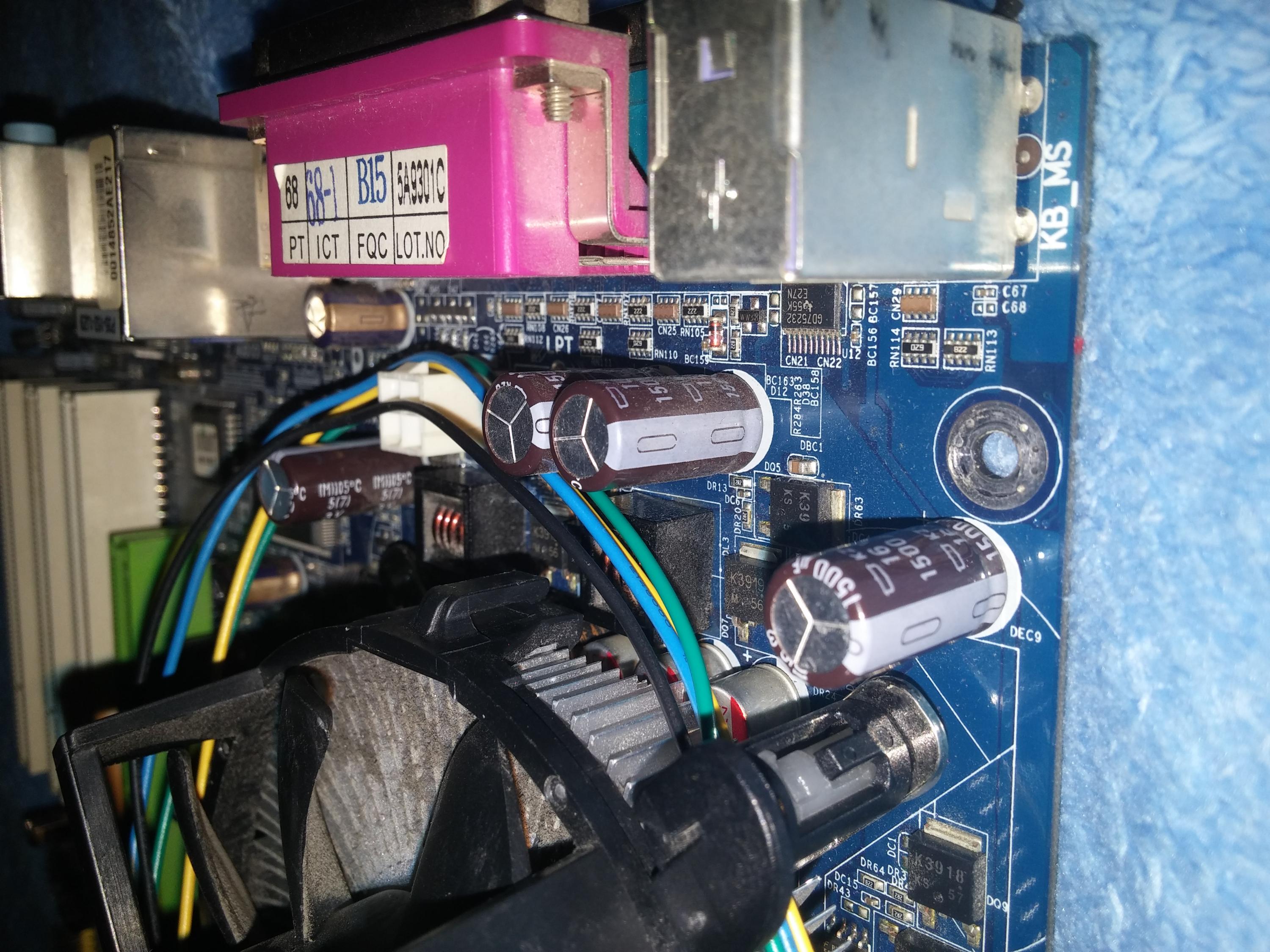

    I have a few ucc kzg 1500uf caps on my old 775 mobo. Are they compatible with nichicon hm?
    master hoarder
    • May 2008
    • 12175
    • Bulgaria
    Re: is nichicon hm compatible with ucc kzg?
    Yes.
    Nichicon HM is a direct replacement for Chemicon KZG, especially the 16V 1500 uF 10x20 mm size.

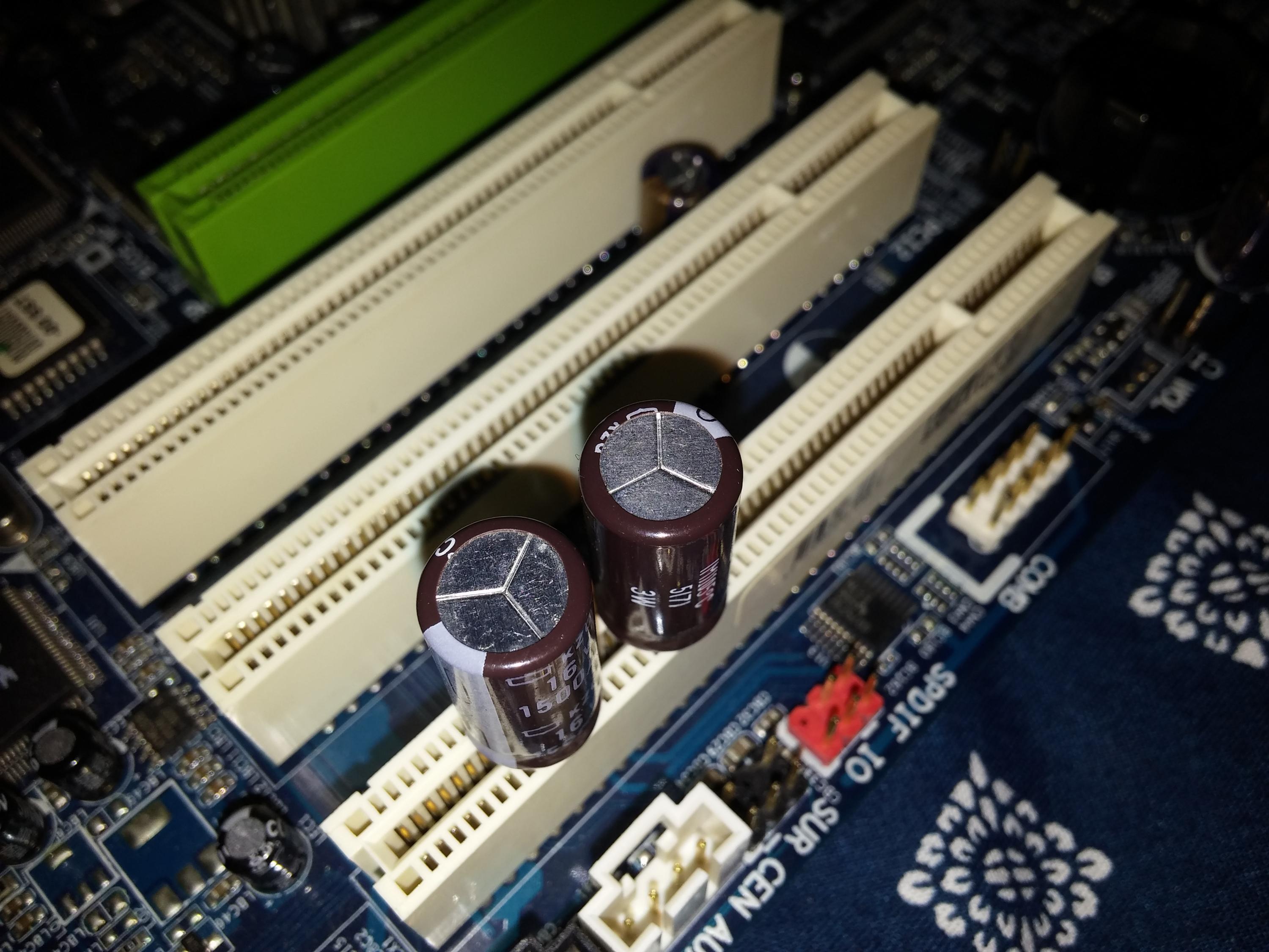

        Also the board has a fer nichicon hn 820uf 4v next to the cpu. Their manufacturing date is a0511. Are they bad hn series nichicon manufractured back in 2004? Rest of the caps on the board are rubycon mbz.
          master hoarder
          • May 2008
          • 12175
          • Bulgaria
          That's a 2005 year Nichicon, week 11.
          2005 was a "transitioning" year for Nichicon HM and HN capacitors. Some caps from 2005 do end up being bad, others are okay. I think week 11 is a pretty early, so those may be more likely to have problems. I'm not an expert on this matter, though (I think Wester547 might know better... let's hope he sees this thread and chimes in.)

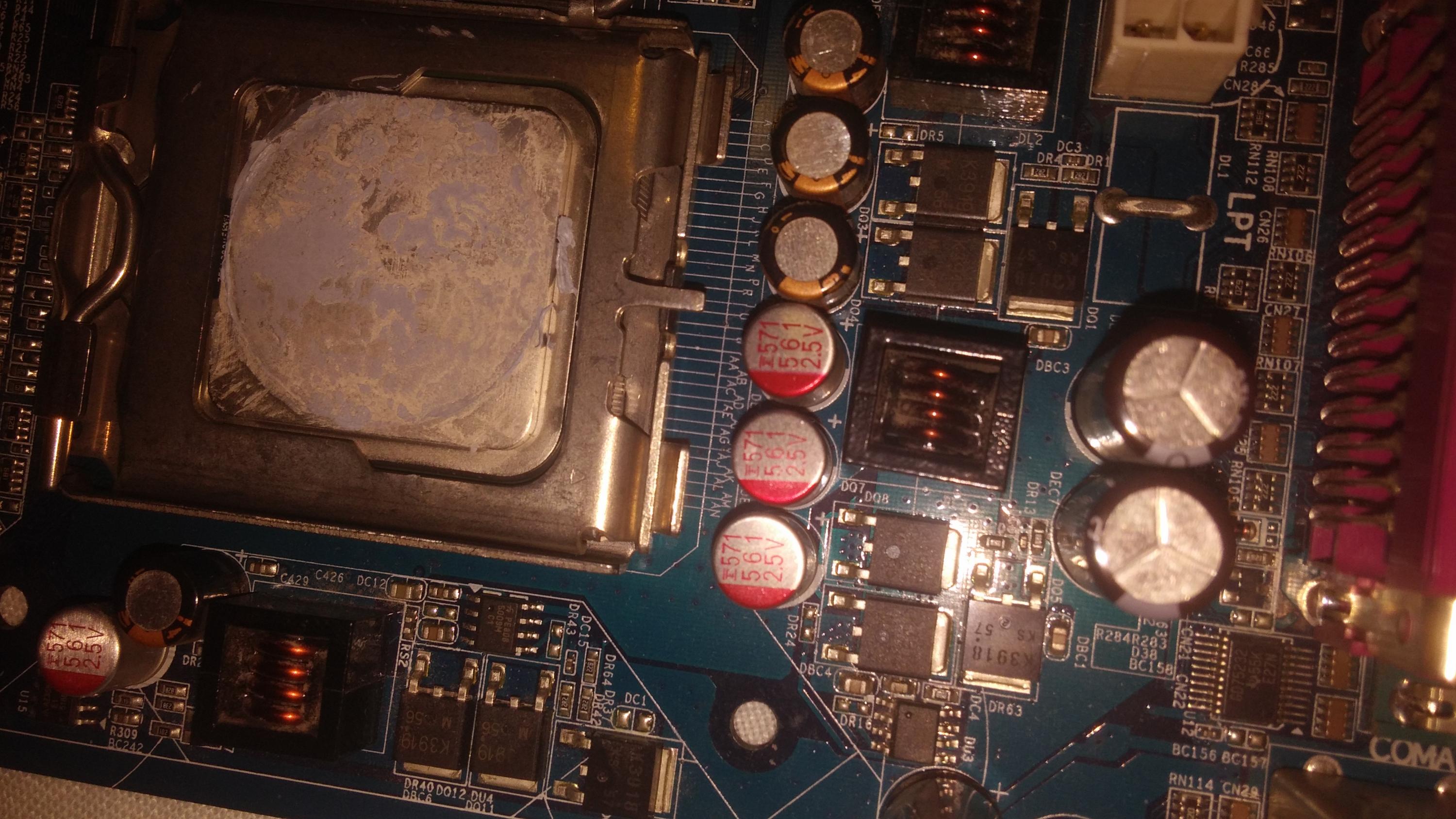

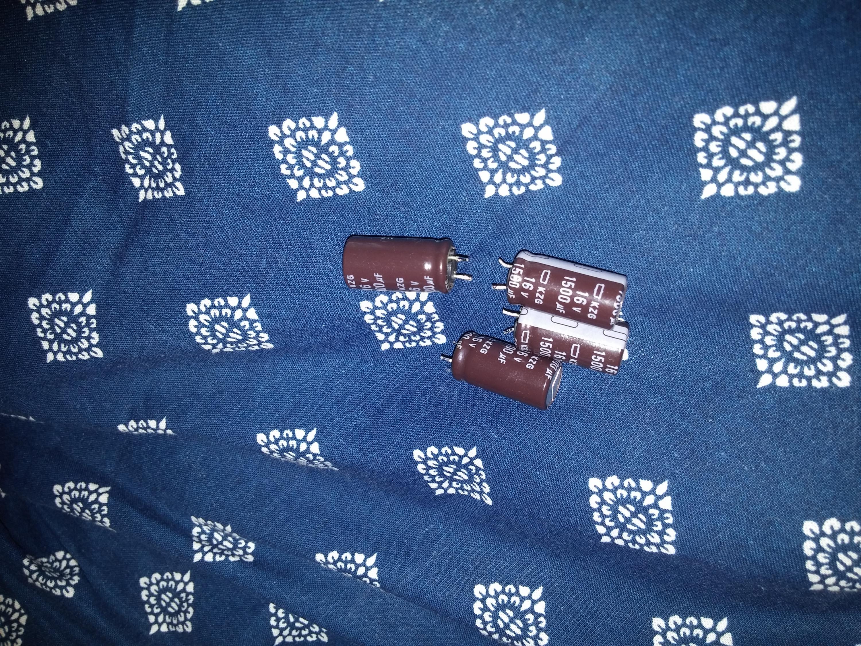

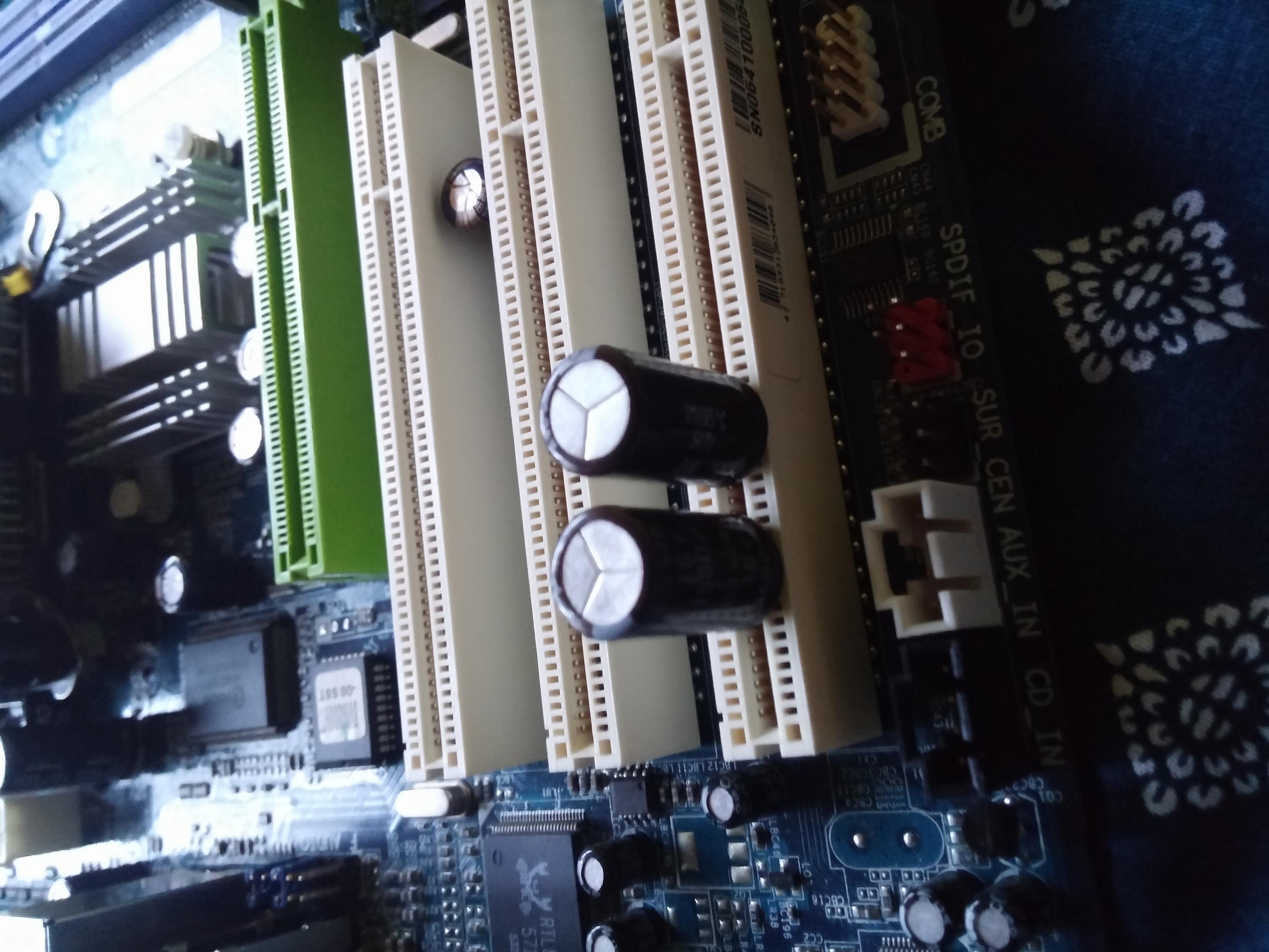

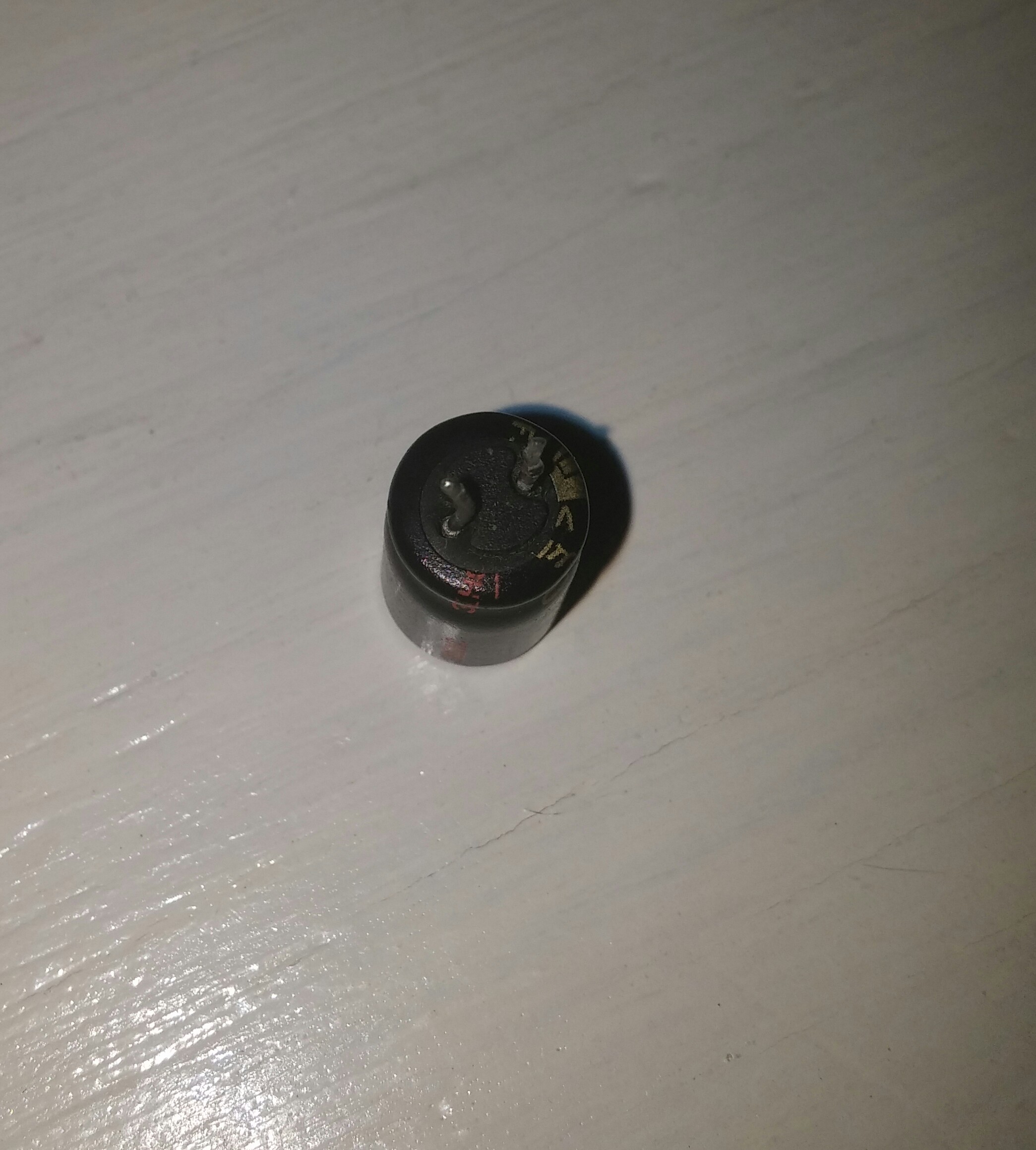

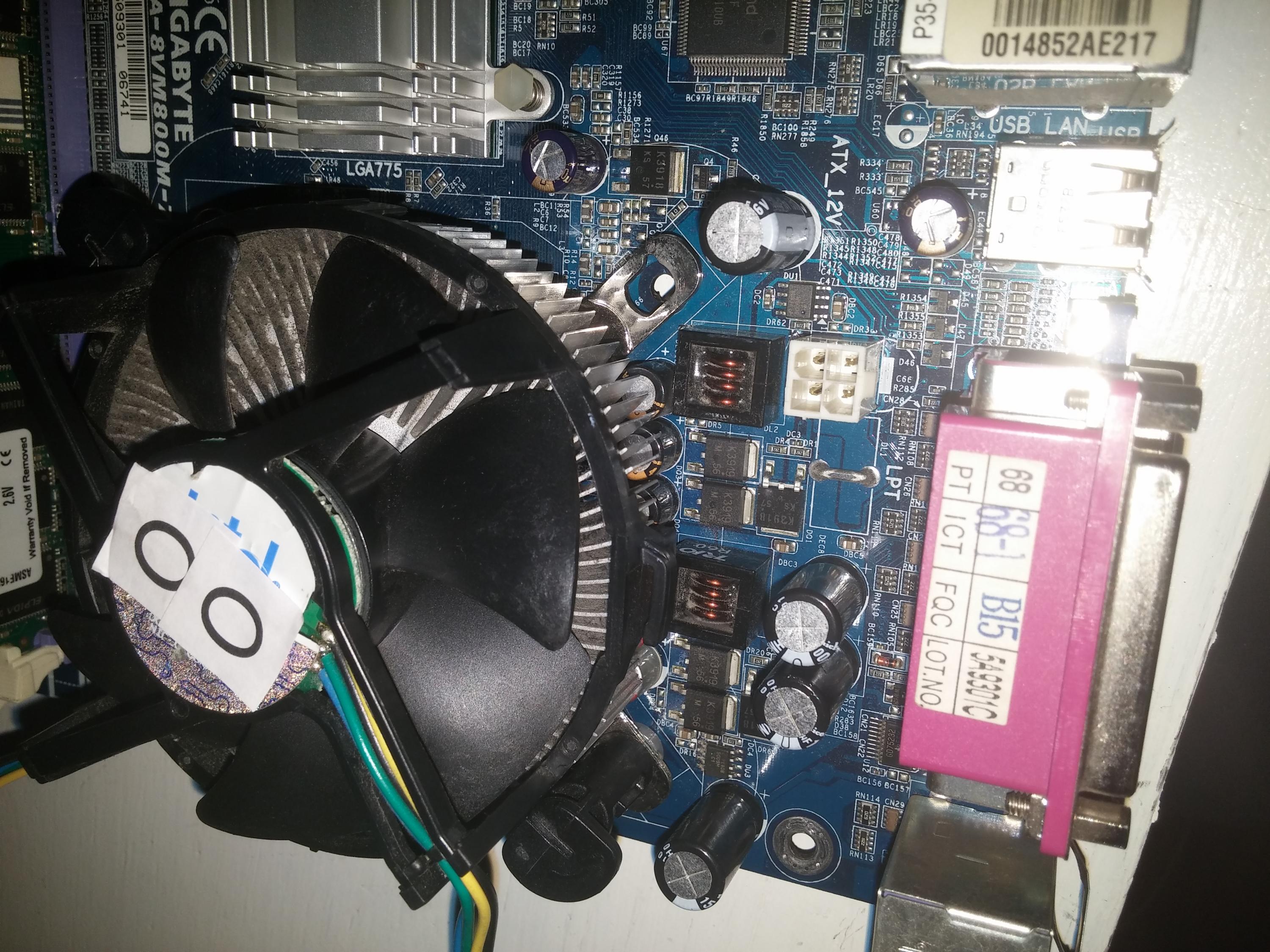

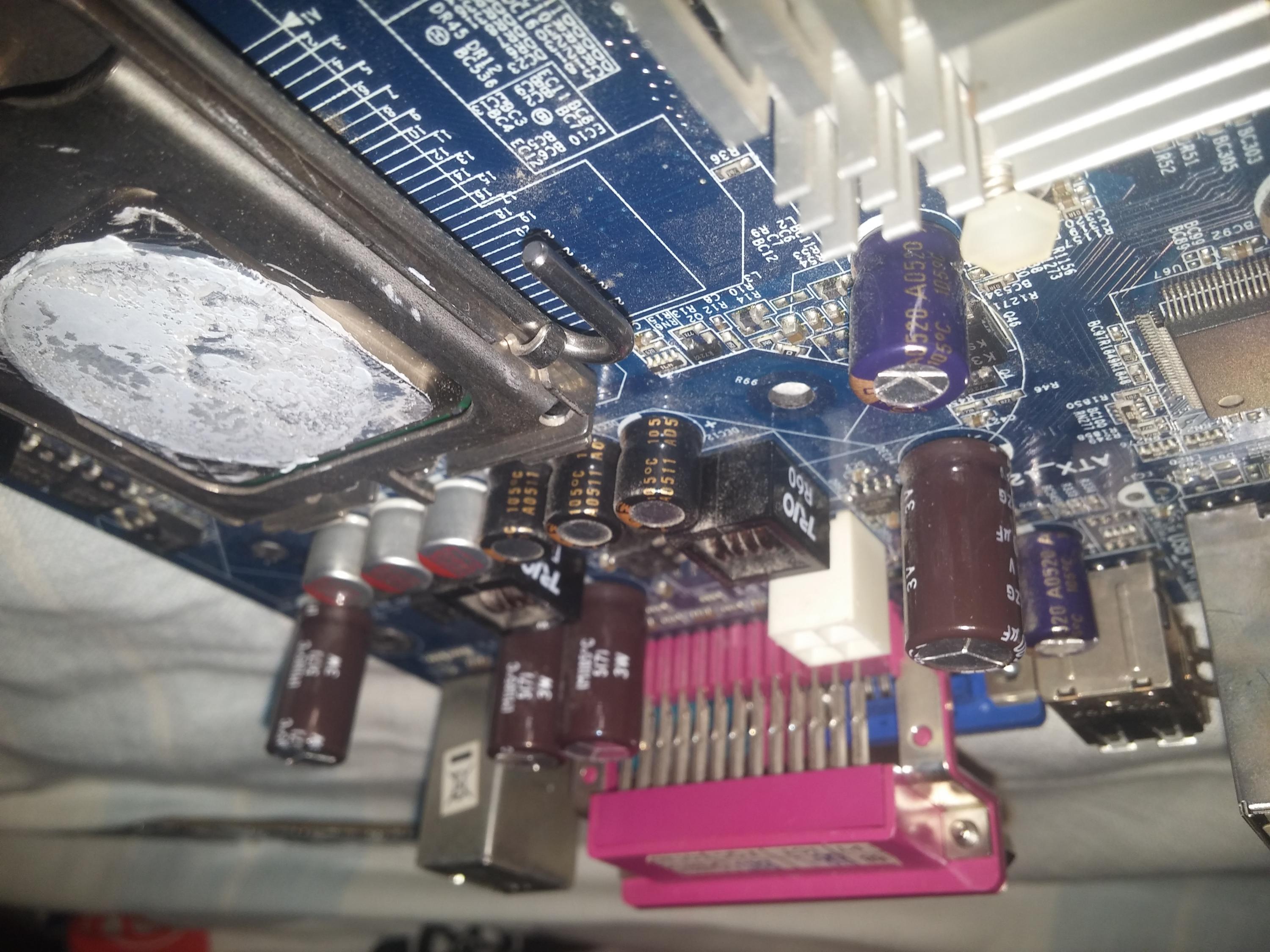

                      It started freezing today so i decided to finally recap it. Pulled those li'l suckers out and ONLY 1 was good on esr meter. Other 3 showed 800uf instead of 1500uf and 0.5 ohm resistance. After recap it runs like charm. Can u tell which one is good and which one is bad? (pics 2 and 3 also sorry for bad focus on pic 3). Pic 5 hn from the bottom.
                        That last picture looks like a Panasonic capacitor from the bottom, not a Nichicon. A Panasonic FJ, to be meticulous. Three of the four KZGs look like they have slightly bulging bungs (picture 4). Glad to hear you fixed it.
                        • nick122
                          • Jul 2016
                          • 110
                          • Slovenia
                          Ive actually deleted that pic (idk why) so i took a pic of panny fj because its bung looks the same as nichicon hn's and those little caps are pretty hard to unsolder.
                            Nice! Looks like another motherboard saved here .
                            Keep us posted if that really was the solution to your problem (longterm)... although with those KZGs reading nearly half their capacitance and high on ESR, I wouldn't be surprised if they have failed and caused the problems you were having.
                            That said, I am curious to see if these failed KZGs caps will pass the spark test - that is, charge each of the caps with a 12-15V source / power supply. Then remove the caps from the source and press both of the cap's terminals on a metal surface. If you see/hear a spark, they are either still working on not completely bad yet. But if you don't see or hear a spark, they are definitely gone. I can tell you from personal experiments that a 16V 1500 uF low ESR cap will definitely produce visible and audible sparks (but nothing loud, though).

                              If they read half the capacitance and 0.5Ω ESR, that tells me they're definitely goners. Although I think the highest recorded ESR reading of failed KZGs (bulging) was around 100Ω by PlainBill.
                              That being said, you have a point. If you go look at the UCC (not NCC) datasheets for their general purpose capacitors (85˚C or 105˚C general purpose), they actually list the highest acceptable ESR values at 120Hz and 20˚C. According to UCC, the highest acceptable ESR value for a 5x11 0.1uF 50V SMG is a whooping 1,989.0Ω ESR.
