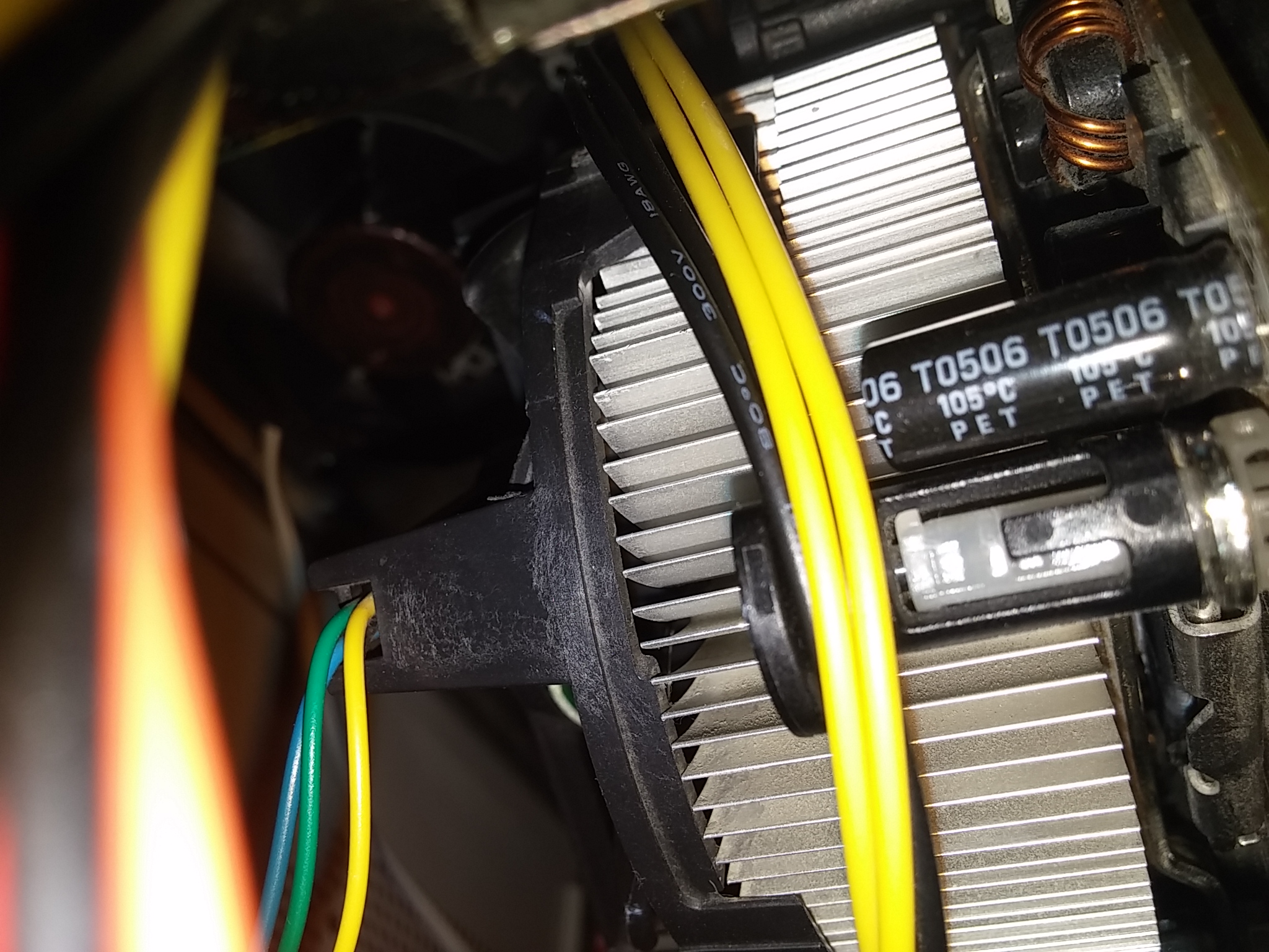

    The stock heatsink (pic 1). Also is is worth upgrading to pentium d 945? They are dirt cheap these days (like 2 bucks). Also I love these old school rigs they bring me back to childhood.
        Ah yes, looks like stock Intel heatsink. Does it have a copper-insert for the contact area over the CPU? I have one like that that does, and my CPU (a Pentium D 830, a 130 Watt TDP CPU) idles in the high-40's and low-50's °C in idle mode. I reckon I'd probably get similar temperatures to yours then under max load.
        Also, I feel stupid now asking you for a picture of the heatsink, because I see that there were pictures of it on page 1 of this thread.

        but i recommend getting a better cpu cooler (third party). the stock heatsink just mangles the board...
        I agree 100%.
        Either get a better CPU heatsink with a proper CPU backplane bracket or at least make a packplane bracket for the current heatsink you are using. Those stock Intel push-pin heatsinks really do warp the board too much. I suspect this causes way more damage to the BGA than heat from the CPU.
        Not to mention how fragile those push-pins get with time and temperature. Bump the computer a little more by accident and they will come undone and leave your CPU to overheat.
