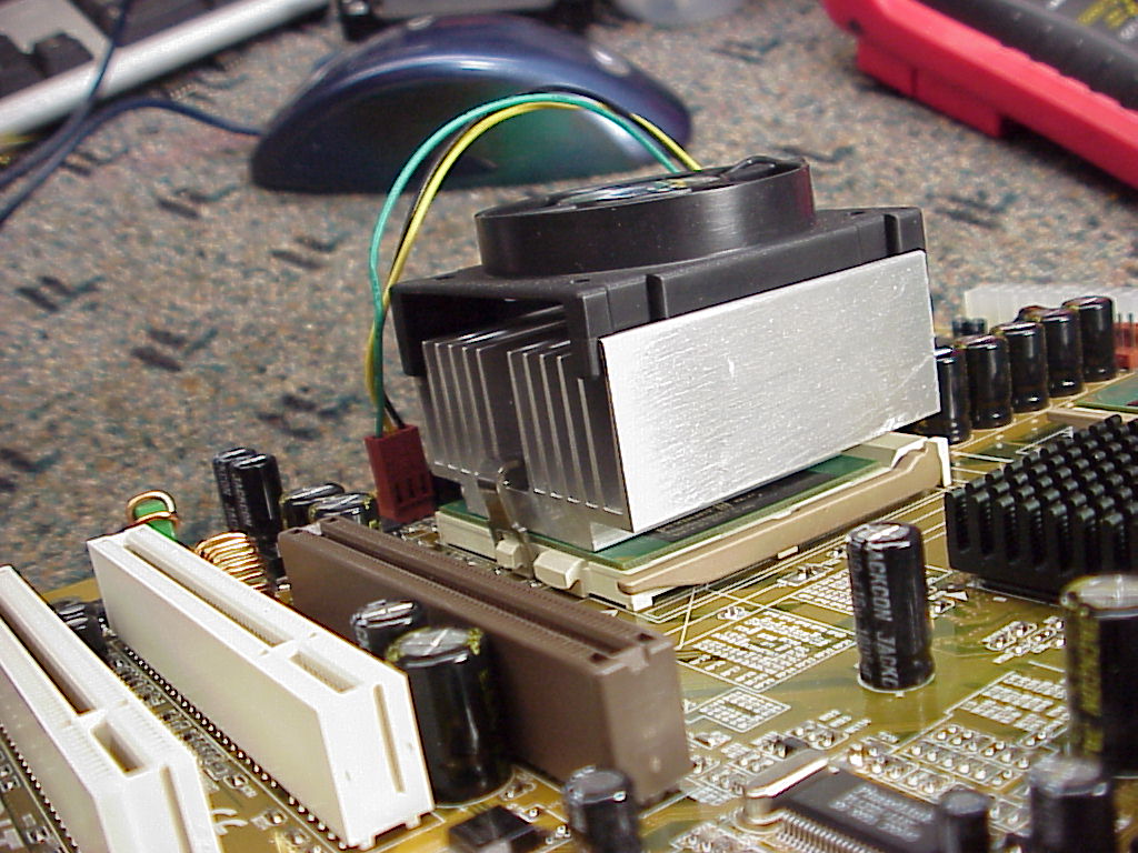

    I bought a Abit vp6 on ebay with 2 socket 370 tulatin 1ghz's. The gentleman told me that it was from a working system, but was pulled quite a while ago because the computer was acting weird. I thought maybe it was just the OS went bad, or other hardware. So i bought it, and ordered 2 heatsinks and a 512 stick of pc133 mushkin ram. It arrived, but the heatsinks were of very poor quality, so I got a refund from newegg (and i got to keep them, too ) and ordered some better quality ones for the same price. They arrived, they fit. So i seated the VP6 in the case, and hooked everything up, put in the AGP 4x Nvidia FX5200, sound blaster 16, 10/100 lan card, netgear 54G wifi card (all good because they are in the computer i'm using now,) and pushed the power button. No beep codes, all the fans spun up, but about 1 second later, I heard a loud POP, followed shortly by another. I hit the psu's power switch and ripped all the cords from the computer and pulled it out to see what happened.

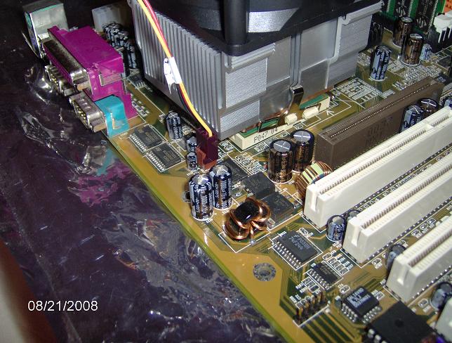

    Turns out two of the capacitors blew on the motherboard. All the mobo's capacitors are Jackcon, some are bowing out a little bit, may have to address those, but these two literally exploded (from the top luckily.) I hope it was just because it sat too long, and putting the power strain to run 2 1.75v processors that may still be overclocked if it ever was, and 2 80mm fans on the heatsinks was too much. I've seen bad capacitors, but I've never seen any explode, luckily no voltage regulators are out, there's no black spots on the motherboard, there was no smoke (except what I think was the hydrogen gas, correct me if i'm wrong, that built up in the caps that caused it to explode.) so hopefully I can just replace those caps, power it on, see if any more explode, and get on with finally using this mobo.
    Theres a attachment of the exploded caps

    and a recap should fix the board.jackcon are one of the first bad caps.now referred to as junkcon.
    i have rebuilt hundreds of these boards.so has topcat.
    you will also want his modded bios.

              so recap it already!
              last time i looked topcat had a kit for these on the badcaps.net store.
              bet it runs fine after a recap.
              dont run it anymore till you recap it or you run the risk of this.
              https://www.badcaps.net/forum/showthread.php?t=211

                        some of the d0 stepping cumines i have used have really good overclock potential.

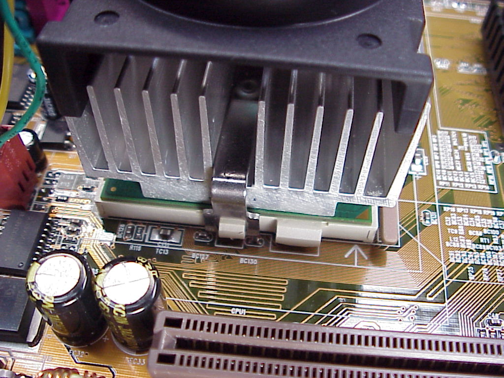

                        most of the thermal issues i have seen are the result of hsf that dont sit flat on the die.
                        this is a good example.
                        this is a intel hsf from a retail box proc.this vp6 is unstable partly due to caps and partly due to this hsf problem

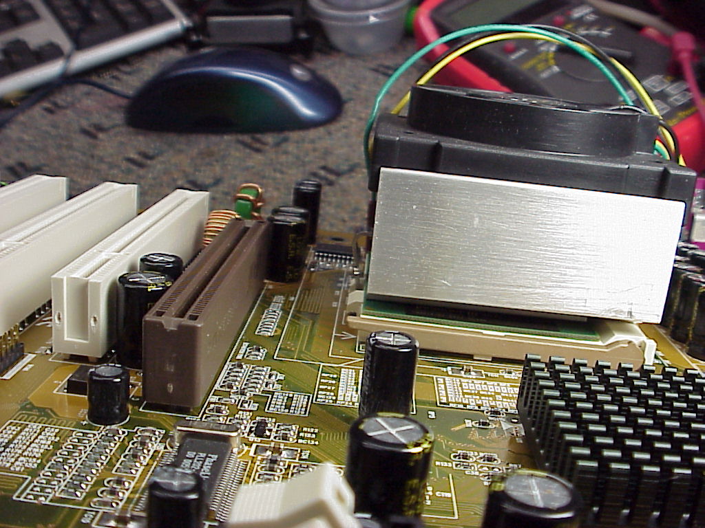

                          small heatsinks, thick fins and spread out, no wonder they don't work good. Did you see the ones on my vp6 up there? measure 80mmx80mm, but narrows at the bottom.
