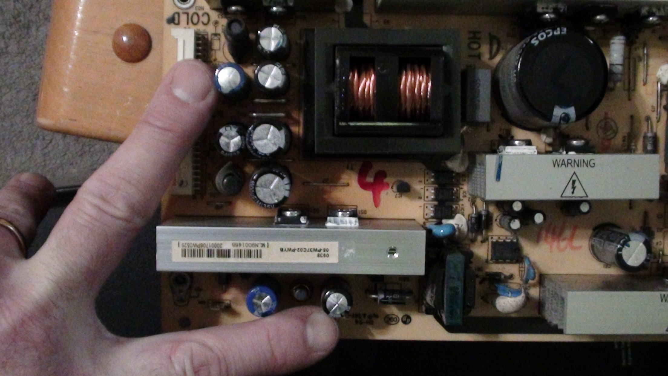

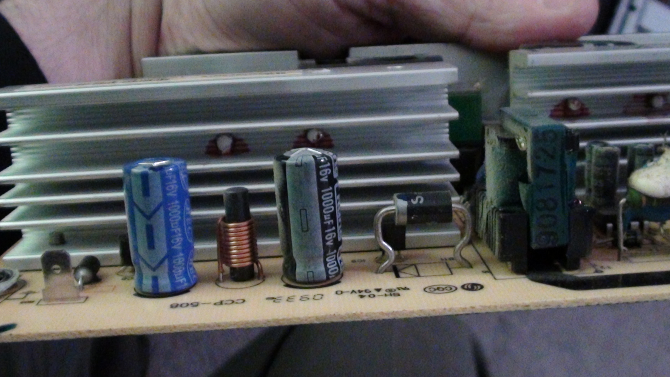

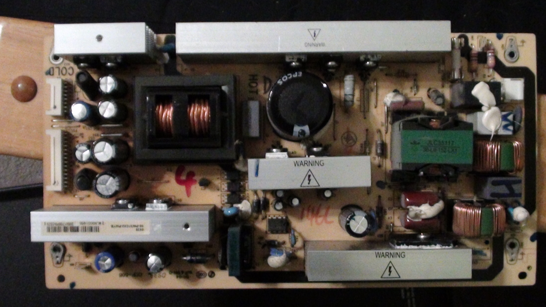

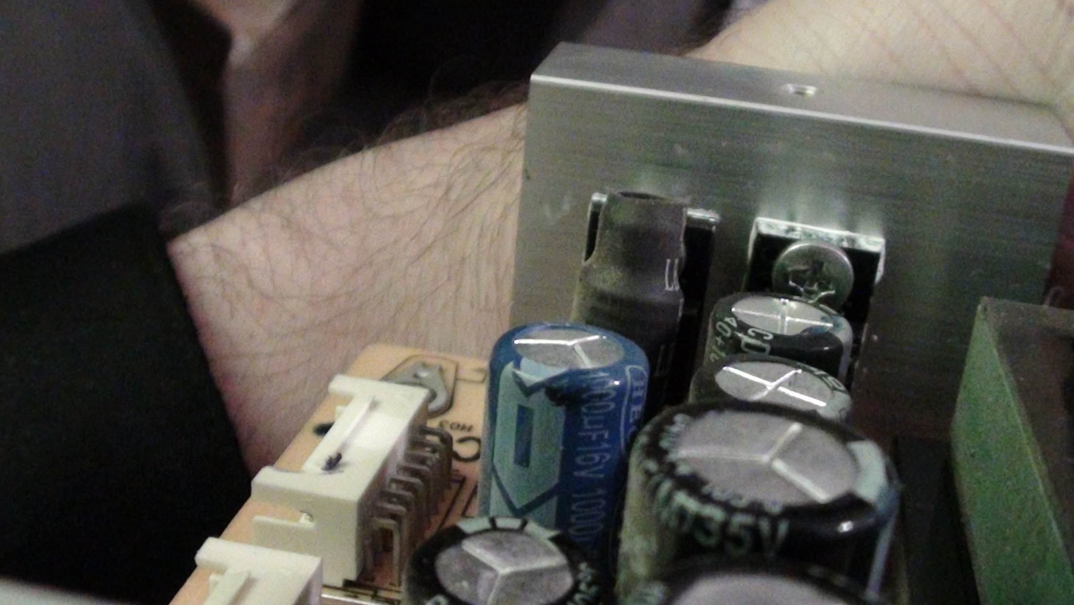

    I got a 40" TV here. It's my friend's mother's TV. It doesn't work. I crack open the case and find two bad caps, just by a physical inspection.
    Both are 1000uF, 16V but different manufacturers and are on the "cold" side of the board, I do believe (but don't quote me). The first is made by some company called Chang. The second is a blue one made by some company called HEC.
    I got a few questions. There's another 1,000uF 16V HEC cap and two 1,000uF 16V Changs left. I have three new Panasonic EEU-FR1C102L (FR Series, 105C) 20% 1,000uF 16V caps lying around in the work room. Should I use them to replace these two bad ones or should I order more and replace all of them?
    Here's some pics for people that like pictures.

    Re: RCA L40FHD41YX9 and bad caps
    Yes FR will work fine
