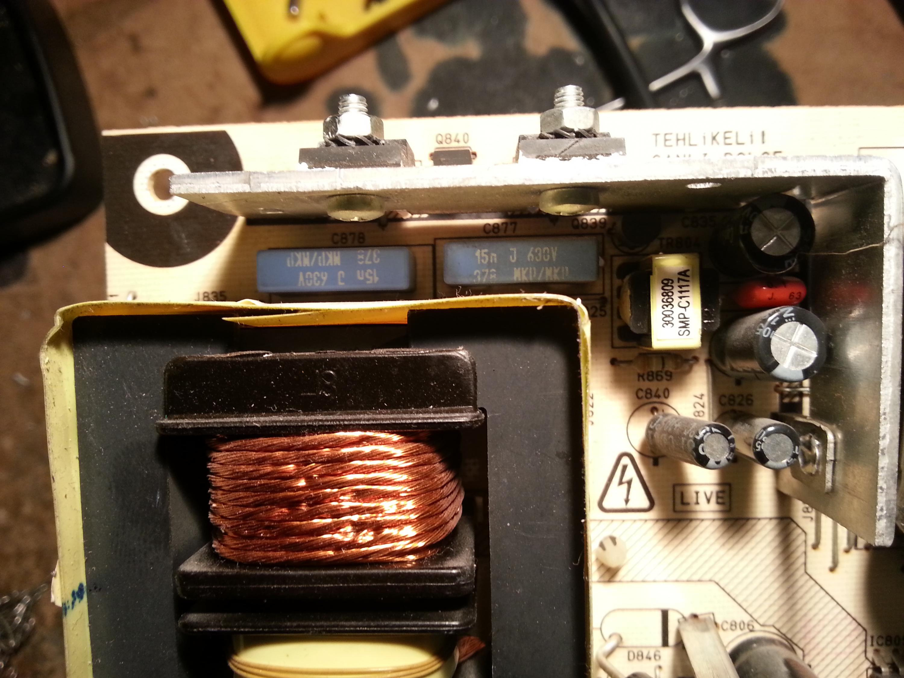

    Vestel C878 C877 suitable replacement
    I'm looking for a replacement for C878 and C877 on the Vestel power supplies. I have found these http://uk.farnell.com/wima/mkp1o1215...rad/dp/1890250 are these suitable ? Thanks
    • 31015
    Re: Vestel C878 C877 suitable replacement
    they look like a match if the pcb uses 15mm lead spacing.
    • diif
      • Feb 2014
      • 6978
      • England
      Cheers stj, correct lead spacing.
      • diif
        • Feb 2014
        • 6978
        • England
        Working like a charm. I had pulled them out of this PSU for use in another.
        Replaced the 78L05 and this one is now working.
