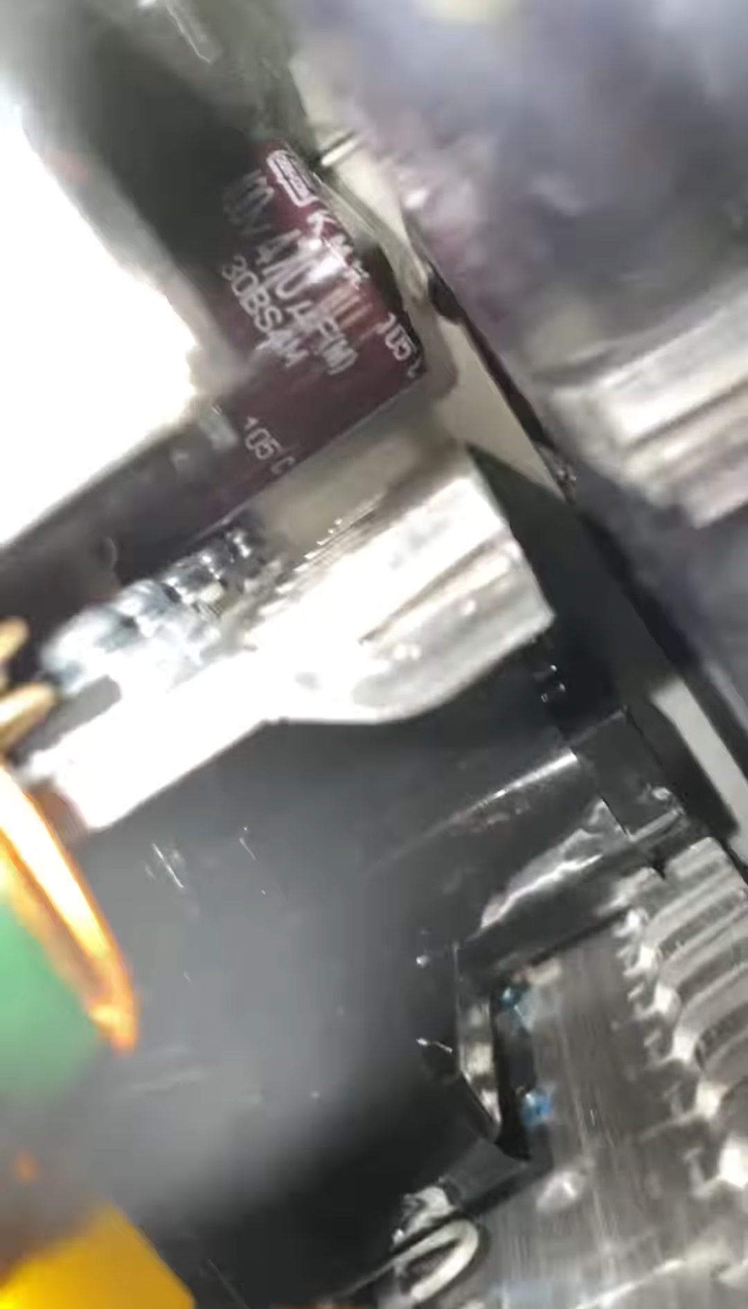

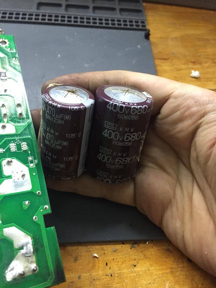

          #384
          Chemicon exploded in new psu​
          • RUllER
            • Jan 2024
            • 6
            #385
            Chemicon leaking from another PSU
