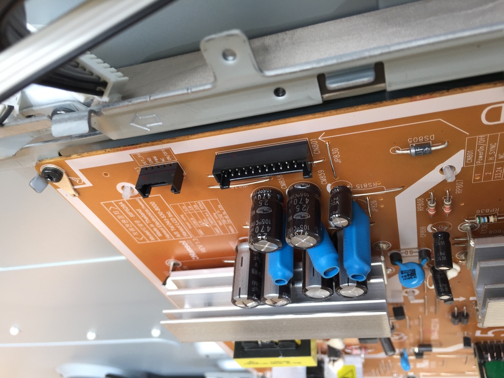

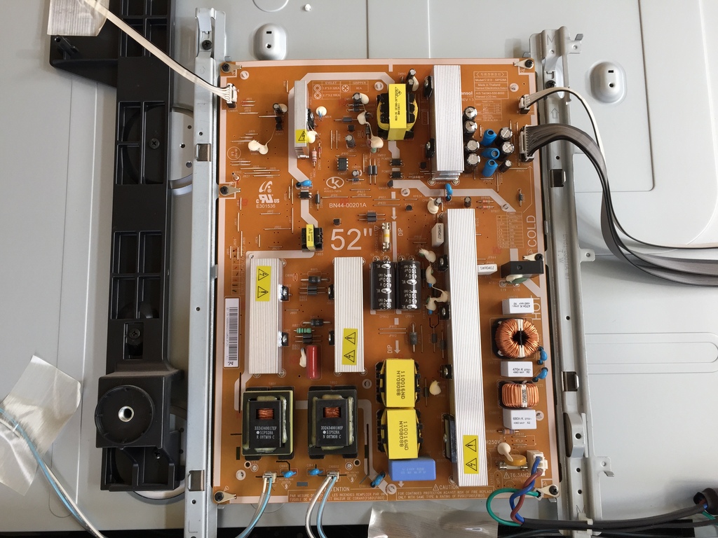

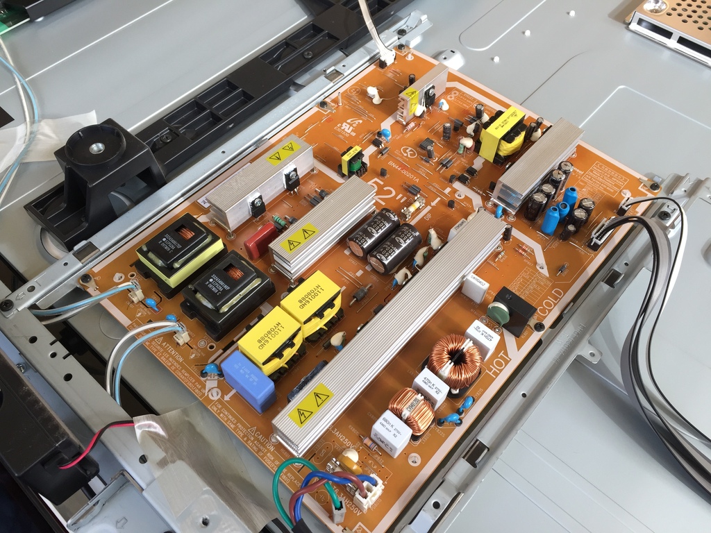

Just recently stopped turning on. It just clicks on and off repeatedly. Searched Google and had no idea so many people had the same problem. I bought it in 2008 so I'm happy it's lasted this long without any issues. I'll be even happier if it will only cost me a few bucks to replace a couple of bad caps.

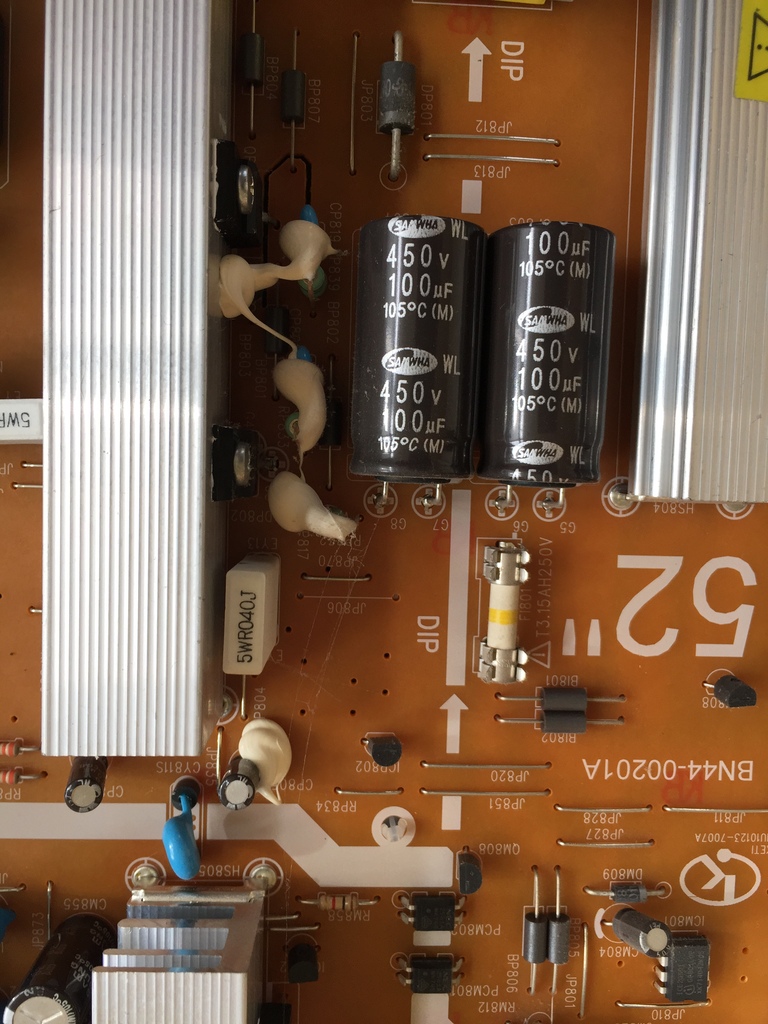

After reading this thread: https://www.badcaps.net/forum/showthread.php?t=7403, it sounds like Samwah caps are pretty low grade. It appears that all of the caps on my power supply unit are Samwah but only two appear to be bulging and leaking. I ordered this kit off eBay: http://www.ebay.com/itm/231464298499 which I think come with Panasonic Series FR caps.
My question is, would there be any benefit to replacing all the caps on the PSU or should I just replace the two that appear to be failing?
I've attached a few pictures of what I'm dealing with.
