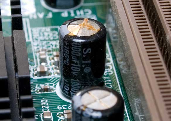

    I've noticed that some Intel boards on the forum are being recapped with higher uF than the original caps. What are the advantages of doing this and how do I know that recapping with a higher uF will not destroy my board?
    I will be recapping an Intel D865GLC and a FIC AM35 for the first time. The Intel has bad Nichicon 820uF 6.3v and the FIC has bad S.I. 1000uF 10v. I'm planning on replacing them with Panasonic FM equivalents, United Chemicon, or whatever I can get from digi-key.

    Attached image of bad SI cap.

      well there is firstly the esr of the caps to take into account, the lower the esr the less capacitance you can get away with. so say if you have a typical low esr cap 1000uf, you could replace that with a lower esr cap like 820uf nichicon HN, or rubycon MCZ or with a very low esr polymer cap oscon SEPC 560uf.
      these would probably work out ok
      intel makes the same kind of substitutions for vrm out on their boards, can be a mix of 820uf nichicon hn or 820uf rubycon mcz or 560uf oscon sepc polymer or 560uf fujitsu polymer etc or just one of these types in a row instead
      on the other hand of course if you have an 820uf nichicon HN then it would be ok to use a cap with higher esr like a panasonic fm but at 1000uf. It would be also quite reasonable to use 1200uf or 1500uf. These would be acceptable substitutions. ideally if you are using the next step up in capacitance its perfectly fine. generally the board manufacturers are using the minimal bulk capacitance, some are worse at that. so if you take that into account then you dont worry about increasing the total capacitance. it may increase overclocking performace but who knows.
      i think its best to stick with similar or lower esr caps in the critical areas like vrm out and vdimm out though otherwise overclocking performance would probably be affected. I am not talking about capacitance here though, just esr.
      still the board is not going to catch fire or something if you mess with the capacitance. it will affect functionality if you use general purpose caps ie not low esr caps though.

        Thanks willawake! So the crap Nichicon 820uf are a lower ESR than the Panasonic FM? I looked at the digi-key capacitor catalog, but didn't see any ESR mentioned in the product specs. I was going to get Panasonic FM because I was going to combine them with a non-related digi-key order. What is your recommendation for Nichicon replacement?

            which series was used on this board? If HM i think the Panasonic FM should be fine, if HZ then may be a ultra low esr series would be better.
            For the FIC board the FM`s are pretty sufficient.

                The Nichicons on the Intel are labeled HN(M) and all but one are located in a line along the CPU. Along with the Nichicons are yellow 560uf 4v that don't look damaged. I didn't want to remove the heat sink to see what brand they are, but they look exactly the same as:
                https://www.badcaps.net/forum/attach...achmentid=4169
                https://www.badcaps.net/forum/attach...achmentid=2424
                I think I'll forget the digi-key order and get some Samxons or Rubycons from Topcat to replace the bad Intel Nichicons and the SI on the FICkle board.

                  If it helps the the original rating on the SI 1000uf 10v is Ripple 710 and ESR .090
                  SI only has one series of 105c caps.
