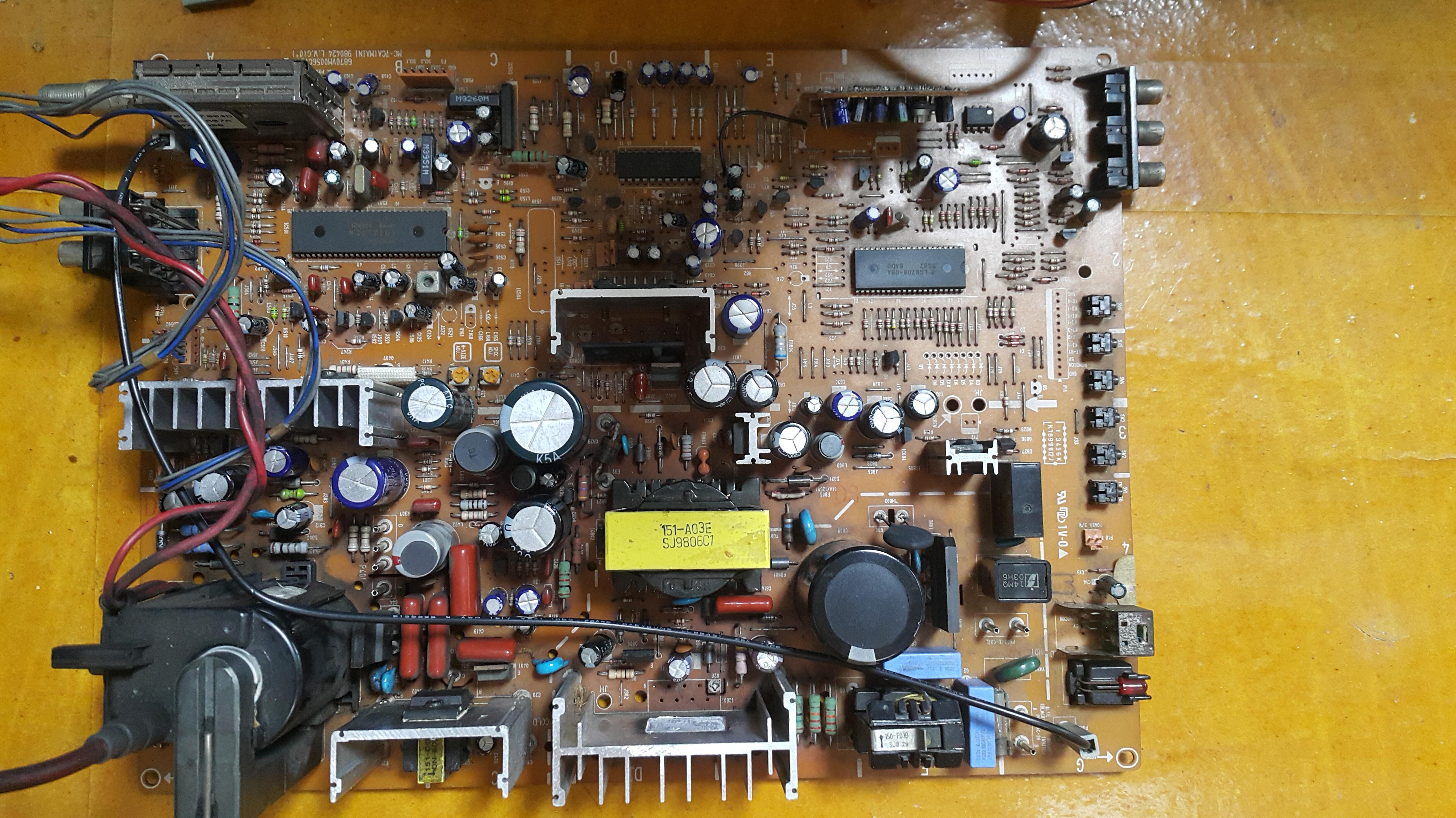

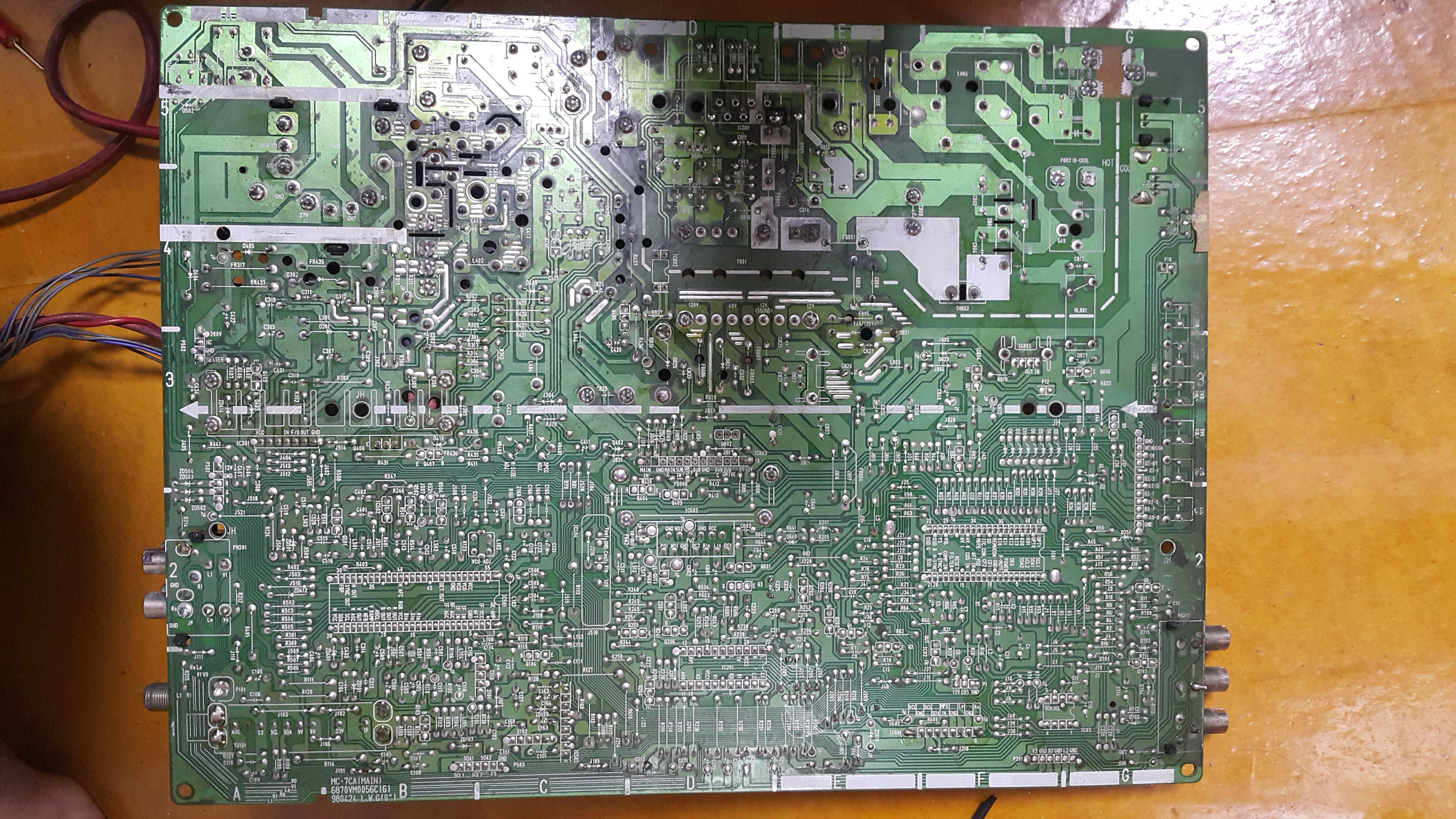

        Thats what I suspect, can you post the make and model or service manual? or maybe post some pictures of the board.
          partnumber on the surface of main PCB and small PCB is
          MC-7CA(MAIN) 6870VM0056C(6) 980424 L.W.G(0)
          MC-7CA(CPT) 6870VS0167A(1) 971014 K.J.B(0)
          and model number of This LG CRT TV is CN-29H3
          Frankly speaking,I posted a thread about this CRT TV in the reddit forum.But It seems that there is no way to find the culprit of no display symptoms.

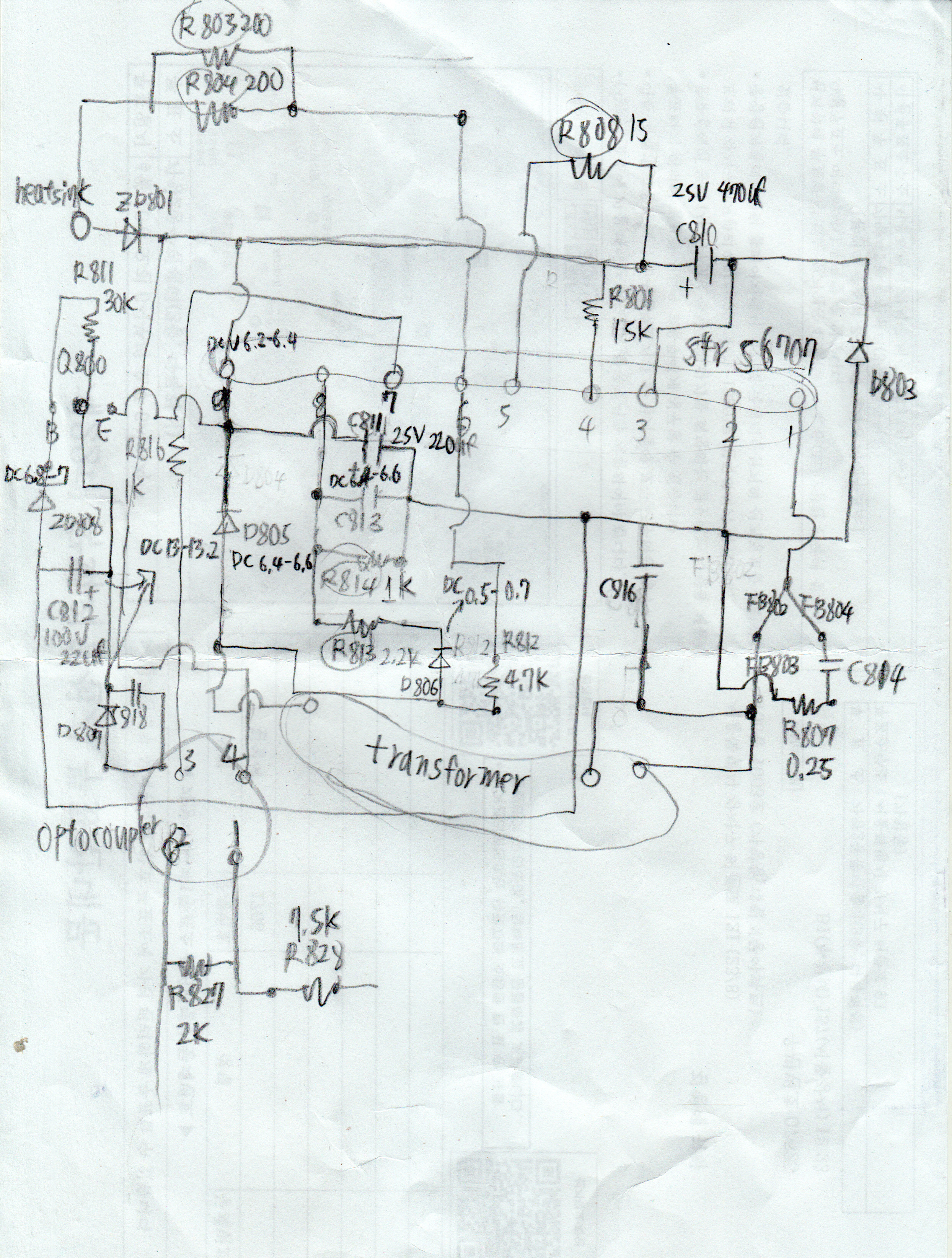

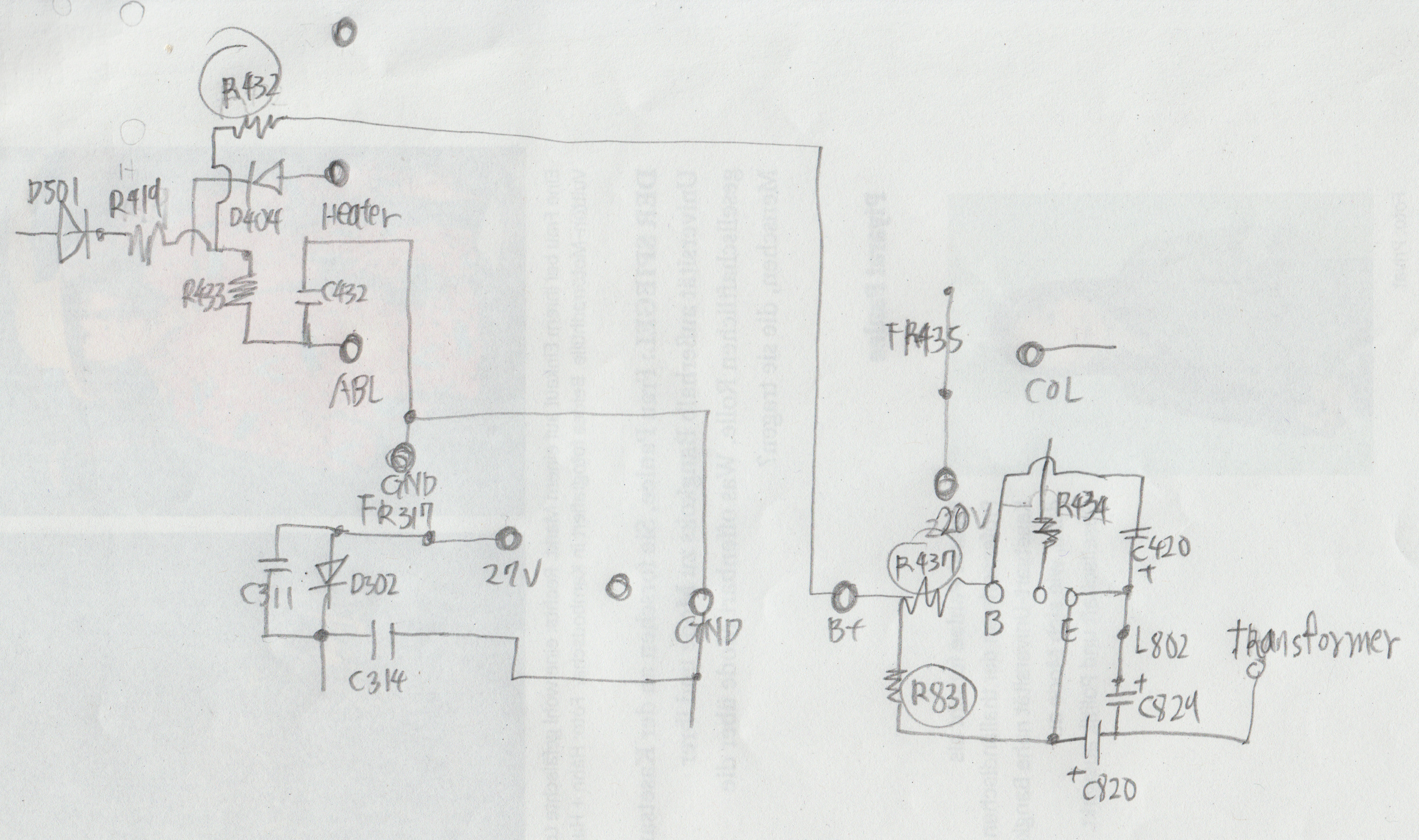

                          I roughly draw most of flyback transformer's soldering point and its nearby components on the circuits.
                          I noticed that B+ soldering point is coupled to three carbon resistor(R432,R437,R831) and C829 is the big capacitor.
                          Should I isolate B+ soldering point by desoldering these three carbon resistor(R432,R437,R831) from circuits In order to connect 240v lamp and test it?
                          And where should I solder 240v lamp on the bottom of PCB?

                            is this similar?
                            check the H46 schematic - L853 inductor left of the transformer
                            or H90?
                            lift R402
                              This is likely the schematic. I would replace the small electrolytics in the power supply primary, they are likely weak. C812, C810, C811
                              This tv power supply is always running when it is plugged in so those caps take a beating. C810 is right next to R807 which would cook that poor electrolytic

                                You can compare STR-S6707 area in the MC-7CA schematic to my drawing of circuits which contains resistor and capacitor near STR-S6707.
                                Click image for larger version  Name:	scan0001.jpg Views:	0 Size:	2.68 MB ID:	3297034
                                I already have measured ESR ohm value of all capacitor with ESR meter(MESR-100) and checked most of diode and carbon resistor in the STR-S6707 area and I replaced C810(25v 470uf Korea chemicon KME) and C811(25v 220uf samwha RG) which has higher ESR ohm value(C811 was measured over 70 ohm)
                                But it won't repair black screen symptom..
                                  The strange thing is whenever I measure the DC voltage of pin#9 of STR-S6707, It is measured 6.4V.
                                  As far as I know,It should be measured at least 7.6V in order to go On-State Voltage.
                                  I doubted any diode near STR-S6707,So I checked it using analogue meter(x10 ohm) But It showed only one reading with the correct and opposite polarity of probe.
                                    What is the voltage across C812? it needs to be at least around 9vdc to supply the regulator transistor Q800 collector. Q800 base should measure 7.5vdc, if not ZD808 may be leaky and not zenering at 7.5vdc I would have also replaced C812
                                    If Q800 collector is over 9v and the base is 7.5v and the emitter is only 6.4v, Q800 may be bad

                                      I just have measured DC voltage of C812 by placing red probe to positive terminal of C812 and placing black probe to negative terminal of C808 in HOT area(400V 470uf the biggest capacitor in the circuit).
                                      It was measured 10.8DCV.
                                      And I measured cathode of ZD808,It was measured 7.1DCV and Q800(C3852A) base was also measured 7.1 DCV.
                                      Q800(C3852A) collector was measured 10.8DCV.and pin#9 of STR-S6707 was measured 6.4DCV.
                                      I desoldered C812 and I check it with LCR T4 meter. Its capacitance was still within 10% tolerance(23uf) and Its ESR value was lower(0.5 ohm) than reference value.
                                      By the way it was written B.75 on the surface of ZD808 zener diode.
                                      Is It Okay to purchase any zener diode which has specification of 7.5V?
                                        I replaced ZD808 zener diode with 1N4737,But it won't repair black screen symptom,and there is no difference between these zener diode in measuring cathode voltage(7.1Vdc)
                                        I think that I need to connect a 40w 60w bulb to B+ soldering point of Flyback transformer,But I don't know the process to substitute for the Flyback's B+ Load with a blub in detail.
