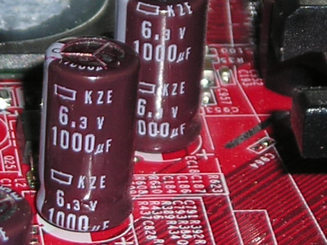

    Can a Cap be bad and not look like it?
    Hi everybody glad to be here, first time posting... If I may can someone shed some light on what I have going on?
    I diagnosed my problem to the motherboard, its an MSI MS-7093 Ver.1.0
    I don't know much about caps, but I really would like to start learning so I'm happy I found this forum. I'm just a home enthusiast who has more running and non-running computers one should have in a small home.
    This is the first mobo I came across that I don't see the caps are obviously blown or bad. everything points to the board is the problem.
    In general when I do have a bad board with blown caps it gets tossed out, it seem to be such a shame if there is a fairly decent fix to be had.
    But now with this very nice unit I have a problem with I wondered how are caps checked if no sign of failure? with an olhm meter? or do they have to come out to be checked?
    thank you for any insight you would like to share.
  • joeeye
    • Apr 2007
    • 18
    Re: Can a Cap be bad and not look like it?
    There are many caps of all sizes and many of the same type, each group that are all the same kind of cap all measured the same reading with an olhm meter.
    But there are 8 caps which are the KZE 6.3 v 1000uF, there are something like 4 of them out of the 8 that read the same resistance, and the rest of the other 4 have all different numbers of resistance. I feel like these few caps I found are not doing well.
    Any help is welcome...
      Caps can fail without any sign
      It is more common for the lower farad units to fail with no sign at all
      But some brands are known to usually not fail with any signs, like TEAPO
      To test a cap you must use an ESR meter, see the "Test Equipment Usage, Techniques, and Reviews" forum section for more info

              • gdement
                • Jan 2007
                • 690
                The caps that have the same resistance reading are connected to each other in parallel, while the others are not. The only way they'd lose connection to each other is PCB damage or bad joints, not bad caps. They're probably not supposed to be connected.
                KZE's are United Chemicon caps, they're very unlikely to fail. Have you tried alternate PSU's?

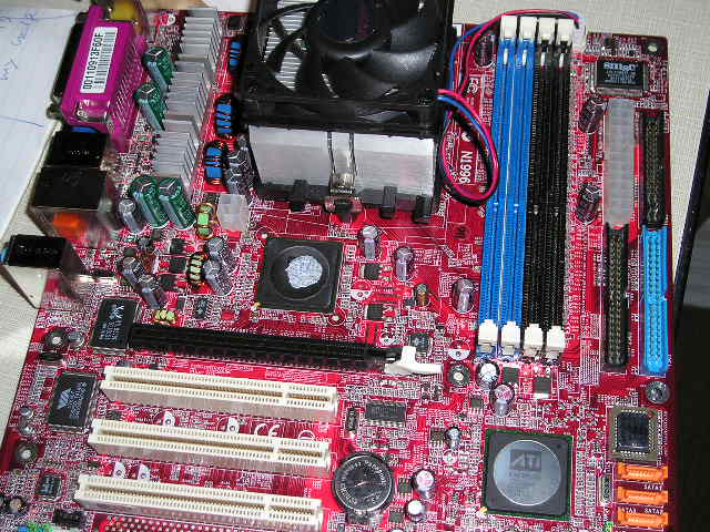

                • joeeye
                  • Apr 2007
                  • 18
                  Originally posted by willawake
                  why dont you give more info about your board problems so we can assist?
                  Sorry, I'm doing 6 things at once here and I'm forgetting what I did, plus would you believe I never sent pictures to a forum before.. so I need to learn how to do that now.
                  Give me a moment, I'm trying this picture thing... thanks...

                    • joeeye
                      • Apr 2007
                      • 18
                      Okay, here is some info, plus I understand what was said about different readings with the same cap, this is all great stuff I'm learning, thank you very much.
                      Please let me know what other info you would like to know, like do you want the specs on all the rest of the other caps? like their size, etc...
                      The mobo is a MSI (MS7093) also it says N1996 near the memory, the chip set is ATI IPX 400.... 939 socket with a 2.4 CPU.
                      • willawake
                        Super Modulator
                        • Nov 2003
                        • 8457
                        • Greece
                        caps look ok.
                        what is your issue exactly?
                        test your ram and report back

                            Let me ask this about ram, even if it was bad ram would I still get a responce as if its not plugged in? I thought with bad ram I'd at least hear beeps, or at least the power unit would come on? this is the first time I'm getting a unit acting like its not plugged in and I've tried a few other working power units. humm??
                            • willawake
                              Super Modulator
                              • Nov 2003
                              • 8457
                              • Greece
                              so your board is dead? no POST?
                              • joeeye
                                • Apr 2007
                                • 18
                                yeah, complelety stone cold dead, like not plugged in...

                                  • willawake
                                    Super Modulator
                                    • Nov 2003
                                    • 8457
                                    • Greece
                                    can you try cpu in a known working board?
