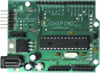

              The directions say to use two 100uf caps; below is a link to what I'm building a chipino (like arduino but with Pic chip).

                Well, looking at the schematic:
                https://cdn.badcaps-static.com/pdfs/...13bd74d3c1.pdf
                You don't need 100uF capacitors.
                You can see the 100uF capacitors are before and after the LM7805, which is a linear regulator that produces 5v from anything that comes through that power jack.
                The user may plug a 9v battery, or a 7.5v DC power adapter, or a 9v adapter... some adapters are unregulated meaning a 9v adapter may give you 10-12v at low current loads and get near 9v only when you pull a lot of current.
                So at the input, a capacitor rated for 16v is a must, I would even go with 25v rated capacitor for safety.
                However, 100uF isn't really required, some would say even 10uF is enough. I would choose a 33-47uF capacitor, which should be enough.
                Now, the LM7805 produces 5v from anything you have at input, so at output you will never have more than 5v. Therefore, even a 6.3v rated capacitor at the output would be enough, but I would go with a 10v or 16v rated capacitor just because there's not much difference in diameter and height of a capacitor between a 6.3v rated capacitor and a 16v rated capacitor.
                Again, 100uF at the output is a lot and unnecessary, the 7805 doesn't need that much, even 10uF would be enough but again, 33-47uF is what I would use.
                What's missing from that design is a 0.1uF ceramic capacitor put in parallel with C2 for extra filtering of the input power. A 0.1 50v rated ceramic capacitor, X5R or X7R would be perfect.
                C1 could be the same, a 0.1uF 50v ceramic... you really don't need mylar capacitors which are expensive.
                Same with C6, it doesn't have to be mylar, it makes no difference if it's mylar or ceramic.
                The C6 capacitor is a decoupling capacitor and is technically required only if the 5v is generated far away from the chip, let's say if there's more than 2 centimeters on the pcb between the C3 capacitor and the Vss pins.
                However, in practice, it's really recommended it should be put on board, and it must be as close as possible to Vdd and Vss.
                Some other suggestions... LM7805 is a generic, cheap voltage regulator. It needs about 1.2v ABOVE 5v to produce 5v, if the input voltage goes below that you won't get 5v.
                There are much better linear regulators that don't require that much input voltage to produce 5v and at the same time don't take as much space on the PCB. You can see in the PCB design that a to220 package takes a huge amount of space and there's really no benefit to using something like that if you're not putting a heasink on the back of the regulator. The picture doesn't show a heatsink.
                If you power the board from 9v and your board uses 50mA for example, which could be a bunch of leds, your regulator would dissipate (9v-5v)x0.05A = 0.2 watts as heat. That's enough to get that metal back side of the linear regulator relatively hot.
                If you want cheap and with the same performance, you can use something like this:
                http://uk.farnell.com/diodes-inc/ap1...223/dp/1825292
                http://uk.farnell.com/on-semiconduct...pak/dp/2296057
                http://uk.farnell.com/texas-instrume...ter/dp/1685604
                They both take less space on the pcb, and you can basically solder that tongue on the pcb and dissipate a bit of the heat through the pcb copper.
                They're not through hole but they're large enough you could solder by hand.
                An additional suggestion I really recommend is to add some protection against reverse voltage coming from the input power jack. As your circuit is right now, if you use an electrolytic capacitor at the input (C2) and you plug the input power the wrong way, you're basically damaging the C2 capacitor (it may smoke or blow out).
                A simple diode connected between input voltage and ground could be enough, basically shorting the battery or input power if you put it the wrong way around.
                A smarter way would be to use a p-channel mosfet to protect the regulator. This video explains it very well, watch it:
                http://www.youtube.com/watch?v=IrB-FPcv1Dc
                For p-channel mosfets something like this could be enough, and cheap (they'll tolerate up to about 12v at the input connected the wrong way around):
                http://uk.farnell.com/nxp/nx2301p/mo...3/dp/1894738RL
                http://uk.farnell.com/nxp/pmf170xp/m...323/dp/2069557
                http://uk.farnell.com/nxp/nx2301p/mo...t23/dp/1894738
                Another observation... the schematic shows C4 and C5 as 20pF (picofarads). The component list says 22nF. The actual capacitance for those capacitors depends on what oscillators you buy. Some oscillators require 18pF, some oscillators require 22pF, when you buy the oscillator look at what the manufacturer recommends in the datasheet.
                Also note that there are some new PIC chips that can work at 20 Mhz, so using a 20Mhz oscillator instead of 16 Mhz could be nice. If user wants less than 20Mhz, he can choose to use the internal oscillator (which has slightly less accuracy than a dedicated external oscillator). But it depends on what PIC you use. Even the PIC16F886 they mention in the schematic supports 20 Mhz oscillator.
                If you replace the to220 linear regulator with something smaller, you could fit a 40pin DIP chip instead of limiting yourself to just 28pin socket.
                Something like PIC16F884 or PIC16F887 sounds good, it has all the goodies (i2c, spi, usart, eeprom etc) :
                http://www.digikey.com/product-detai...2FP-ND/1015608
                http://www.digikey.com/product-detai...2FP-ND/1015601
                PIC16F886 they mention is 28 pin and the only difference is that it has twice the amount of flash space compared to PIC16F884. The comparable chip with 40pin dip package would be PIC16F887.

                    • u271D
                      • Sep 2013
                      • 59
                      • Ukraine
                      Re: Where to buy caps?
                      Thanks both of you for your input.
                      The below picture in the one I'm building with the two missing caps C2-C3.
                      The Chipino has two regulators a TO-220 5v and a TO-92 3.3v
                      I'm going to try and find a small screw/bolt to go through the TO-220 and solder the back side. The back is a ground plane, plus screw = more thermal mass.
                      From the pic you should be able to see the 5v reg; it's a ON MC7805CT, 2V dropout. It's simply one of the 7805's I already had on hand; like most of the parts. I looked at the spec sheet and ya it shows a 0.33uf input cap and for output an optional 0.1uf or greater to improve transient response. The other caps are Joe Knows Electronics 50v. The resistors are Joe Knows Electronics 1/4W 1% again stuff I had on hand.
                      Armed with this knowledge I'm sure I will be able to find caps that will work.
