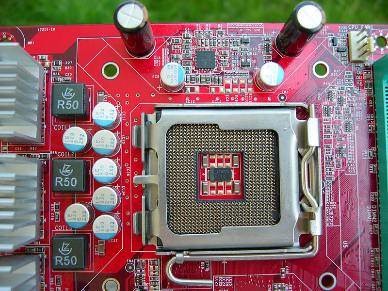

    Guys, I have my ideas about what it is, but to be sure, I need verification. So, the capacitor is a small SMD suxxka, d6.3 for the round part and it looks like this one:
    However on the cap is with black print (the negative is also black as on pic) this:
    t3
    100C
    UD
    The card is relatively older (2005 or 2006) and I measured the voltage on the cap already (3.4V), so I need more or less confirmation on the capacitance. My quess is obvious (100uF), but someone can back my quesses with facts?

    maybe nichicon UD series?
    • mariushm
      • May 2011
      • 3799
      Re: Capacitor identification
      Nichicon UD 100uF 16v
      6.3 10 16 25 35 50
      j....A....C..E...V... H

        Pentium4 - mariushm - thank you very much, guys! You seems to be correct. Nichicon UD datasheet confirm this:
        And Digikey.com agree:
        http://www.digikey.com/product-detai...62-1-ND/590237
        Good to know that I was not mistaken. The "t3" worry me a bit, but documentation say, that this is just a Lot No., so probably nothing to worry about it.
        Any ideas what similary looking SMD cap, but just d4 is? On it are:
        10
        16s.
        005
        10uF 16V...? Or 16uF 10V?

            Capacitors are pretty much made with standard values. 16uF isn't a standard value for capacitance, but it is one for voltage.
            So it makes most sense to be 10uF 16v.
            Though, that capacitor is kind of big for a 10uF 16v capacitor.
            Why are you messing with it anyway?

              Concur with mariushm. 10uF, 15uF, and 22uF are fairly common standard values, but not 16uF. Compared to the nearby SOT-23-style and D-PAK devices, I'm not sure that cap is large for 10uF, 16V, though.

                Well, it is a d4 in diamater, so in reality it is pretty small. Yet still I thinking about bumping the capacitance to 22uF - a nice SMD ceramic cap can easily are todays 22uF - even smaller 1210 size that I wanted it to be (1812, 1808)...
                And I believe that this cap might be responsible for some of my stability problems, as there is a 1.55V (AGP voltage) on it...

                  I wouldn't recommend using a ceramic capacitor there. High capacitance SMD capacitors have... problems.
                  If you really want to, I'd suggest a polymer capacitor, I guess these would work:
                  http://www.digikey.com/product-detai...3-1-ND/3465979
                  http://www.digikey.com/product-detai...9-1-ND/2327075

                    Well, I have the very same feeling, that it might not be best idea, because the ceramic cap characteristic are way off the classic elyte cap.
                    However there is a problem. I would use polymer, BUT it must be d4 ... your tips are d5 and with all the help and skill - they cannot fit there. Guaranted. I will have to even desolder the close cap to get desoldred the old and soldered new cap.
                    There is simply no way to fit a d5 there. Believe me. I would love to, but I just... can't.
                    What problems plague these hi-capacitance ceramics anyway? There are even 47uF 6.3V ceramic caps:
                    http://www.digikey.com/product-detai...6-1-ND/4157642
                    I was under the impression that these would be beneficial for example right under the CPU, where is place for lot SMD ceramic caps and the place is... empty:

                      Potential problems with SMT high value ceramics:
                      1. Temperature coefficient;
                      2. Voltage coefficient;
                      3. Cracking with larger parts.
                      So, the part you linked: X7R is OK, the "worst" tempco that should be considered for GP usage; 1210 is probably OK for susceptibility to cracking; 6.3V ... to avoid the voltage coefficient becoming relevant, the part really should be rated for at least 10X the circuit DC voltage. Now, a 22uF, 16V (or 25V), 1210, X7R might be OK (I have a hard time saying that, I have such a visceral dislike of SMT ceramic caps).
