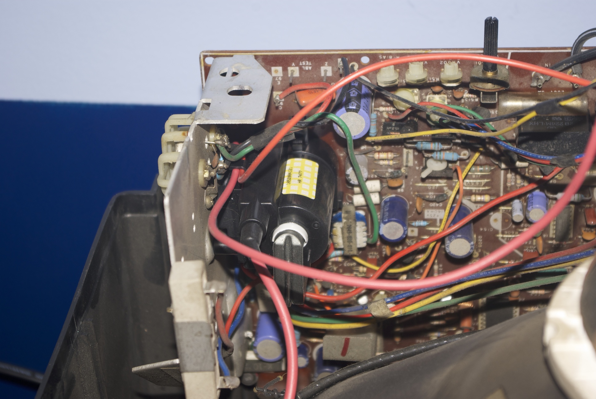

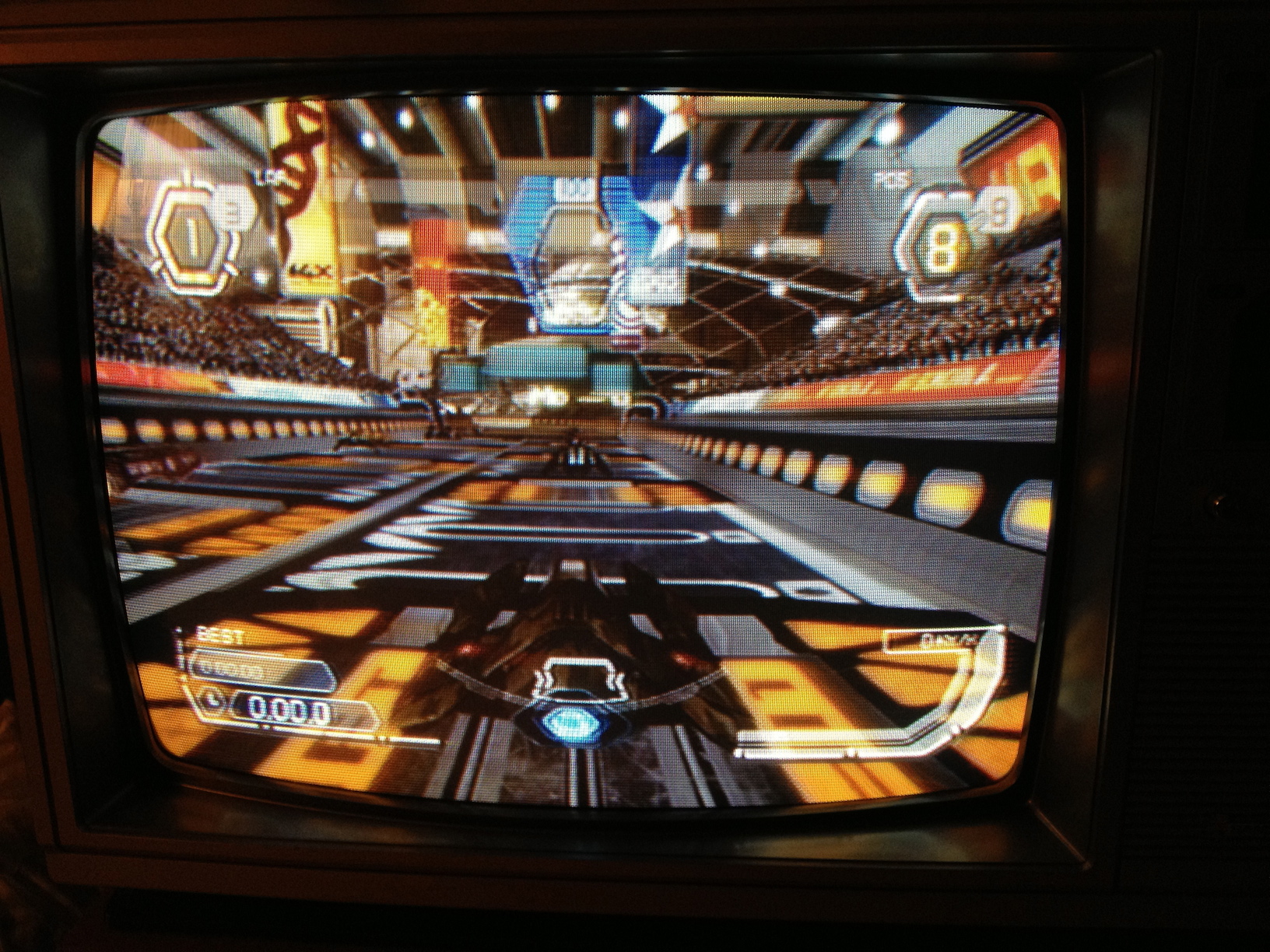

    Caps that appear fine still
    So I have an old television from around the early 80's. It's an old Samsung with Samwah and Samsung branded caps. The caps appear to be running completely fine still, even after many years of service. The picture is strong, bright, and vibrant. Only oddity is the speaker has a slight buzz to the vertical refresh rate (60Hz on NTSC sources and 50Hz on PAL sources). This to me inclines one of the caps may be going out of tolerance, but everything looks great inside, no buldges, nothing leaking, and when i run an ESR test on each cap, they actually pass.
    If they still pass an ESR test and the picture still looks good, case of don't fix if it ain't broke, or replace anyway? Thing is the buzz on the speaker may have just been a design fluke since the audio isolation transformer on it is directly under the CRT's yoke.

    Re: Caps that appear fine still
    How do you know you're getting reliable ESR measurements when testing the caps in circuit?
      I never measure in circuit, too many variables can affect the outcome. I removed them from circuit.

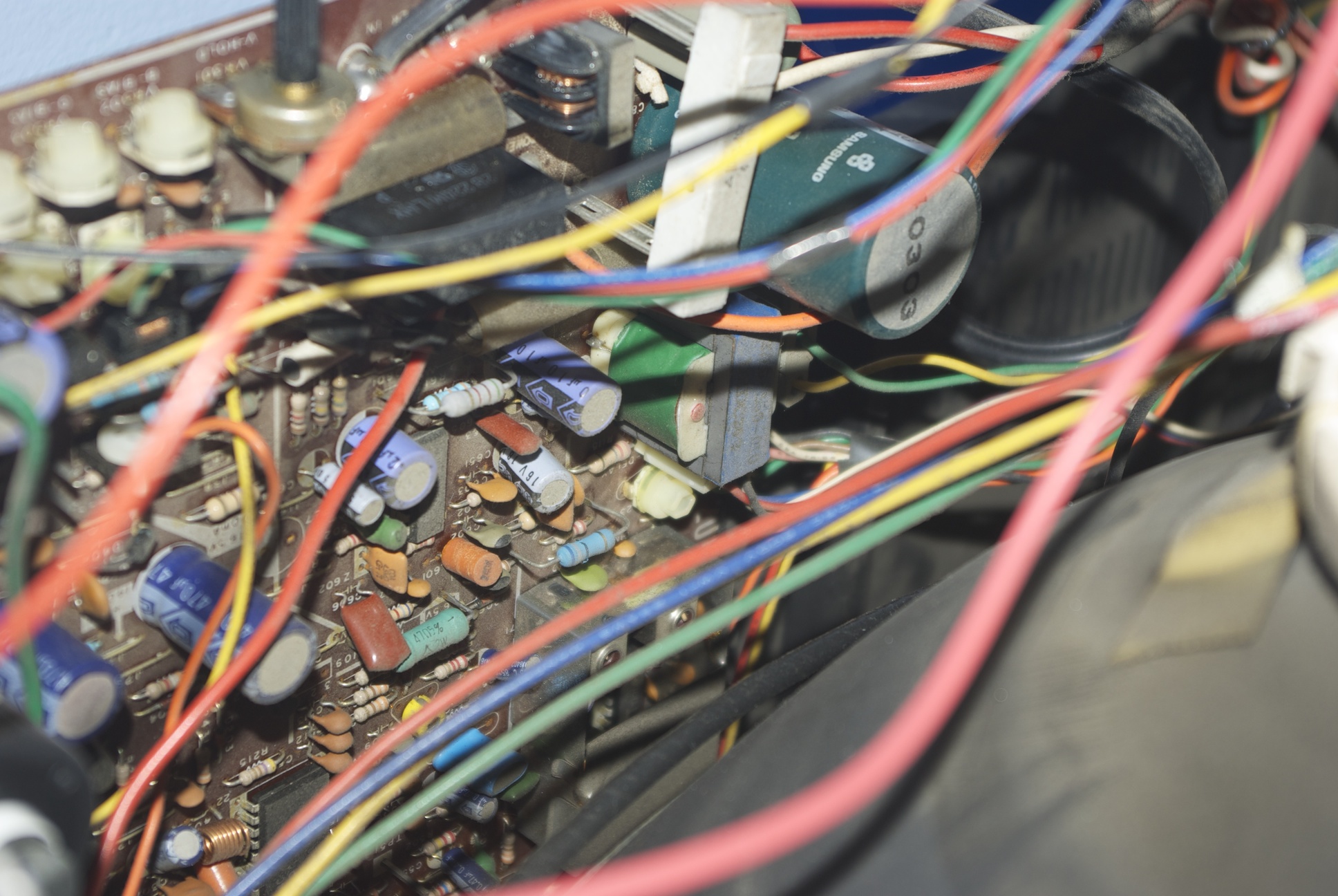

        I still am betting that the cap(s) might be the problem.
        Besides, what esr ratings/charts are you using? Usually these are just generalized values, so a low esr cap which reads a bit higher in esr (like that of a non low-esr cap of the same capacitance/voltage) would be 'fine' - according to the chart, that is!
          ben7 makes a good point. How do you qualify "passes an ESR test"... There are probably no series markings on these ancient caps. I've watched some arcade refurb videos, and TV re-caps are almost always done on cabinets from the 80s. If you do re-cap, don't buy a "kit" put together by someone for your specific model. These kits often contain substandard parts. Check if the caps have a series printed on them, and replace the large primary caps as well.
            I'd recap it anyway. Why, you ask? Because the original caps have no vent stamps and would be much more fun to throw in a fire
