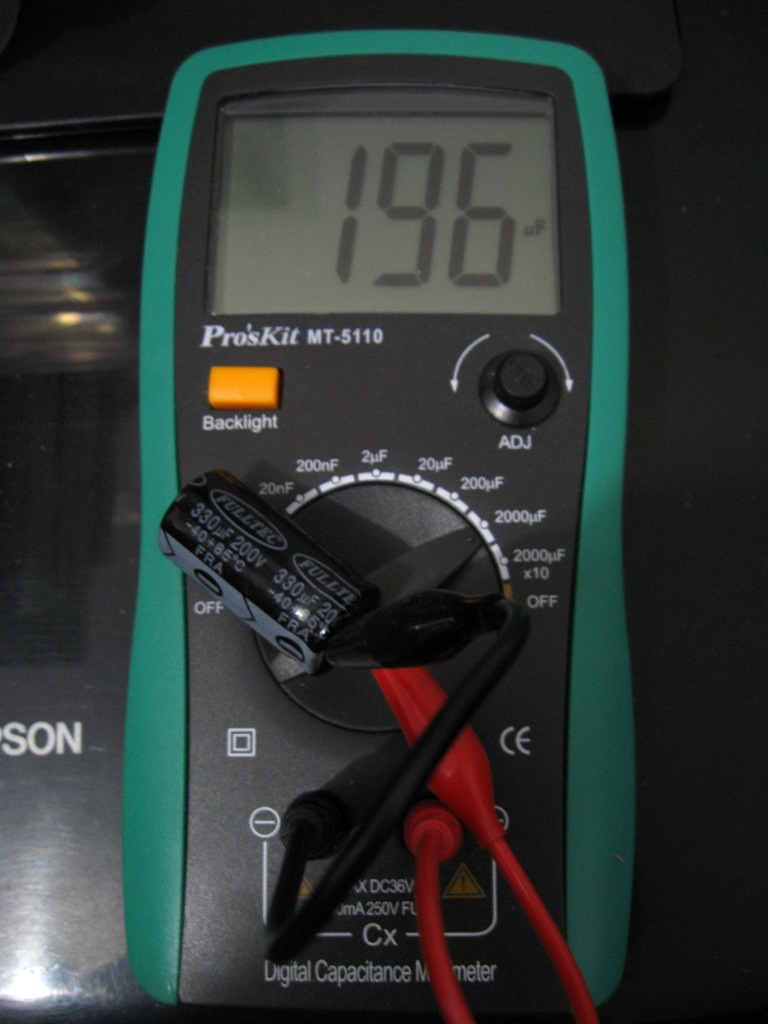

    Actually brand new capacitors very often will measure higher than its labeled value. Any electrolytic capacitor can have up to +/-20% tolerance. The capacitance value will decrease as it ages, subjected to too much heat or too much ripple current beyond its specifications. Usually if it measures way below its nominal 20% tolerance then its either aged a lot (getting too old) or already starting to fail (going bad).

        Did you mean that 220uF being measured as 240.8uF? That one sounds fine, as higher is better. Only worry if the capacitor's reading measures way lower than 220uF. Here's an example of highly aged dying/failing capacitor (see attached image below) pulled out of a computer PSU. Interestingly that one does not show any external signs at all (no bulging on either top or bottom, and no leaking brown gooey).
