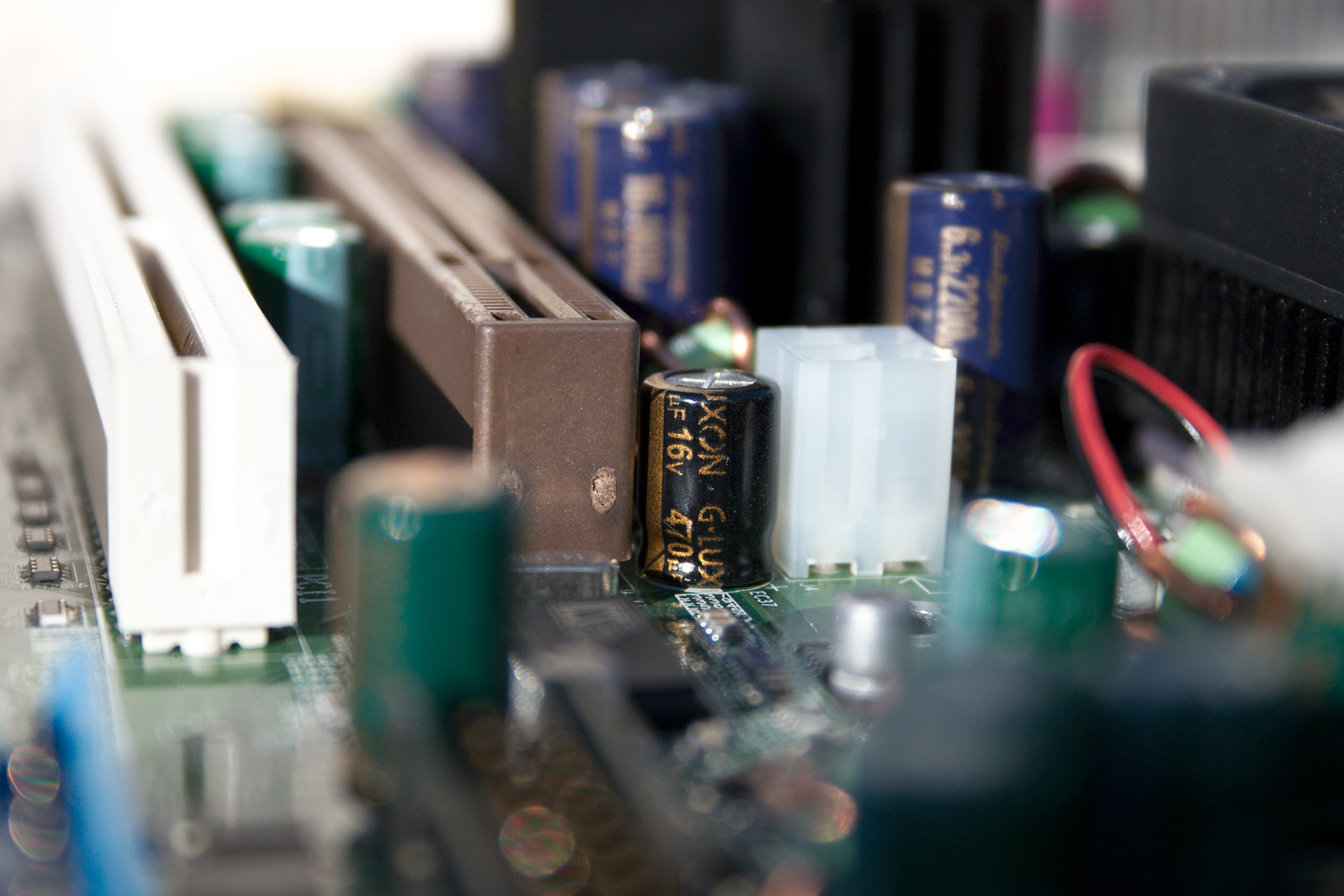

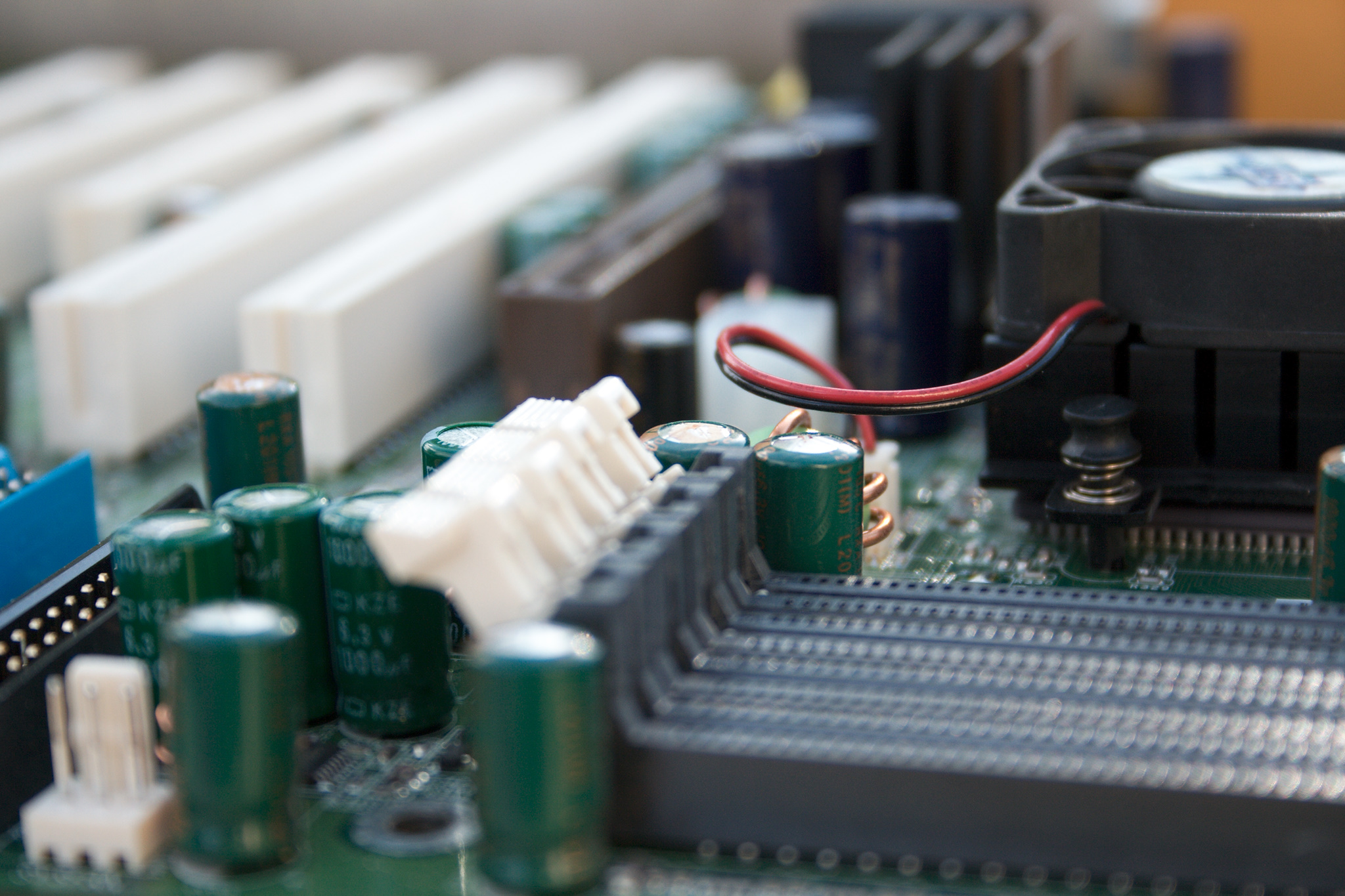

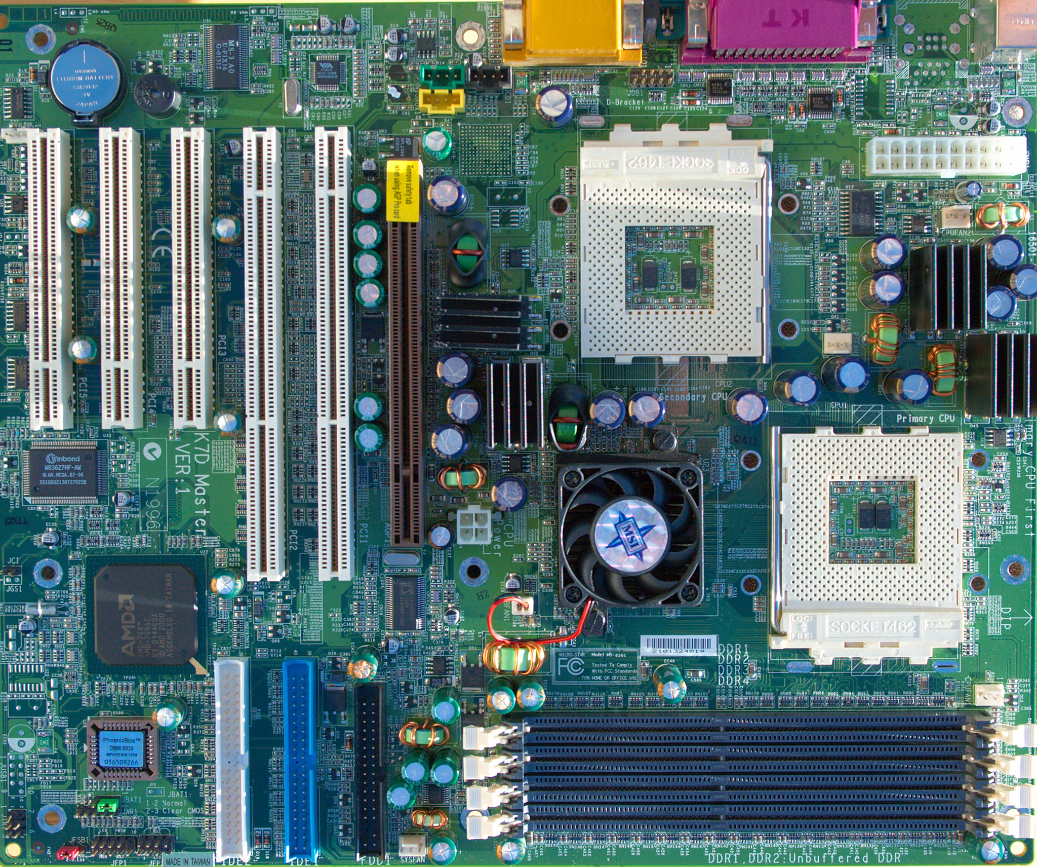

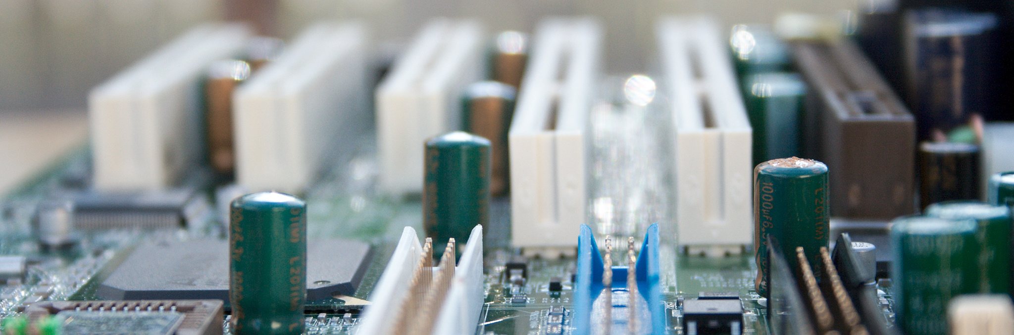

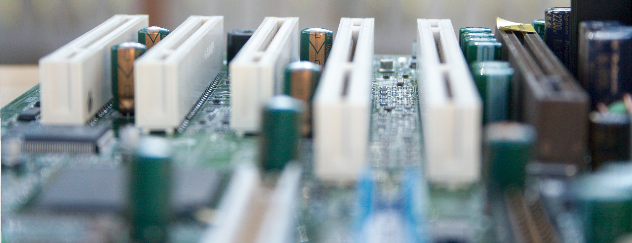

    Working on an:
    MSI K7D Master (MS6501)

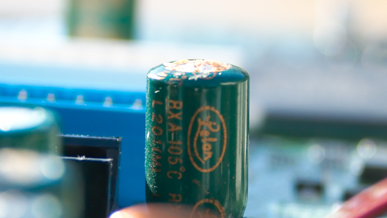

    This board blew all these caps within a few months of being put in service when it was new back in 2002. I ordered an exact replacement, swapped it out along /w the Enlight PSU for kicks and its replacement has been running fine ever since. This board (the original) has been in my shop closet the whole time. The currently in-service (replacement) board in the server is swelling some VRM caps & starting to develop stability problems. So I'm going to be fixing up this board and using it as a direct on-site hot swap.
    Caps are as follows.
    *See photos for really high res images, lots of good-res zoom capability.

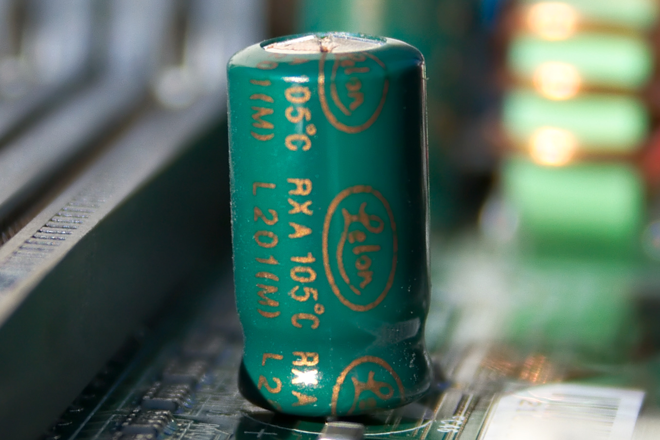

    16v 470uF (LX) - G.LUXON
    Dimensions DxL: 8x11mm
    Impedance*: 0.093 ohms
    Ripple*: 730 mA
    *nearest physical size @ rated uF
    Only shows these sizes at that value in spec sheet.
    8x15mm (1,000hrs 'down-size') & 10x12.5mm (2,000hrs)
    This one should be able to go up to 15mm in height, just like the Chemi-Cons.

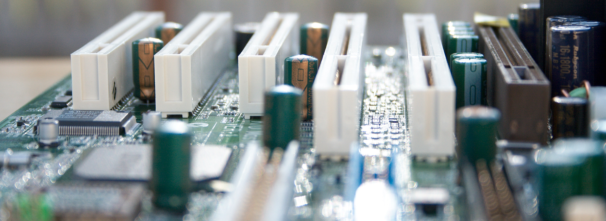

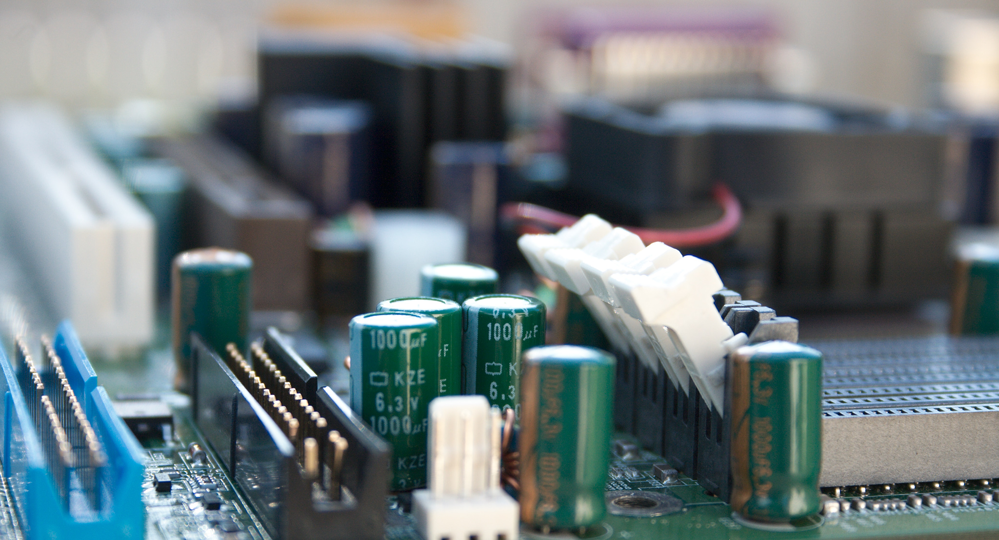

    The board manufacturer chose Lelon (RXA) caps to use in place of the following Chemi-Cons in some areas. These (Lelon) caps have vented and are the ones being replaced. They have the "same specs" as the Chemi-Cons.
    6.3v 1000uF (KZE) - Nippon Chemi-Con
    Dimensions DxL: 8x15mm
    Impedance*: 0.053 ohms
    Ripple*: 1030 mA
    Spec sheet shows larger size of: 10x12.5mm
    Stepping down to 820uF yields: 8x15mm
    Any larger diameter and it won't fit between the PCI slots.
    Any taller and the cap would be above the height of the slot and could interfere with on-card components.
    I wanted to just get all Nippon Chemi-Con's, as there are 11 of these on the board in perfect shape that correspond to the el'cheapo Lelon (RXA) caps they used that are all swollen and and/or vented+leaking.
    Looking at the specs for Nichicon - HZ/HN/HM, they show the 8x15mm size. Each series shows a respective impedance of: 0.014/0.020/0.028 Ohms. *Converted from milli-ohms.
    Ripple, respectively: 2210/1700/1490 mA
    That's quite a bit lower than the caps that I'm replacing. Considering the undamaged Chemi-Cons that'll remain behind in the same circuit(s).
    Is this a problem for either the ESR or the Ripple current?
    Why are these sizes at the rated capacitance not on the respective spec sheets, custom made perhaps?
    Lastly...
    Knowing that Rubycon's are a high quality cap.
    I'm assuming the Rubycon 6.3v 2200uF & 16v 1800uF (HMZ) capacitors aren't of a bad series/year and are safe to leave?
    Date Code: T0141/T0143/T0144
    That should be: Early Oct. 2001, Mid to late Oct. 2001, Late Oct. to early Nov. 2001.

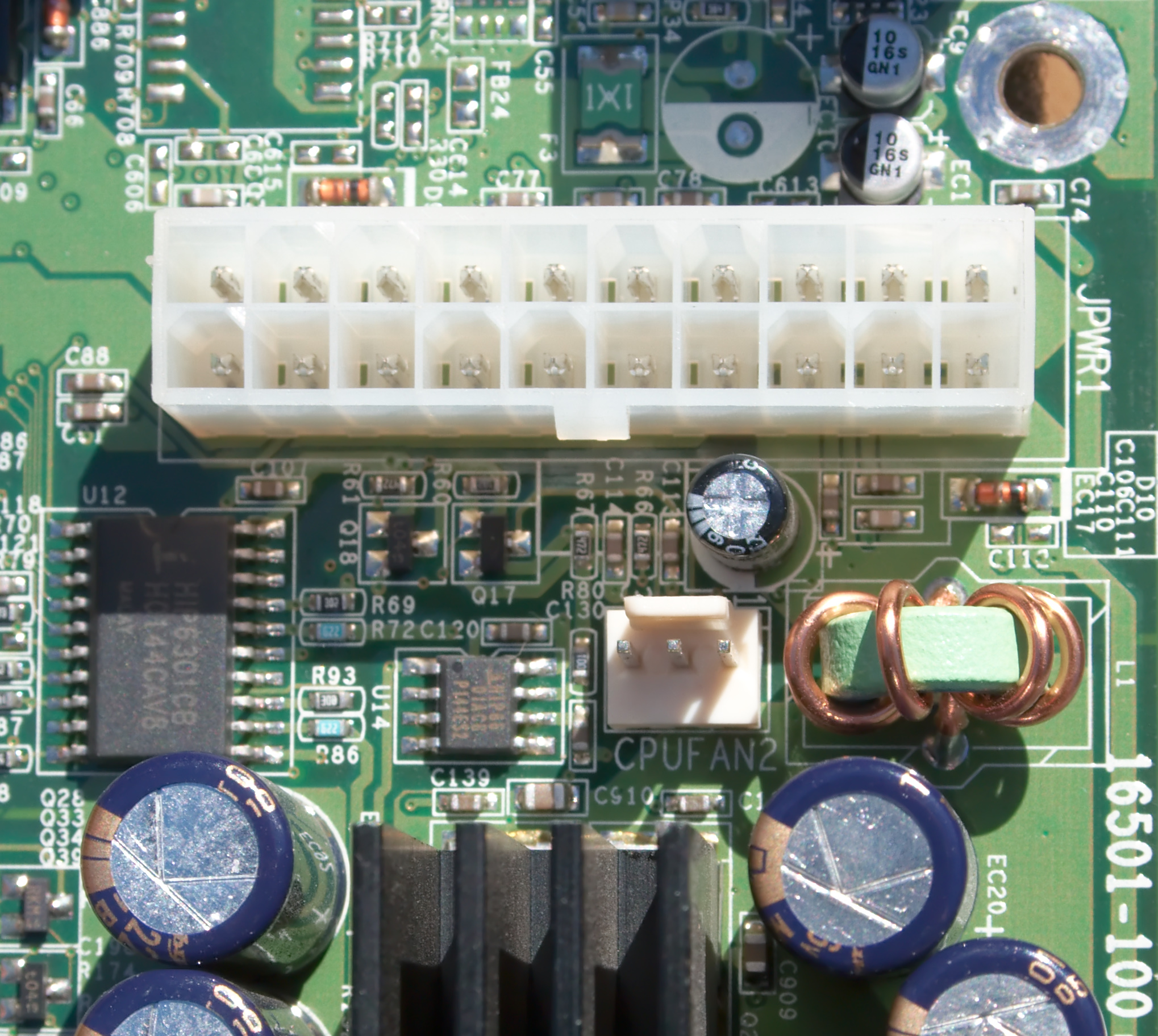

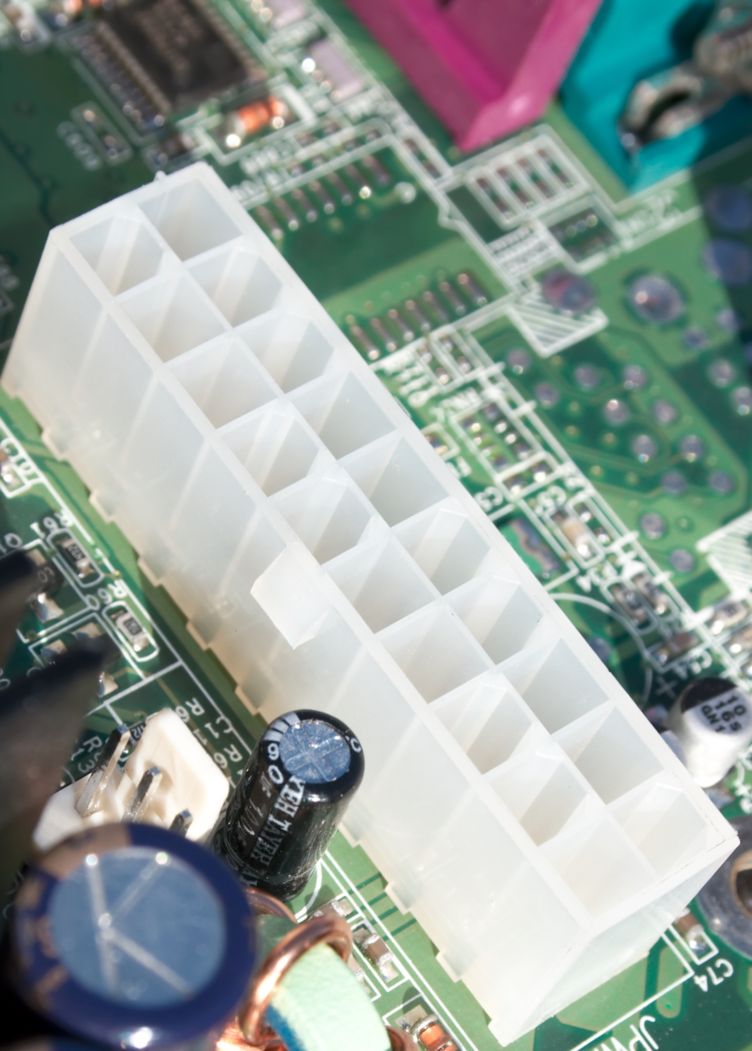

    Also, do I need to worry about the remaining sole X-brand cap placed between the 20-pin ATX conn. & the CPU fan header + choke?
    It reads as: TAYEH 16v 100uF (RB).
    *See attached photos for this cap's location & shot of cap brand marking.

      I would use Nichicon HD or HE. If you can't find HD or HE or HM is cheaper, HM would also work, though it's a bit too low on ESR.
      HM > HD > HE
      1000uF 10v Nichicon HE is close enough to 1000uF 6.3v KZE to not worry about it.
      I don't think those KZE have a problem, that's not a series with issues.
      The Lelons will have to go, but that's strange all those caps are swollen - I'd suspect the power supply was dying or sending voltage close to the 6.3v rating of the capacitors. I'd replace those with 10v rated capacitors just to be on the safe side, 8mm caps are easy to find for that rating.

        OK. If I did understand correct, you have TWO (exactly same) boards, one lasting ~10 years, and one you wish to fix...
        What I'll do, is - compare ALL capacitors on both boards, and use approximately the same on ALL places (including visually not damaged capacitors)...
        Differences on CPU-vrm circuit (if any) could say something more...
        You ran this boards on different PSU-s – that should be taken in account too (post both make and models).

            As an aside, if Lelon's quality was as good and aggressive as their sales people, they'd define "World Class".

              Re: Help verifying cross reference of Junk Caps &lt; Nichicon/Chemi-Con
              I checked out the HD & HE spec sheets. Neither one has an 8mm x 15mm cap. Neither in 6.3v, or 10v @ 1000uF. I could go 20mm in height, but that's quite a bit taller than the KZEs that are there next to them. I have had clearance issues in the past with add-on cards and the caps board makers have chosen to place next to the I/O exp. slots. Usually on lesser known boards that I'd see come in. So I don't want to make the same mistake.
              But I honestly don't know how "tall" the offenders really were, never got out the micrometer. LOL

                    About the small capacitor near the ATX connector, I don't think you need to replace it, but you are already recaping the board with quality caps so again if you think the board worth it then why not.

                      I'll probably just leave the little guy, the Tayeh. I can't even find datasheets on them, let alone any sign of the company. Other than the fact they made some caps and they're on some boards. That's about it.
                      Any idea what it does? I'm thinking it possibly smooths the output of the fan header voltage? Just a guess based on what's near it, nothing more.
                      For the 470uF, I presume you are referring to the lone Teapo next to the AGP slot?
                      That Panny should be fine for that. But I imagine there are many other replacement options as well.
                      I was mainly curious if I should just replace it, or leave it. If it performed a critical job, or if it was pretty minor. For that matter, if anyone even knew, or could tell from the photos.
                      Lastly, I just felt it was odd that it too, did not match the dimensions on the spec sheet.
